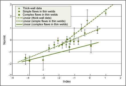

Finally, we confirm the linearity of the normit model by grouping each of the three data sets identified in Section 3.3 according to the theoretical index I theory and plotting an estimate of the normit function given by
, where
is the proportion of detections within each group. The resulting plot is shown in Figure 3.
Fig.3. Plots of estimated normit function against index of detectability
The error bars are based on estimates of the two-sided 80% confidence intervals for each data set. There are a total of 20 data points on this plot, so it is not surprising that four (20%) of the error bars fail to intersect the appropriate regression line. Overall, the plot confirms a broadly linear trend in the normit function for each data set. As expected, the two trend lines for the thin-wall data are approximately parallel, while the trend line for the thick-wall data clearly has a larger gradient.
Note that the regression lines plotted in Figure 3 are simply calculated by the method of least squares, and do not take into account the variation in the size of the error bars. They are included merely to assist our eyeball assessment of linearity.
