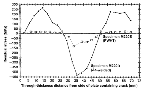

Post-weld heat treated joints
The effect of post weld heat treatment (PWHT) on the residual stress distribution in welded joints was investigated using pipeline butt welds. The distribution was evaluated numerically using the software package SYSWELD [8] . The parent material was assumed to have yield and ultimate strengths of 342MPa and 567 MPa, respectively, whilst the corresponding values for the weld metal were 511 MPa and 591 MPa. The pipe had a diameter of 1000 mm and a wall thickness of 30 mm. An asymmetric double vee weld geometry was simulated, with the first two passes deposited from the internal surface of the pipe and six subsequent passes from the outside. An axisymmetric two-dimensional finite element model was used with 702 elements and 2089 nodes.
SYSWELD simulates stress relief using a viscoplasticity model which can be used to represent the elasto-plastic isotropic work hardening response associated with materials during welding. Primary and secondary creep were modelled using a Norton-type creep law with coefficients relevant to time-dependent strain values for appropriate nominal static loads at 550°C. The following treatment was simulated:
  • temperature increase from 20°C to 550°C in 9 seconds
  • constant temperature of 550°C for 3 hours
  • controlled cooling to 20°C at a rate of 20°C/hour.
The predicted through-thickness residual stresses after PWHT were very low, with a maximum value of approximately 10% of the weld metal yield strength. These results are within the bounds of the PWHT residual stress levels recommended in BS 7910, i.e. 15% of the yield strength in the transverse direction and 30% of the yield strength in the longitudinal direction.

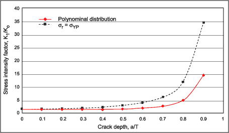

Residual stress intensity factors for longitudinal surface defect at plate butt weld
The stress intensity due to residual stress was calculated for infinite surface defects and for semi-elliptical surface defects of aspect ratio, 2 c/a, of 10 and 3.33. The through-thickness distribution of transverse residual stress acting on the longitudinal defect was the recommended SINTAP profile in which the normalised residual stress σ R T/ σ Y is expressed as a sixth order polynomial function of normalised depth from the surface, z/T. Additional cases were run assuming a uniform residual stress equal to the yield strength, σ Y . The stress intensities for infinite surface defects were calculated using the weight function solution given in the SINTAP stress intensity handbook [9] . Those for semi-elliptical defects were calculated using the closed form solution given in the handbook. This solution is applicable to a stress distribution expressed as a fifth order polynomial function of depth divided by crack depth, z/a. Hence it was necessary to fit a fifth order polynomial in z/T to the sixth order SINTAP profile (see Figure 1), and then for each crack depth, a/T, to transform the polynomial from a function of z/T to z/a.
Fig.1. Through-thickness transverse residual stress distribution in plate butt joint

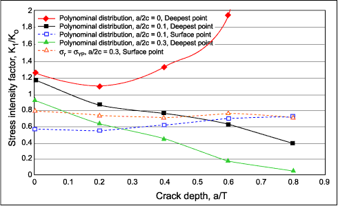

The SINTAP handbook solution for semi-elliptical defects includes a solution for infinite aspect ratio, i.e. an infinite surface defect (equation A1.1). Stress intensities for infinite surface defects were calculated using this solution and the infinite crack solution in the handbook (equation A1.3) and found to agree within 10% at a/T= 0 and 0.8, and within 1% at intermediate values. This was considered to provide confirmation of the self-consistency of the handbook solutions and to validate the implementation of the solutions in Mathcad and the use of the fitted fifth order polynomial for all but the extreme crack depths. The 10% discrepancy at zero crack depth can be attributed to the poor fit at zero depth (see Figure 1).
Calculated stress intensity factors, normalised with respect to K o = σ √( Πa), are plotted for infinite surface defects subject to the SINTAP polynomial profile and for residual stresses equal to the yield strength in Figure 2. The solutions are identical as crack depth tends to zero (where the residual stress equals yield in both cases), but the solution for uniform stress becomes increasingly conservative with crack depth. This demonstrates the benefits to be obtained using the SlNTAP profile, especially for deeper cracks. The solution for uniform stresses was also calculated using a closed form solution from Tada, Paris and Irwin [10] , which gave virtually identical results.

The stress intensity factor solutions for infinite surface defects subject to the SINTAP polynomial residual stress profile and for the deepest point and surface intersection point of semi-elliptical cracks of aspect ratios, 2c/a, of 10 and 3.33 are shown in Figure 3. The stress intensity rises for a/T > 0.2 for the infinite surface crack, but falls continuously with crack depth for the deepest point of the semi-elliptical cracks. The stress intensity is always positive, despite the fact that the residual stress is negative for crack depths between 0.5 and 0.8 of the plate thickness. The stress intensity at the surface intersection point is greater than that at the deepest point for a/T > 0.5 for a crack aspect ratio of 10, and for a/T > 0.1 for aspect ratio 3.33. Hence, fracture may initiate at or near the surface intersection, particularly for the crack of aspect ratio 3.33, for which the stress intensity at the surface point is greater than that for a crack of the same depth with an aspect ratio of 10.
Fig.3. Normalised residual stress intensity factors for deepest and surface points of surface defects in plate butt joint

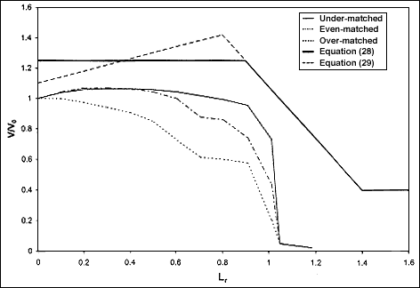

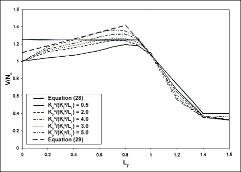

An alternative approach for the assessment of plasticity effects on the residual stress distribution has been proposed in SINTAP: a factor, V, is applied to K s to account for plasticity effects. K r is then defined thus:
(22)
Equations relating V and ρ have been developed using previously calculated numerical values of ρ to generate values of V/V o as a function of increasing load for a number of values of secondary stress, where

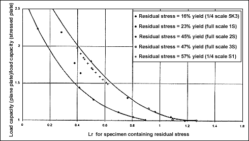

The effects of residual stress on load carrying capacity with varying L r are presented in Figure 7. The aluminium alloy specimens demonstrated the large influence of residual stresses on the load carring capacity in the low L r region. The effect of residual stresses was found to decrease as L r increased and had no effect at L r and beyond, i.e. the elastic residual stress is dissipated at nett section yield. These results were confirmed by the second series of tests. The tests at low L r showed that the load carrying capacity of the as-welded specimens was approximately 60% of that of the post weld heat treated specimens. The high L r tests showed that the load carrying capacity was reduced in the as-welded specimen by approximately 5%.
Fig.7. Load carrying capacity ratio v. L r for aluminium test specimens
Both sets of test results are plotted against the R6 Option 1 failure assessment diagram (FAD) in Figure 8. The figure shows that, in general, conservative predictions were obtained for the aluminium alloy specimens. A small number of points fall below the curve and this was attributed to uncertainties in the experimental determination of the initiation event.
Fig.8. Comparison of aluminium residual stress test results with R6 Option 1 FAD

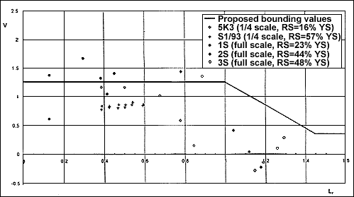

Two methods were used to evaluate V:
(a) from equation (22)
(30)
(b) from ρ: by combining equations (21) and (22),
(31)

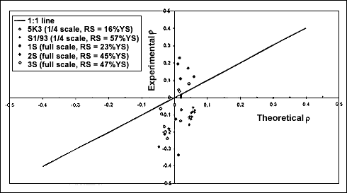

ρ was evaluated from equation (25) with K p s determined by the simplified linear elastic calculation method defined in Appendix 4 of R6 [4] . For the validation exercise, it was conisdered appropriate to set V o to a value of 1, resulting in ρ being equal to Ψ (see equation (26)). Values of Ψ were calculated using Table A4.1 in Appendix 4 of R6. These theoretical values of ρ were compared with the corresponding experimental ρ values calculated from equation (21).
K r was evaluated from equation (21) with L r defined by the R6 Option 1 FAD. K mat was evaluated from specimens which did not contain residual stresses, effectively using the R6 Option 1 FAD as a J-estimation scheme. The loads corresponding to initiation of tearing and subsequent amounts of crack growth for each specimen were converted to an L r value from which K r could be calculated, using the R6 Option 1 FAD. K mat was then calculated from the relationship
(32)
Values of V from equation (30) are compared with equations (28) in Figure 9. The majority of results lie below the proposed curves and suggest that the proposed formulations for V are acceptable. The results are consistent with the discrepancies between theoretical and experimental values of ρ which are shown in Figure 10.
Fig.9. Experimentally determined V v. L r
Fig.10. Experimental ρ v. theoretical ρ

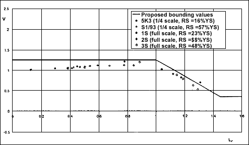

Values of V from equation (31) are compared with equations (28) in Figure 11. Except for one point, all the points lie just below the proposed formulations and the results indicate that the proposed formulations for V are appropriate.
Fig.11. V (from equation (31)) v. L r
It was concluded that the proposed formulations for V are generally acceptable as an upper bound which is independent of the magnitude of K l s . Figure 11 confirms that, since ρ and V are determined from the same basis, expressing them as a multiple of rather than an additional term to ( K l s/K mat ) makes them only weakly dependent on ( K l s/K mat ).
