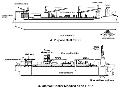

Nevertheless, FFCP can be applied in the earlier stages of construction of purpose built FPSOs, or new build tanker intercepted to become a FPSO, in order to mitigate the risk of catastrophic failure due to fatigue cracking in the hull and to ensure that a more reliable in-service inspection programme (ISIP) is applied to critical components during the design life of the system. The use of a FFCP for an existing tanker to be converted to a FPSO can be established provided sufficient data can be retrieved from the vessel construction records or additional testing is conducted where data are lacking. It is also important that additional inspection on critical components of the structure is undertaken during the modification stage. In order to apply such methodology a robust testing and analytical programme have to be undertaken which would help in the selection of the appropriate materials, welding process, fatigue improvement techniques and inspection methods to be applied throughout the design life of the system.
Hull integrity
To guarantee the hull integrity of a FPSO a fatigue and fracture control programme (FFCP) should be developed to mitigate the risk of brittle fracture in the hull components. During the construction of purpose-built FPSOs or new-build converted tanker the quality of the hull structure must be of a standard to ensure the vessel can remain on station during the life of the field with the minimum of repairs to critical areas of the hull structure. Examples of the hull shape of a purpose built FPSO and an intercept FPSO, illustrated in Figure 1, demonstrate the unique hull shape of the respective vessels.
Fig. 1. Purpose-built FPSO and intercept tanker modified as an FPSO

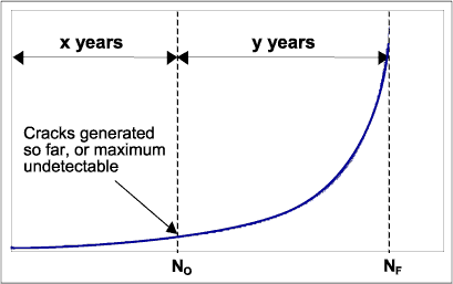

Based on fracture mechanics theory a fatigue and fracture control programme (FFCP) would take into account the fatigue crack growth of a certain flaw whilst determining the tolerable flaw sizes for specific critical components of the hull. The aim of a FFCP is, therefore, to carry out engineering critical analysis (ECA) of weldments and identify the most fatigue-critical details, which would require more frequent in-service inspection.
The ECA, which is based on methods of assessment of welded structures, such as the BS7910 [1] , uses fracture mechanics fatigue assessment based on the integration of the relationship between crack growth rate (da/dN) and the stress intensity range ( ΔK), defined by the Paris law in Eq 1:
da/dN = A( ΔK) m
(1)
For the estimation of the remaining life of the component, a realistic initial flaw size would have to be estimated, e.g., tolerable undercut dimension, and the Paris law constants (A and m) applied in accordance with the environment surrounding the component (e.g. seawater, air, etc.). The load spectrum to be applied also needs to be defined in order to calculate the increment of crack growth per stress range block of n i cycles. For this purpose, the results of a short term and long term prediction of stresses applied on the hull, derived from ship motion 3D finite element analysis, would be required. Also, definition of the stress ranges that the component is subjected to during service such as nominal stresses and hot spot stresses. To mitigate the effect of fatigue loading several stress range blocks for different loading conditions expected during service can be applied during the analysis. In the absence of detailed stress ranges the most critical load cases could be used as reference, which would give a conservative estimation of the criticality of the component. The relative criticality of the component could then be estimated as the ratio of the residual to designed life.
It is also anticipated that different geometries and weldments will produce different ranges of tolerable flaws. Therefore, the ECA will help in identifying these regions, hence mapping the critical components with their specific requirements and limitations. The results of this analysis will be used as input data for the FFCP and the ISIP, which will monitor the system throughout its designed life.
Another output of the FFCP, if carried out during the design stage, would be the identification of areas where design changes need to be made to guarantee the expected performance of the structure during the design life (e.g., bracket, longitudinal and transverse girder joints, etc.). This early stage investigation would allow designers to avoid critical geometric profiles that could potentially increase the fatigue crack growth rates of a flaw in the component due to stress or strain concentrations, therefore optimising the maintenance schedule of the structure.

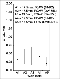

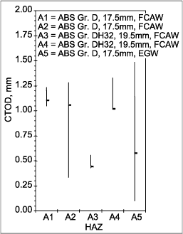

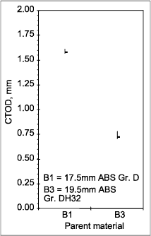

 Fig. 3. Summary of results of CTOD tests performed at -10°C, for three weldment regions investigated. The horizontal bar indicates the second lowest CTOD test results for a set of six tests, i.e. δ mat a)
b)
b)
c)
c)
The scatter of results within the non-homogeneous HAZs and weld metals is immediately apparent in Fig.3 (compared to the relative lack of scatter found in the homogeneous parent material). The δ mat values for all weld regions are above 0.10 mm. The highest δ mat values were measured in the parent materials (i.e. δ mat > 0.50 mm) and both parent materials exhibited fully plastic behaviour. The weld metals have the lowest measured δ mat and exhibited a combination of fully plastic behaviour and brittle crack extension.
The fracture events of the weld HAZs were fully plastic, except for a few results from the HAZ regions of panels A2 Flux Cored Arc Welding (FCAW) and A5 Electro Gas Welding (EGW). The δ mat results of each weldment region also tend towards the bottom of their respective ranges, except for the HAZ δ mat of panels A2 (FCAW) and A5 (EGW).

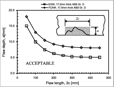

Additionally, estimations of the maximum tolerable flaw size were made according to BS7910 [1] and using the software CRACKWISE 3. The results of the analyses were plotted as a locus of maximum tolerable flaw sizes, as shown in Fig.4, for the FCAW and EGW welds. The results for the FCAW and EGW welds means that a surface-breaking flaw of dimensions a x 2c that falls above the respective failure locus would be unacceptable. Figure 5 shows the predicted crack depth plotted against the number of cycles during the fatigue crack growth. Cracks found during in-service inspection can be checked against the tolerable flaw size locus ( Fig.4) and, if found to be in the region of tolerable flaw sizes, additional estimation of the fatigue crack growth can determine the remaining time for total failure ( Fig.5). Therefore, the estimated remaining time to total failure will define the next inspection interval according to the operator ISIP.
Fig. 4. Idealised failure loci for tolerable surface-breaking flaws for specific EGW and FCAW weldments

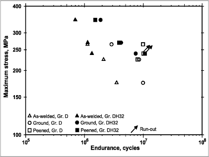

In a complex welded structure such as an FPSO, fatigue life is governed by the performance of welded details with poor fatigue strength, e.g. brackets between longitudinal hull stiffeners and transverse webs (frames). The performance of these details can be explained in terms of the overall geometric stress concentration at the joint, surface profile or shape of the weld, the presence of microscopic crack-like discontinuities at the weld toes and the development of welding residual stresses, ordinarily of yield strength magnitude.
To deal with these stress enhancing factors, and to achieve increased fatigue life for some structural details on the FPSO, fatigue life improvement techniques have been investigated, i.e. weld toe grinding and weld toe needle peening. Fatigue testing were conducted in air at ambient temperature, under uni-axial amplitude loading, and at frequencies of 4 to 8 Hz. The specimens were loaded until complete separation was achieved. The load spectrum applied to the fatigue tests was a simplified wave action standard history (WASH-W) [Ref.10] , i.e. excluding loading frequency and calmer sea-states 1 to 3. In order to avoid buckling of the fatigue specimens large compressive loads were also discarded. To compensate for the latter, additional compressive loads were added to the spectrum at 1,000 cycle intervals. This modification is partly conservative since the repetition of compressive loads introduced in this way should exceed the occurrence of compressive overloads under service loading conditions.
The results of the fatigue testing are shown in Fig.6. The results show that there is no significant difference between the fatigue lives of the two techniques investigated. Therefore, the operator could choose the most suitable technique based on practical considerations (e.g., speed of application, cost, quality control, etc.)
Fig. 6. Fatigue improvement technique test results for as welded, ground and peened conditions of steel grades D and DH32 respectively
