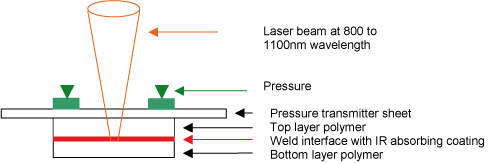

Fig.1. Schematic drawing of the transmission laser welding process using IR absorbing coating

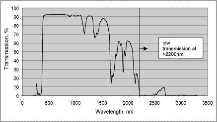

When considering the imaging methods available, it is first important to consider the radiation transmission properties of polymers in general and how this might affect the performance of the monitoring method.
PMMA is transparent at visible and near infrared wavelengths, but absorbs in the infrared region beyond 2200nm as shown in Fig.2. In general, the transmission properties of other transparent polymers in the visible and near-infrared are similar to PMMA. This limits the operating wavelength for any imaging system that needs to see through to the weld interface.

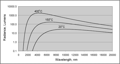

Thermographic techniques remotely measure the radiation emitted from a hot surface by virtue of its temperature. The temperature of the surface can be calculated from the spectrum and intensity of the radiation emitted. The strength of the signal available is the product of the spectral radiance and the material's emissivity at a given wavelength. Emissivity values range from 1.0 for lampblack down to 0.02 for polished silver. Thermography is used effectively for monitoring laser welding where carbon black is used as the absorber. Use of the method presents difficulties if the emissivity of the heated region is low.
The relationship between radiance and the spectral radiation wavelength (cm), λ, at a given temperature (Kelvin), T, is given by Planck's equation [1], plotted in Fig.3. The Planck equation for spectral radiance describes the thermal emission from an ideal blackbody cavity of any material [6] , with an infinitesimally small aperture and in an absolute isothermal condition.
[1]
[1]
The wavelengths at which infrared thermometers are sensitive defines the range of temperatures that can be measured. Figure 3 indicates that to make measurements of thermal radiance in the melting range of plastics (150-400°C), it is necessary to monitor at wavelengths longer than approximately 1800nm where the radiance is at measurable levels (>0.1 lumens). If the materials being measured have low emissivity, then a longer measurement wavelength would be preferred to make use of the more intense region of the spectrum.
Fig.3. Relationship between spectral radiance from a black body emitter to the temperature of the emitter and the wavelength of the radiation
For transmission laser welding, Table 1 indicates that a short wavelength thermographic system is required to measure the weld interface temperature. Combining the information from Figs.2 and 3 it is concluded that it is preferable to monitor at infrared wavelengths shorter than 2200nm, where the PMMA transmission is greatest, and at wavelengths longer than 1800nm to read

The generic configuration of the welding set up is shown in Fig.1. A computer-controlled Laserline diode laser was used for the experimental work, delivering up to 150W at 940nm wavelength. The beam was directed onto the specimens through a pressure transmitting sheet of PMMA, and then through the upper material being welded to the joint interface. Clamping was applied via a pneumatic shoe onto the PMMA sheet Specimens were cut from 3mm thick, transparent or coloured cast sheet of PMMA or polycarbonate. An infrared absorber [9] was deposited using a needle dispenser at the interface between the upper and lower layers of the sample to be welded in the lap configuration The laser beam is absorbed by the coating, which generates heat at the joint to melt and weld the substrates. Four monitoring methods were applied before, during or after welding.

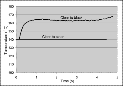

Infrared thermography
The infrared camera, working at 8000-14000nm, measured the temperature at 28°C at laser welding settings that were shown to melt a layer of PEEK film (melting point of 343°C). Essentially, the temperature reading was that of the top surface of the PMMA cover sheet, well away from the heated zone.
The infrared imaging system working at 2150-2650nm gave a reading of approximately 165°C when carbon black was used as an absorber for the laser source. When infrared absorbing coating was used there was no indication of the weld temperature for clear to clear substrate welding (see Fig.5).
More recent results have shown that it is possible to take temperature measurements from welds made with infrared absorber when sensors of other wavelength ranges are used.
Fig.5. Results of infrared thermography of welds made in polycarbonate to compare welding of clear-clear samples with clear-black samples. The minimum temperature reading for the equipment was 140°C, so the clear-clear sample did not provide a reliable reading

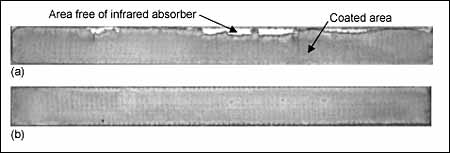

Infrared imaging
Images of the infrared absorber coated samples, taken prior to welding ( Fig.6) clearly show variation in coating deposits on the surfaces to be welded. When welded, the samples with good coating coverage had higher weld strengths.
Fig.6. Infrared images of weld face areas for polycarbonate samples made after coating and before welding, indicating variations in coating concentration a) poor deposit b) good deposit

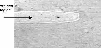

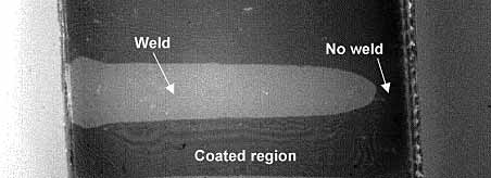

Near infrared imaging was also used to verify that a weld had been produced. Figure 7 shows an image with deliberate welded and unwelded areas. As shown, the image processing software can detect the difference in grey values between welded and unwelded sections.
Fig.7. Near infrared image of weld in polycarbonate showing welded and unwelded regions

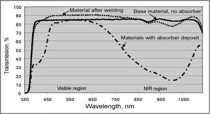

Spectrophotometer measurements
The spectrophotometer was used to compare the transmission of substrates, substrates plus infrared absorber prior to welding and the substrates after welding ( Fig.8). As shown, prior to coating, the substrate shows transmission of approximately 85% in the visible and near infrared range. After coating the IR absorber, a clear reduction in transmission is detected in the near infrared range due to the presence of the infrared absorber. After welding the near infrared absorption has almost disappeared and the transmission in the visible region has increased to 90%. The transmission increase in the visible region as a result of the formation of a weld between the two surfaces, and therefore the disappearance of two reflecting surfaces, is apparent. The increase would also be apparent in the IR region, but is masked by the absorber.
