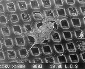

Excimer laser ablation enables the precise removal of material by breaking down the chemical bonds of the polymer and expulsion of molecules from the surface. The biocompatibility of such surfaces has been examined with goodindication of cellular activity, Fig.3
Fig. 3. Cellular response on an excimer micromachining polycarbonate surface

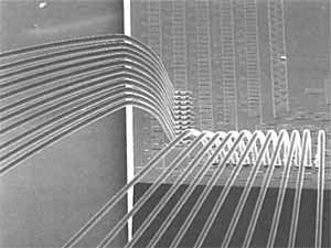

Various connection methods exist for fine scale connection, with the main stay still being wire bonding. Wires down to 10µm diameter can be bonded, although the minimum used for volume applications is typically at 40-50µm,Fig.4.
Fig. 4. High dennsity wire bonding

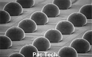

Flip chip bonding involves the use of perimeter or area array of very short, micro metallic or polymer bump connections, Fig.5, between a device that is inverted in a flip chip configuration over a mirror image pad array on a substrate. Flip chip die accounted for some 5% of the 60 billion Inegrated Circuit (IC) devices produced each year worldwide in 2002, and is predicted to climb to 10% by 2005. The vast majority of applications lie in electronics, photonics and sensors where high interconnection densities are needed, but medical applications include hearing aids, pacemkers, defibtillators, DNA analysers and smart pills. The main drivers for using this technology in this case are volume and size.
Fig. 5. Solder bump connections on device prior to flip chip bonding
