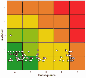

Initial risk ranking
The study began with a review of all potential damage corrosion mechanisms for the pipelines. This produced a list of credible internal mechanisms including microbial corrosion, oxygen induced corrosion and CO 2 corrosion.
Firstly, a risk-ranking was produced using qualitative likelihood and consequence ratings in order to establish assessment priorities. Likelihood was based on factors such as process fluid corrosivity while consequence was assessed on the basis of the production criticality of the pipeline. This allowed very low risk pipelines to be eliminated from further consideration. Figure 1 shows a typical likelihood and consequence matrix from an initial risk ranking exercise.
A semi-quantitative assessment was carried out using TWI's RISKWISE TM assessment procedure for pipelines. This involved an estimation of the pipeline remaining life based on failure likelihood factors which were centered on current condition, likelihood of failure within specified forward time frames (e.g. 5, 10 and 15 years) and effectiveness of any inspections. These factors are used within the RISKWISE TM software to determine remaining life indicators (RLI). RLI is analogous to a remaining life estimate but it is termed an indicator because it is only intended to give a measure of the remaining life based on the change in the failure likelihood over time. Input data used in the RLI calculation are worst-case parameter estimates such that the RLI under-estimates remaining life compared to the more quantitative probabilistic method. In the case study described, pipelines with RLI of less than 5 years were selected as critical lines for the more detailed probabilistic assessment.
Fig. 1. Estimates of risk

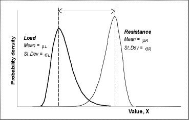

In general, failure probability methods use a number of techniques to estimate the probability of having combinations of uncertain variables that result in the occurrence of a failure event. Most practical problems can be thought of in terms of the interaction between a distribution of load effects and the resistance distribution as illustrated in Fig.2. In simple terms, all the analysis methods seek to establish the degree of overlap between the distributions. This depends essentially on the separation between the means of the distributions and the spread in each distribution. The area of overlap, and hence failure probability (P f), decreases with increasing separation between µ R and µ L while P f increases with increasing spread ( σ R or σ L) in either distribution.
In these analyses, probability distributions are used in preference to absolute values because the loading effects and resistance factors are subject to uncertainties that result from several sources. For example, for pipelines subject to internal pressure, uncertainties may arise from variability in material strength, pipe wall thickness and other geometrical properties, and fluctuations in internal pressure.
The discussion above involving two variables can easily be extended to cases involving several variables. For instance, a general expression for the failure condition or limit state may be stated as:

Fig. 2. Illustration of failure probability analysis concept using the interaction between loading and resistance effects

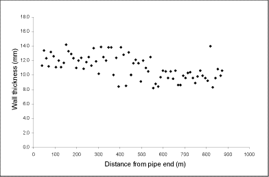

Corrosion rate extrapolation for pipeline length
The method of extrapolation based on sample inspection has been used previously by a number of investigators. [7,8] The technique has been more comprehensively developed in a recent TWI work [9] in which several aspects of the methodology were investigated. In the present study, the maximum corrosion depths for approximately the same unit lengths of pipeline were fitted to an extreme value distribution using commercial statistical software. This gave a Type I extreme value distribution of maximum rates, which has the form:
[10]
[10]
where F A(a) is the probability of the corrosion rate A having a value less than 'a', µ is referred to as the location parameter and α is the scale parameter. In simple terms, the location parameter is the most likely corrosion rate and the scale parameter represents the extent of scatter of rates about the location parameter and therefore controls the shape of the distribution.
Extrapolation of the basic distribution to allow for potentially higher corrosion rates in uninspected regions of the lines is done by shifting the location parameter to a higher value. The location parameter of the shifted distribution is given by:
[11]
[11]
where µ and α are the parameters of the basic distribution and N is the ratio of total pipeline length to the unit length from which worst data was extracted to derive the basic distribution. The above equation follows from extreme value theory and is quoted in several standard texts (e.g. see Ref [1] ). The extrapolation of Eq.[11] is based on two fundamental assumptions: firstly, that the uninspected region is nominally similar to the region sampled and secondly, that the unit sections considered in extracting maxima are independent or at least that correlation is negligible. Therefore, the unit length of pipeline used was selected based on previous experience [9] to ensure independence. The other requirement of the sample being representative of the uninspected pipeline regions was particularly important in the present study as inspections were mostly limited to pipeline ends. However, a limited number of checks showed that variability in wall thickness loss stabilised within the typical 500m end lengths covered by the inspections. For example, see plot of wall thickness versus distance from line end in Fig.3.
Fig. 3. Typical wall thickness variation with distance from pipe end

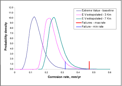

A typical example of the basic extreme value distribution and the corresponding extrapolations for different pipeline lengths are shown in Fig.4. The effect of extrapolation is clearly seen as the entire distribution is shifted to higher corrosion rates. It should be noted that the shift is logarithmic with pipe length.
Validation against failure data
Leaks had been reported for a few of the water injection lines assessed in this exercise. The corrosion rates implied by these leaks were compared against the corrosion rate distributions obtained for the failed lines. These checks provided some validation for the procedure for determining corrosion rate distributions, as the rate implied by the leaks fell in the upper tail region of the distributions (e.g. see Fig.4). The two rates shown in Fig.4 are the minimum and maximum values from several failures. It is also noted from Fig.4 that the rates implied by the failures would be much less credible if basic corrosion rate distributions were not extrapolated for the length of the lines.
Fig. 4. Extrapolation of corrosion rate distribution and comparison with rates implied by failures (full pipeline length 7Km)

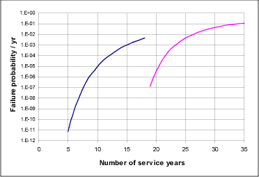

The results of the assessment are presented in the form of plots of annual failure probability against time. A typical plot is shown in Fig.5. The plot shows an initial assessment and an updated assessment following inspection of the individual pipeline. Updating is further discussed within the section describing the sensitivity study in this paper. For a plot such as that shown in Fig.5 to be used in determining a remaining life, a cut-off failure probability for the end of useful life has to be defined. This is often referred to as the target failure probability.
Fig. 5.Annual failure probability - time plot and updating with inspection data

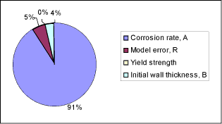

The sensitivity of the results of a probabilistic analysis to the various input parameters were evaluated by examining the so-called sensitivity factors produced from a FORM or SORM analysis. Figure 6 shows, in a pie chart, the sensitivity of results to input data for a typical water injection line. This shows clearly that corrosion rate is by far the most influential variable. Initial wall thickness and the burst failure prediction error, R, also have some effect. Of these variables, there is reasonable confidence in the estimates of initial wall thickness and on the prediction error R, while the appropriateness of the assumed corrosion rate distribution for individual pipelines is less certain particularly where such lines had not been inspected. The effect of inspection on corrosion rate distributions and consequently on predicted remaining life was explored through further sensitivity analyses.
Fig. 6. Sensitivity of analyses results to input vari ables for a typical water injection line
Firstly, it was noted that the limit state Eq.[8] employed in the probabilistic model simply accumulates the metal loss from start of life and predicts failure when this is sufficient to cause a leak or rupture. If there is a high degree of uncertainty regarding the corrosion rate distribution, then the amount of metal loss assumed by the model after a given service period may be in significant error. Therefore for lines with in-service inspection, a second set of analyses was conducted utilising a different limit state equation based on the actual measured wall thickness distribution at the time of inspection. The time frame for this second analysis starts from the inspection date and essentially corrects the extent of metal loss assumed in the model to that observed from inspection. Figure 5shows failure probability plots for an initial assessment and the corresponding modified plot after updating with thickness measurements for the specific pipeline. The drop in failure probability estimate at the inspection time is a measure of the correction due to the availability of the inspection data on the individual pipeline. Due to the conservatism in the general analysis prior to updating for individual pipelines, the remaining life estimates in all cases considered increased as a result of the updating. The results of initial and updated analysis for 5 pipelines are given in Table 3, which show improvements in remnant life estimates of between 6 and 13 years.
