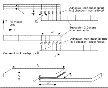

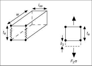

The LSB model uses a force-displacement relationship to describe the material properties of the adhesive, implemented using spring elements in a finite element (FE) model. A schematic diagram of the 2-D FE model is shown in Fig.1, with the spring elements used for the shear and normal forces shown separately for clarity, although they were used simultaneously in the model. The tensile springs undergo the deformations shown in Fig.2. These deformations can be used to develop the relationship shown in Eqn.1 and 2, linking the adhesive's stress-strain response with the geometry of the model and the required force-displacement input data for the spring elements in the LSB FE model:
F 2 = σ.w.l ss and δ 2 = ε n.t a (1 & 2)
where, F 2 is the force, δ 2 is the displacement, w is the sample width, l ss is the spacing of the spring elements, t a is the adhesive layer thickness, σ and ε n are the tensile stress and strain respectively. A similar relationship was developed for the shear springs.
Fig. 1. Schematic diagrams of finite element model for single lap-shear joints
Fig. 2. Diagram of relationship between geometry, stress-strain and force-displacement for normal spring elements

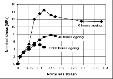

The approach to modelling the joint life-time is based on the changes that occur to the mechanical properties of the adhesive due to the ageing process. Samples of the two-part acrylic (Quickbond 5002) and one-part epoxy (ESP4582) adhesives were hot-wet aged at 40°C and 95% relative humidity (RH) and tested in tension. Fig.3 shows the effect of ageing on the tensile properties of the acrylic adhesive. After 3300 hours of ageing, there were significant reductions in strength, modulus and failure strain for the acrylic adhesive. The epoxy's failure stress (50MPa) was reduced by 25% and the failure strain (1.5%) by 33%.
Fig. 3. Tensile response for acrylic adhesive aged for various times at 40°C and 95% relative humidity

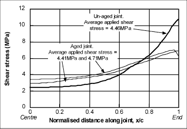

Results from the LSB FE model for PMMA-acrylic joints are given in Fig.4, which shows the predicted shear stress distribution in unaged and aged joints, at similar values of average applied shear stress. There is a marked change in the shear stress distribution due to the effects of hot-wet ageing, with reductions in the peak stresses at the ends of the joint overlap. Similar results were recorded for the normal stress distributions and for aluminium-acrylic or epoxy joints.
Fig. 4. Shear stress distributions from LSB FE model of unaged and aged PMMA-acrylic single lap-shear joints

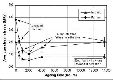

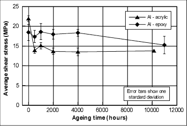

The average shear failure stresses at each ageing time were measured and the average values from three joints are shown in Fig.5 and 6.
Fig. 5. Average shear stresses at damage initiation and final failure versus ageing time for PMMA-acrylic lap-shear joints
Fig. 6. Average shear failure stress versus ageing time for Al5251-acrylic and Al5251-epoxy lap-shear joints
Reductions in joint final failure strengths were seen for all three joint types. For the PMMA-acrylic joints a video imaging technique was developed allowing the initiation of damage within the joint to be observed and related to the applied load [4]. Damage initiation occurs at around 50% of the final failure stress. All aged joints showed cohesive failure in the adhesive, near to the interface, with no evidence of adhesion or interfacial type failure.
