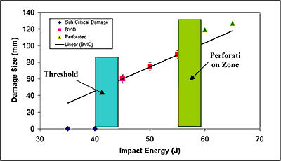

Impact damage was introduced to the Q-ID specimen using the Rosand Instrumented Falling Weight Impact Tester (IFWIT). Energy of impact was controlled by changing the height of the drop weight (potential to kinetic energy). The specimen was rigidly supported on a rectangular window of 100 mm x 110 mm; the impactor head was 20 mm in diameter and weighs 4.72 kg. After several trials 3 mm thick neoprene padding was placed over the impact point to prevent surface damage; the neoprene would have absorbed some of the impacting energy and hence the imparted energy was less than that calculated. Since the aim was to study the characteristics of the impact damage rather than the conditions and mechanisms by which it took place, this discrepancy is not expected to be an issue.

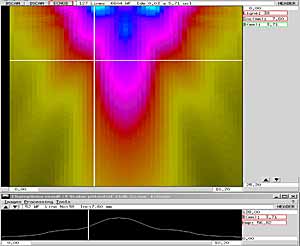

CIVA [4] and Quicksonic [5] modelling software are used to theoretically check the integrity of the incident PA sound field and remove unexpected grating lobes. An example of using CIVA is given in Figure 2 for the probe used in collecting the data presented in this paper (7 MHz, 16 element aperture, 0.6 mm pitch).

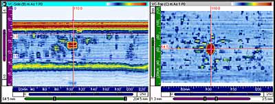

Figure 3 shows a scan of the N1-D specimen. It shows the presence of the artificial delamination and the presence of through thickness gross porosity. The PA system is able to impose the -6 dB sizing criterion for both the delamination and the porosity regions automatically. The through thickness positions can also be evaluated accurately.

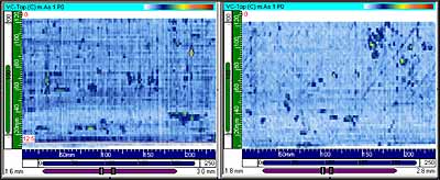

A study of the morphology of porosity in three different lay-ups shows that the weave of the material plays an important role in the degree of damage. Figure 4 shows C-scans of N2-D and N3-D that are of cross-ply and quasi-isotropic lay-up, respectively. All the panels have flawed cure cycle induced porosity. Three equal volumes of ultrasonic data are extracted for the three lay-up specimens of 1.4 x 180 x 100 mm 3 .
The maximum echo amplitude within this volume above 20% of the front wall echo was plotted on a two-dimensional map; hence the area of the total cross-section covered by porosity is evaluated by image thresholding ( Figure 5). The total volume of porous region is greatest in the cross-ply panel then the quasi-isotropic and least in the unidirectional laminate; furthermore the fibres tend to 'guide' the growth direction. Porosity is created due to entrapped air between the fibres and can be used to deduce the lay up of a laminate [8] .
Fig. 4. Entrapped porosity in three lay-up schemes
Fig. 5. A two-dimensional map of the porosity damage for unidirectional (top), cross-ply and quasi-isotropic laminates
The porosity levels in the unidirectional, cross-ply and quasi-isotropic laminates are 6.94%, 19.83% and 10.33%, respectively.

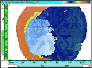

It was confirmed that impact damage exists at different levels through thickness; this is done by a time-of-flight (TOF) analysis ( Figure 6).
Fig. 6. TOF showing multiple level delaminations (55 J impact energy)
The delamination near the back wall is larger than the ones near the front wall (where the impact took place). When impacted there is rapid local bending at the impact point ( Figure 7).

Figure 8 shows a PA amplitude scan. RF data is collected at a digitising frequency of 100 MHz. The probe is a 16 element 7 MHz linear probe. Gates can be used to select delaminations at different levels. The data file is modified to remove repeat echoes that result in a misleading picture of the damage inside the material and artificially extend delaminations; currently there is no algorithm in the software to perform this task and hence repeat echoes were manually identified and deleted.

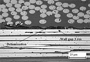

A study was carried out to confirm the -6 dB ultrasonically determined sizes of the delaminations in the sample by sectioning. A through thickness datum plane was identified accurately and corrected depth and size measurements were made of the delaminations. The sample was then sectioned and micrographs were taken at magnifications from x16 to x1000 (e.g. Figure 9).
Fig. 9. Delamination damage between two plies (45° (top) and 90°) showing typical measured wall gap in Q-ID-2 (Magnification x1000)
Table 2 shows that PA testing is able to locate and size multiple level delaminations within an acceptable margin of error (satisfying the minimum size criteria).
