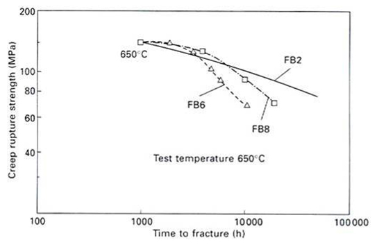

The FB2 parent steel used for this study is the most promising of a range of compositions containing 9-12%Cr that were developed in the previous phases of the COST programme, COST 501 and 522 for their creep resistance. The designation 'F' refers to compositions for forgings of the 10%CrMoVNbN type, and 'B' indicates the alloy is boron-containing. The number 2 indicates a particular composition in a series of experimental heats of similar compositions. Small additions of boron have been shown to improve creep strength [Kondo et al, 2006] . It has been reported that it combines with M23C6 precipitates, retarding their coarsening and the onset of tertiary creep [Zeilinska-Lipiec et al, 2007] . A Co addition is also present as an austenite stabiliser, to inhibit the retention of δ-ferrite, which is known to be detrimental to toughness and creep performance. The steel is a serious candidate for rotor forgings, piping and pressure vessels, albeit with different tempering treatments for the different applications. Further information on the development of CSEF steels in the COST programme have been reported by [Mayer and Masuyama, 2008] .
Testing of other FB variants from the COST programme was effectively abandoned due to their poorer creep performance, illustrated in Figure 1. The poorer performance of these variants, which contained higher Cr levels, was attributed to the early formation of modified Z-phase, (Cr(V,Nb)N), a nitride that forms via dissolution of strengthening MX precipitates [Danielsen, 2007; Mayer and Masuyama, 2008; Kozeschnik and Holzer, 2008] .
Figure 1. Creep rupture strength of the COST development steels FB2, FB6 and FB8 as a function of time to rupture at 650°C. FB6 and FB8 both suffered from short term on-set of z-phase causing the creep rupture strength to fall dramatically [Mayer and Masuyama, 2008]. Reproduced by permission of Woodhead Publishing.

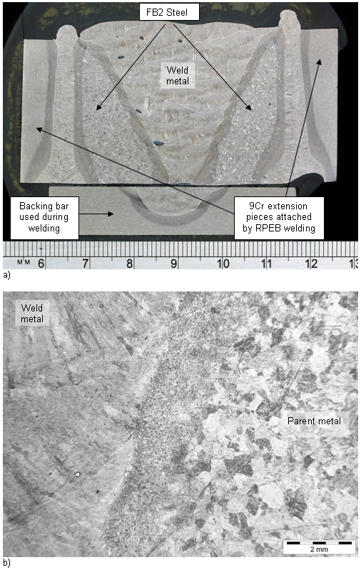

The welding techniques used in the investigation were FCAW, narrow gap TIG (both using experimental cored wires), and reduced pressure (~5 x 10-2 mbar) RPEB welding. The panels were given a PWHT appropriate for the intended application (3 hours at 760°C for 35mm thick FCAW, simulating pipe welding, and 10 hours at 680°C for the 80mm thick material simulating rotor welding). In some instances modified 9%Cr slabs were RPEB welded on as extensions to the FB2 steel, as can be seen in Figure 2, to make the cooling characteristics of the weld more realistic.
This study is the first to use RPEB for the welding of 9%Cr steel. The RPEB gun was developed at TWI to reduce pumping time for vacuum conditions, and to provide a more robust and economically viable solution for industry, compared with previous EB welding technology. Whereas conventional EB welding requires vacuum conditions (10-3 mbar), RPEB is operational at 0.1 to 10mbar. The process has great potential for thick section, high quality, high productivity welding requirements, and for this reason it is of interest in the current project. Further details of the development of this technology have been documented by [Punshon, 2008] and [Rothwell et al, 2008].
TIG welding is generally employed where high quality defect-free welding is required. The use of a narrow gap preparation has two immediate advantages. The first is the reduction in weld metal volume and therefore welding time for the production of a weld, and the second is that the smaller volume of weld material means less distortion of the fabrication is likely to take place.
FCAW has become increasingly popular as a semi-automatic welding technique and is considered an easier and quicker fabrication and repair technique than for example manual metal arc (MMA) welding.
The consumable compositions used for TIG and FCA welding were based on a commercial consumable for grade 92 but with the addition of Co and Ti. Studies have shown that the incorporation of 1%Co can improve both toughness and creep rupture strength of the weld deposit by reducing the amount of retained δ-ferrite [Barnes and Abson, 2003; Abson, 2004]. A separate study has indicated that small additions of Ti increase weld metal creep strength, [Abson et al, 2007]. The FCAW consumable was supplied by Metrode Products Limited and the metal-cored wire for the TIG welding was manufactured by Air Liquide.

Figure 2. Photomacrograph and micrograph of FCAW weld after PWHT. (The backing bar, having once been joined to the weld root, was sawn off, but then re-instated for this section. The EB welds towards each side join the FB2 parent steel containing weld FCW3 to the ends of the extension slabs). Etched in 2.5%HCL, 2.5%Picric dissolved in ethanol: a) Weld cross section; and b) HAZ;

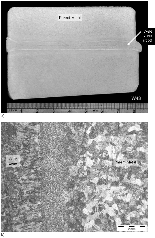

Figure 4. Photomacrograph and micrograph of RPEB weld W43 after PWHT. Etched in 2.5%HCL, 2.5% Picric dissolved in ethanol solution: a) Weld cross section; and b) HAZ;
Both parent and weld metal microstructures consisted of a tempered martensite with prior-austenite grain boundaries clearly visible in the parent microstructure and columnar structure of the RPEB weld. The weld metal beads in the FCA welds were suitably staggered to avoid continuous regions of HAZ within the weld metal, which can lead to preferential failure of the weld metal [Cerjak and Mayer, 2008]. Considerable refinement was observed in the TIG weld metal, due to the build up of layers on top of one another. All HAZs produced featured a much more refined prior austenite grain size than the parent material, and the definition between different regions in the HAZ was far from obvious. The TIG weld in particular seemed to have a particularly dark-etching region in the HAZ which is believed to be due to the arrangement of thin layers causing a high degree of tempering. Delta ferrite was not apparent in the RPEB weld inspected. However, very small quantities directly beneath the capping layer and also ~10-20mm from the root tip were observed in the TIG weld. In the FCA weld, more areas of delta ferrite were observed at various locations within the weld metal.

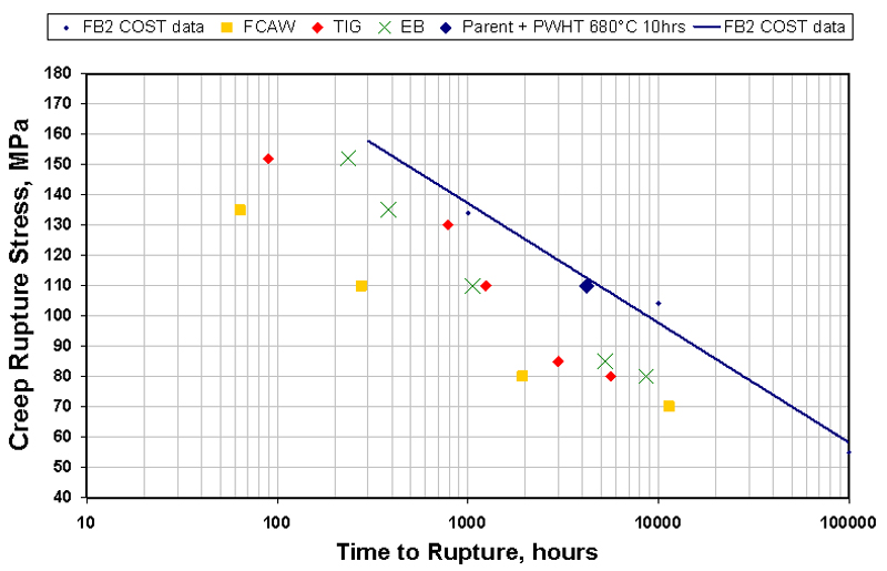

Figure 10 shows the creep rupture data determined at 650°C. In all cases, the cross-weld creep rupture strength is less than that of the FB2 parent steel (as measured in the COST 522 programme), and the parent steel subjected to PWHT2 in this study.
Figure 10. Creep rupture data determined at 650°C
For short test durations, the FCA weldments have appreciably lower creep rupture strength than that of the TIG and RPEB weldments and nearly all the fracture face was located in the parent material. At longer durations the performance of different weldment types is comparable.

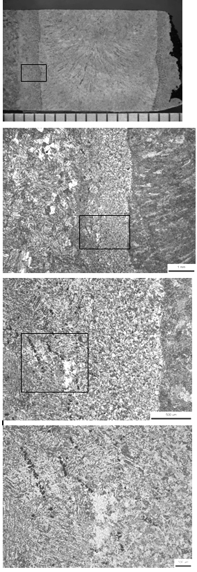

Many of the creep tested specimens were sectioned to determine failure locations. Microstructures of the creep tested specimens were noticeably more tempered, and the presence of creep voids particularly concentrated along what appeared to be prior austenite boundaries was observed for the longer running specimens as shown in Figure 13. In most cases, it was possible to identify whether the failure occurred in a particular region of the HAZ, parent or weld metal, but in some cases failure spanned different areas of the weld, and it was more difficult to define the region of initiation, fracture and cracking (Full details of fracture location and appearance reported by [Abson and Rothwell, 2009]). Two of the TIG specimens featured a partial fracture through the weld metal, but neither of the failures could be attributed solely to the fracture of the weld metal.
Figure 13. a) Macro image of Type IV failure for TIG specimen tested at 650°C, 80MPa and a rupture time of 5700hrs. mm scale shown. Etched in Picral; b) close up of HAZ region which didn't suffer complete failure showing void damage in the outer region of the HAZ; c) close up of void damage as indicated in b; and d) close up of void damage as indicated in c
The transverse metallographic section (Figure 13) shows creep cavitation that would have preceded failure, and that the damage accumulated in the outer edge (intercritical or fine grain region) of the visible HAZ (Figure 13d). This is the typical appearance of a Type IV fracture and void damage preceding failure in the HAZ.
The longer duration tests, especially those at high temperatures and low stresses, were clearly Type IV failures. Figure 14 shows a plot of the temperature and stress test conditions, and separates those specimens that obviously failed by the Type IV mechanism and those that did not. This is an attempt to define stress and temperature fracture map.

The creep strength of the cross-weld specimens lies below but almost parallel to that of the FB2 parent steel. The fact that the departure from the parent steel properties is not increasing significantly at longer durations may help designers to seek exemption from the newly introduced codes, and allow them to apply a less restrictive 'weld strength reduction factor'. Studies have shown that if boron and nitrogen are present in the right quantities, cross-weld creep strength is similar to the parent creep strength (Figure 15). This has been found to depend on the B:N ratio being such that large BN precipitates are fully dissolved, Figure 16. This preferable ratio and performance is characteristically accompanied by a HAZ that has not been refined by the welding process (Figure 17), which may explain to some degree the improved performance of these steels. Whilst FB2 is a boron-containing steel, the boron and nitrogen contents are such that BN is not fully dissolved at the solution treatment temperature. So, although boron appears to have improved creep strength overall and given the steel a competitive advantage over other grades, the boron and nitrogen ratio has not impacted significantly on susceptibility to Type IV cracking (a diffusion-controlled failure mechanism occurring in the intercritical and fine grain region of the HAZ). The effect of boron and nitrogen are discussed further in the next section.

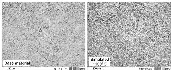

Figure 16. Solubility limit for BN at 1150°C for high Cr steel, with the corresponding information for the Fe-B-N system, derived by [Fountain et al, 1962]. superimposed. Also shown is the composition specification for P92. The figure has been adapted from [Sakuraya et al,2006] .
Figure 17. Microstructure in steel NPM1 before and after welding thermal cycle simulation showing that the location and orientation of features remains the same, [Mayr and Cerjak, 2007] . Reproduced by permission Dr P Mayr and Professor H Cerjak.
The poorer performance of FCAW joints at short test durations is likely to be due to the difference in heat treatment, with the higher temperature (760°C) relieving residual stress and tempering the parent microstructure more extensively than for the other weldments subjected to a PWHT at a lower temperature (680°C) with a corresponding lower H-J parameter value. This indicates that the higher H-J parameter of heat treatment PWHT1 is detrimental to rupture strength of the parent material in the short term.
Although two of the failed TIG creep rupture specimens featured partial failures within the weld metal at relatively high stress levels, it can be reasoned that the experimental weld metal designed and conceived within this project has been an overall success in terms of creep performance. No weld metal failures were observed in longer duration tests where Type IV failure became the dominant mechanism.

- The location of failure for the short term creep specimens was predominantly in the parent metal. Long term specimens mostly failed in the outer region of the HAZ, and were characteristic of Type IV failures. The onset duration forType IV failure was strongly dependent on the test temperature, with the duration decreasing as the temperature increased.
- No failures were observed in the weld metal for long-term cross-weld creep specimens, indicating that the experimental TIG and FCAW consumables and the autogenous weld metal resulting from RPEB welding used were of adequate creep strength for use with FB2 steel.
- No obvious effect on long term creep rupture performance due to welding process type was apparent in this study. In the short term, TIG and EB weldments performed better than the flux-cored welds. This is most likely to be due tothe differences in PWHT and consequential effect on the parent microstructure. However, there is no obvious advantage of one welding process type over another apparent in the longer term (>2,000hrs). The influence that PWHT has onthe results decreases with test duration, as the effect of metallurgical changes occurring during prolonged exposure at the test temperature becomes the most significant factor in governing the life of the specimens.
- At the target application temperature for FB2 steel (650°C) a ~20% improvement in creep strength and ~70% improvement in rupture life were observed for welded joints, when compared with Grade 92 data at long durations(>6,739hrs). The creep strength of FB2 weldments was found to be comparable to that of Grade 91 parent material.
