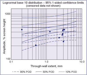

Twenty nine of the flaws are less than 4mm in TWE, and statistical methods can be used to show with 95% confidence, that flaws of 4mm TWE are detected with 90% POD. But this method cannot be used to establish 90% POD with 95% confidence for flaws smaller than 4mm, even though all 31 flaws gave signal amplitudes above the threshold. Moreover, since there are no non-detections, it is impossible to establish a functional dependence of POD on TWE. The usual method of dealing with such data is to use more advance statistical methods, and Figure 11 shows the regression line (the central solid line) fitted through the response versus size data of Figure 10 by the method of Maximum Likelihood. This method properly accounts for the saturated data and provides estimates of the slope and intercept of the regression line (and the spread of data about this line) that maximises the likelihood of obtaining the observed data.
Fig.11. Regression analysis of response versus measured sites
In this sense, the resulting estimates are those that agree most closely with the observed data. Figure 11 plots the 'exact' data only (ie where the signal was not saturated) even though the saturated data is taken into account in estimating the position of the regression line. This is why the regression line does not lie centrally among the data points.
Figure 11 also shows estimates of the 10th and 90th percentiles of the distribution of signal amplitudes about the regression line, which correspond to the threshold levels that are needed to achieve 90% POD and 10% POD, respectively. The centrally positioned straight lines are the best estimates of the percentiles, whereas the curved lines correspond to one-sided 95% confidence limits on these percentiles. The lowest dashed curve indicates that flaws of 2mm TWE are detected well above the inspection threshold with a POD of 90%, with 95% confidence.

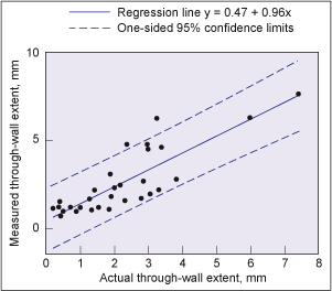

Figure 12 illustrates AUT sizing with measured data for the same 31 pipe weld flaws. The lower dashed curve, for instance, indicates that flaws of 4mm TWE will, with 95% confidence, have a measured TWE of at least 2.5mm. This information can be used to derive acceptance criteria based on fitness-for-purpose principles. If an engineering critical assessment shows that the pipeline can tolerate flaws larger than 4mm TWE, then an acceptance criterion based on 95% reliability will require rejection of all welds containing flaws having a measured TWE larger than 2.5mm.
Fig.12. AUT flaw sizes versus sizes determined by sectioning
In summary, the general purpose of NDT is to provide accurate flaw information. This, in turn, allows engineers to make judgements concerning the future life and/or safety of pipelines. These judgements need to take account of the effectiveness of NDT techniques, both in terms of flaw detection and sizing. This section has shown that there are relevant statistical methods available for quantifying the reliability of pipe weld flaw detection and sizing information which can be used to validate NDT approaches.

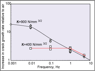

The effect of very low-frequency cycling has been examined by carrying out so-called 'frequency scanning' tests. These are crack growth rate tests carried out under conditions of constant applied stress intensity factor range ΔK, where the cyclic frequency is varied in blocks to determine how frequency affects the fatigue crack growth rate, at a particular value of ΔK. By monitoring the crack growth rate over a relatively short crack increment, it is possible to determine da/dN for much lower frequencies than would be possible using conventional test techniques. Figure 13 shows a typical set of data for X65 pipeline steel tested in 3.5% NaCl at an applied cathodic protection potential of -1050mV. It can be seen that, as the frequency decreases, the measured crack growth rate increases until a plateau is reached, where it appears a further decrease in frequency has no further effect. At ΔK=400N/mm3/2, the plateau occurs at approximately 0.1-1Hz. At a higher value of ΔK, the observed increase in growth rate was initially similar, but a plateau was not reached until a much lower frequency, at least as low as 0.001Hz.
Fig.13. Frequency scanning test data for C-Mn steel in seawater

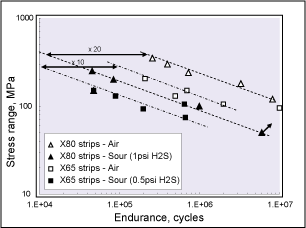

A further example of the data reviewed by Baxter et al, (2007) relates to the effect of H2S-containing solution on fatigue endurance. This example has been chosen because there are very few published endurance data for girth welded C-Mn steels in sour environments. The only published data relate to tests carried out by Buitrago and Weir, (2002) where strips extracted from girth welded X80 and X65 pipe were tested in H2S partial pressures of 35-70mbar. Data are reproduced in Figure 14 and it can be seen that fatigue life was reduced by a factor of 10-20 compared to both strip tests and full-scale tests carried out in air.
Fig.14. Fatigue endurance data for girth welds tested in air and sour environment
The experimental data available all indicate that environmental and mechanical test conditions can have a significant effect on the observed fatigue endurance or crack growth rate. The need to ensure that design data are determined from tests carried out under conditions that realistically simulate those encountered in service cannot therefore be over-emphasised.
As described above there are detrimental effects of sour fluids on the fatigue performance of riser girth welds in C-Mn steel pipe. Results indicate that a reduction in fatigue life may occur in sour fluids by a factor of up to 20, particularly at higher stress ranges. Consequently, there is a need to explore the use of corrosion-resistant alloys (CRAs), either stainless steels, nickel alloys or titanium alloys as alternative riser materials, either as a solid or clad product. The main candidate stainless steels are high strength grades such as 12%Cr supermartensitic, 22%Cr duplex and 25%Cr superduplex grades, or austenitic grades such as 316 stainless steel or Ni-Fe alloy 825, but these have fairly low strength and would have to be used as a clad product. This section, based on work by Woollin et al, (2005), presents an example results of corrosion fatigue crack growth rate behaviour of welded supermartensitic and superduplex stainless steels in seawater with cathodic protection and in a sour environment.

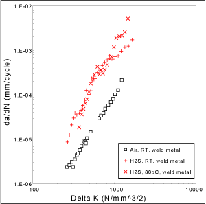

Full details of the experiments carried out and the results obtained are give by Woollin et al, (2005) but, as an example, Figure 15 shows the fatigue crack growth rate results for the 25%Cr superduplex stainless steel welds in a sour brine solution. At both ambient temperatures and 80°C, crack growth rates were substantially higher in the sour environment than in air. Crack growth rates were up to ten times higher than in air at higher ΔK values, particularly in the mid-ΔK range. At high and low ?K values, the effect of the environment is apparently reduced, especially at 20°C in the high ΔK range, although it is noted that only a fairly small amount of data is available in the low ΔK regime.
Fig.15. Fatigue crack propagation data for superduplex stainless steel weld metal centreline notched specimens tested in air and a sour brine with 25mbar H2S
The effects of the various environments on fatigue crack growth rates observed by Woollin et al, (2005), may provide the basis of preliminary design recommendations. Thus, in the presence of sour brine, for a structure which experiences low-frequency fatigue loading, a fatigue life reduction factor of at least 5-10 may be required for superduplex stainless steel welds. However, since this appears to be particularly relevant at relatively high crack growth rates, it might not be necessary to apply such factors except for low-cycle fatigue applications. There is a need therefore for endurance testing of specimens with geometry representative of real components to determine accurately the fatigue life in such corrosive environments.

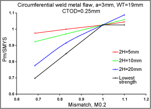

The mismatch ratio M is defined as Mx = σYw/σYb, where σYw or σYb are flowstresses corresponding to the same amount of plastic strain of the weld metal and base metal, respectively. The sub script x defines the plastic strain at which mismatch is defined. Since the weld metal and base metal will, in general, work harden differently, the degree of mismatch will vary with plastic strain. Mismatch limit loads are given in R6 for fully circumferential internal cracks in cylinders. This geometry was considered representative of a long surface flaw in a pipeline girth weld. The mismatch limit load solutions consider parallel sided welds and are for weld metal centreline flaws and flaws located at the interface (in this paper, the interface is considered to be representative of the HAZ/fusion line). The choice of limit load depends on the expected deformation pattern as described by Pisarski et al, (2004).
Figure 18 shows how the allowable axial stresses (represented as the ratio of allowable stress, Pm, to the specified minimum yield strength (SMYS) of X100 strength pipe changes with mismatch level in different weld widths. The assessments were conducted assuming that a minimum CTOD of 0.25mm at the minimum design temperature is achieved. The first analysis was conducted assuming that the flaw is in homogeneous material (no strength mismatch) with tensile properties equal to the lowest strength present. This is the recommended procedure when mismatch limit load solutions are not available. As can be seen, this provides, as intended, a conservative estimate of allowable axial stress. If mismatch and weld width effects are specifically considered, benefits to the allowable stress are realised as the weld width is reduced from 20 to 5mm. Although the allowable stress increases for undermatched welds (M<1), it always remains below that for matched and overmatched welds. When overmatching is present and the flaw is located in weld metal, increasing the weld width increases the allowable stresses. However, when the difference in weld metal and parent pipe strength is small (M ≈ 1), the best strategy is to design a narrow weld. For narrow welds, if slight undermatching occurs, the reduction in allowable stresses minimised, and there is still a benefit in allowable stress if overmatching occurs. Further analyses show that for a given level of undermatching, HAZ flaws are more sensitive to weld width effects than weld metal flaws. Nevertheless, there is a clear benefit of using narrow welds if undermatching is likely.
Fig.18. Ratio of allowable axial stress to SMYS of X100 pipe for 3mm deep circumferential weld metal flaws at different levels of strength mismatch and weld

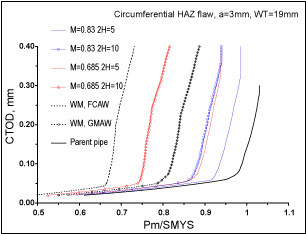

Figure 19 shows how the CTOD requirement varies with applied axial stress for different weld widths and mismatch levels. Also included are analyses for homogeneous material. These provide bounds to the analyses and illustrate the benefits of allowing for mismatch effects. The figure shows that CTOD requirements increase rapidly when the applied stress approaches yield strength magnitude. A limit is reached when further increases in applied stress cannot be accommodated by further increases in fracture toughness. This condition is obtained when failure is predicted to occur by plastic collapse rather than fracture. In practice, crack growth by stable ductile tearing will occur before plastic collapse and this will affect the analyses at higher CTOD values (say above about 0.3mm when initiation by ductile tearing is likely to have taken place).
Fig.19. Relation between CTOB requirements and ratio of axial stress (Pm) to Grade X100 SMYS for HAZ flaws (3mm high0 with different mismatch levels (M) and weld widths (2H)
The analyses show the clear benefit of even small amounts of weld strength overmatch. For the weld metal flaw case considered, axial stresses above the pipe SMYS are acceptable with a 3mm deep weld metal flaw present provided that CTOD is greater than about 0.1mm. The results also show how fracture toughness requirements need to be increased if undermatching is present to achieve the same flaw tolerance. However, the increase would not be as great as predicted by an analysis based on the least strong material. For example, Figure 19 shows that for M = 0.83, an analysis based on the GMAW weld metal would require a CTOD of 0.25mm for an axial stress 85% of SMYS. By specifically analysing for the undermatched condition (M = 0.83), the CTOD requirement can be significantly reduced, to about 0.05mm.
It should be noted that if the HAZ strength undermatches the strength of both weld metal and parent pipe, the likelihood of cleavage can be increased. This can result in very low fracture toughness values being measured in the HAZ (Pisarski and Harrison, 2002). In addition, there will be effects of internal pressure acting on top of axial loading, because of effects on constraint. Finally, residual stresses need to be considered in deriving practically applicable fracture toughness requirements. Nevertheless, the relatively simple stress-based procedures described here are useful to illustrate the effects of mismatch and weld width on fracture toughness requirements to avoid fracture in girth welds.
In conclusion, a simple method based on recognised flaw assessment procedures has been used to illustrate the effects of weld width and strength mismatch on the CTOD requirements for girth welds in X100 strength pipeline material subjected to axial stresses. It has been shown that CTOD requirements derived from analyses based on homogeneous material (i.e. making no allowance for mismatch) are conservative and can be reduced if mismatch effects are specifically considered.
Analyses show that the adverse effects of weld strength undermatching can be mitigated by reducing weld width and this can be demonstrated by specifically considering mismatch in the calculations. The results also show the benefits of even small amounts of weld metal overmatching on the maximum tolerable axial stress. The results illustrate the use of fracture mechanics to examine the effects of the competing effect of weld metal strength and toughness on girth weld performance.
