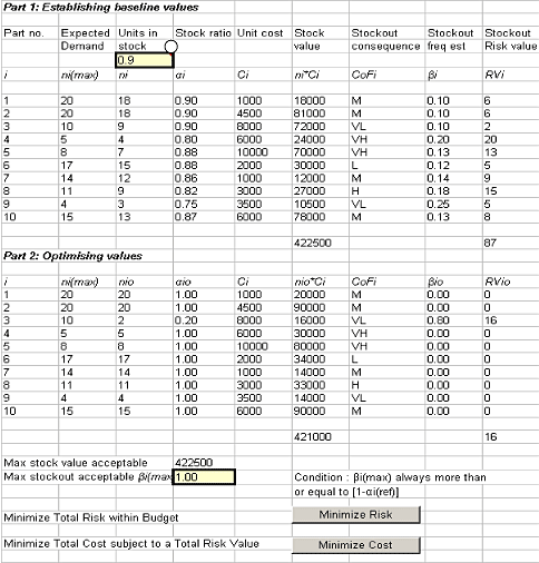

The model has two parts: Part 1 establishes baseline values, and Part 2 optimizes values. The implementation of the approach is shown by way of an example shown in Figure 1.
Fig.1. Minimize Total Risk subject to given Budget

At the outset, in Part 1 of the model, an appropriate value for αi(ref) is assumed; in Figure 1, this is 0.90. αi(ref) (shown in the highlighted box with a small circle towards its top right corner) is a percentage of the expected spare parts demand, necessitated by failures, to be held in the inventory. This starting assumption is necessary to find baseline values for Total Stock Value (TSV) and the Total Risk Value (TRV) of the inventory, say, TSVb and TRVb respectively where,
[5]
[6]
The values above are, in essence, baseline or reference values that establish what is an acceptable level of overall risk and the associated cost of stock holding at that level. Having established these baseline values as a starting point, we then move on to Part 2 of the model in which linear optimization is carried out. In the model demonstrated here, the Linear Programming is through the Solver add-in to Microsoft Excel.
The optimization here is as follows:
Minimize TSV such that TRV ≤ TRVb . All values are integers and greater than zero. The optimized values for TSV and TRV are TSVo and TRVo respectively.

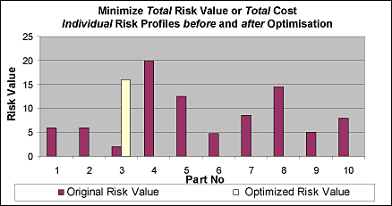

Figure 1 shows the risk profile of various components in the last column. The figure shows Stockout Risk values associated with αi(ref) 0.90 both before and after optimization.
Modes of operation:
(A) Minimize Total Risk
Figure 1 shows the results when Total Risk is minimized subject to given budget. As seen the Total Risk Value reduces from 87 before optimization to 16 after optimization.

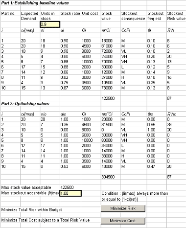

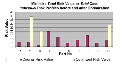

(B) Minimize Total Cost
Figure 2 shows the results when Total (inventory) Cost is minimized subject to a reference level of (tolerable) Total Risk. As shown in the figure, the Total Cost comes down to 304500 from 422500, given a Total Risk Value tolerance of 87.
Fig.2. Minimise Total Cost subject to a tolerable level of Total Risk Minimise Total Cost graph
Although optimization has been carried out as described, there may be some components for which the risk profile may be considered too high to be acceptable to the decision maker. For example, as shown in Figure 1, the RV for part 3 i.e. RV 3 o is 16; this is an expensive part of VL consequence, but the likelihood value of a stockout relative to other parts is high at β3o. Similarly, in Figure 2, Part 3 has a Stockout likelihood of 1.00 (100%). Such a value may be deemed too high by the decision maker especially when it is substantially different to that implied by αi(ref) that was assumed initially in Part 1 of the model as part of establishing baseline values. It may be noted here that αi(ref) = 0.9 implies a reference stock level that expects to meet 90% of the expected maximum demand, i.e., other things being equal, 10% of expected maximum demand is expected not to be met: stockout would be at 10%.

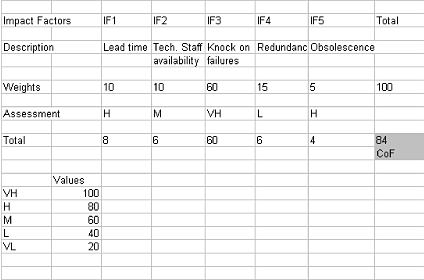

The consequence or impact of a failure to meet a demand for a spare is a qualitative assessment in the model described above. It is worth noting that the same model will work by directly putting in the likely impact cost (in monetary terms) of a failure to meet a demand for a particular spare. However, it is at times difficult to quantify the full implications of such an event. Therefore, such qualitative assessments, despite the subjectivity involved, are often the best way to fully estimate the impact of an event. One can make such estimates more precise by fine tuning the consequences part of the risk estimate. For example, CoF (Consequence of Failure to meet a demand i.e., a stockout) can be a weighted sum of various consequences factor values such as: extra cost of procuring a part on an urgent basis and the lead time under such circumstances, availability of technical personnel to effect repairs, knock on effect of failure to meet a part on the general availability of the system and the risk of obsolescence of a part or the machine itself. Figure 5 shows how such an approach can be developed. The approach consists of the following main steps: (1) Identify factors that impinge on a failure to meet a demand for a spare- impact factors (IF) - for each spare under consideration. In Figure 5, these are lead time, availability of technical staff, knock-on failures and associated demands, potential for machine or spare redundancy and obsolescence (2) Ascribe weights to each of these impact factors to reflect their relative importance. In the table, these are 10, 10, 60, 15, and 5 for IF1 through to IF5 respectively. (3) Determine relative importance values for VH, H, M, L or VL representing Very High, High, Medium, Low and Very Low. These are shown to be 100, 80, 60, 40 and 20 respectively. (4) The spare is then assessed qualitatively- VH, H, M, L or VL - under each of the impact factors identified in step (1). The net result of this exercise is an aggregate Impact Value. This is '84' in the example shown in the Figure 5. This process is repeated for each spare that is under consideration in an inventory. The relative weights or values in step (2) and step (3) may or may not be the same for all parts. Indeed, impact factors also may differ with parts.
This model takes an expected maximum demand for a period as given; the model in its current form is thus based on periodic reviews. The forecast can be made continuous by using a moving average method for the demand trend which can make this a continuous review model that may be more advantageous in some circumstances. The model can also be configured to take in probabilistic distributions as demand forecast. A more advanced version of this model is being developed along these lines.
Fig.5. Deriving Consequence Value for a part from a number of Consequence estimates
