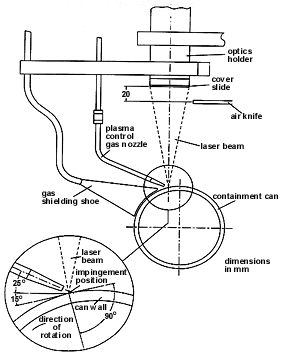

Shielding
A shielding shoe was provided to protect the solidifying weld bead from oxidation as illustrated in Fig.2. Helium was used at a flow rate of 80l/min and nitrogen was used at a flow rate of 40l/min.
Fig.2 Schematic of gas shielding and plasma control arrangement for Nd:YAG laser welding of stainless steel enclosures
Plasma control
This system involved the use of a gas jet, which was delivered through a nozzle directed towards the beam workpiece interaction zone, as illustrated in Fig.2. The gas type, flow rate, nozzle diameter, angle of incidence and impingement position were varied. For the impingement position, a positive displacement indicated that the gas jet was aimed at the workpiece behind the weld, thus interacting with the plasma above the weld.
The parameters investigated are presented in the results section.

The nozzle diameter for the initial trials was fixed at 1.2mm to produce a high gas flow velocity for the plasma control effect. In the trials with helium gas, it was found that 28l/min appeared to be the optimum flow rate, with higher flows producing gouging of the weld and low flows not being effective in control of the plasma. However, it was also noted that the tolerance to position of this nozzle diameter was critical, with only an impingement point of +1.5mm producing welds of acceptable levels of porosity and penetration.
The nozzle diameter was enlarged in subsequent trials to 2mm and 3mm, where a tolerance to gas jet to beam position was increased to ±1mm from the position of +1.5mm. This was achieved without altering the gas flow significantly.
Effect of plasma jet impingement position
As mentioned above, when the 1.2mm diameter nozzle was used, there was little tolerance to the impingement position of the plasma gas jet. This tolerance was extended using 2mm and 3mm diameter nozzles. It was also noted that any lateral displacement of the nozzle away from the weld line would result in an increase in porosity and the accuracy of positioning must be maintained within 0.5mm of the joint line.
Effect of gas flow
The gas flow using helium was based around 28l/min. Higher flow rates tended to produce some gouging of the weld top bead, whilst the lower flow rates did not effectively control the plasma.
