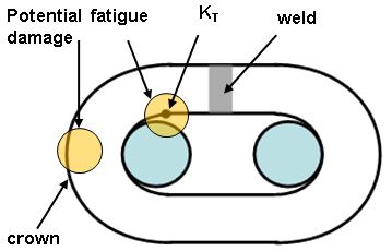

For many years, mooring chains have been designed per well established standards such as API RP 2SK (1), Lloyds Register (2) or DNV-OS-E301 (3). These standards help engineers to select the relevant chain link grade and size depending on the fatigue loads and the planned life of the mooring system. These codes are mainly based on mechanical testing and experience (1-3). It is understood that their recommendations aim to avoid fatigue failure, mainly at two different locations: the crown and the KT point; the KT point is approximately the region of the intrados where the shank and the crown intersect (Figure 1). These regions are those where the ratio between the local stress and the nominal stress in the shank is the highest. The stress ratio is determined from an elastic analysis of the chain link under tension. For example, the stress ratio at KT is about 4 for a standard chain link.
Figure 1 Regions of the chain link where high stress ranges can cause fatigue cracking
