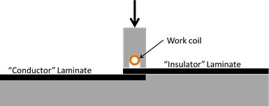

In order to demonstrate the strength of welded joints made using TWI’s technique single lap shear specimens were manufactured and tested according to ASTM D1002-10. Two nominal 4mm thick 0/90 cross-ply laminates were manufactured and joined; one containing 27 plies of carbon/PEEK (“Conductor”) and the other (“Insulator”) containing 24 Carbon/PEEK plies but with adjacent non-aligned layers separated by glass/PEEK insulating layers. The weld area was approximately 12.5mm wide and 150mm long. An Ambrell EasyHeat10 power supply tuned to a frequency of 240kHz was used to carry out the welding. A higher power setting was used compared to the previous heating trial, as the temperature required for welding was 400°C.
The laminates were arranged as shown in Figure 3, with the “Insulator” laminate closer to the work coil. A 100μm PEEK film was placed at the weld between the two laminates. The film acted as a PEEK rich layer at the interface to help the flow of polymer during welding, and to fill any undulations in the surfaces being welded. Pressure was applied to the weld area by means of a pneumatic actuator.
Figure 3. Weld configuration for joint evaluation.
Samples were taken from the welded laminates using a water-cooled diamond coated saw blade, and tested according to ASTM D1002-10, using a displacement rate of 10mm/min. 5 Results
