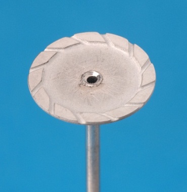

The Hydrosteel™ is a non-invasive hydrogen patch probe that requires little or no surface preparation. It is commonly used for corrosion monitoring often at relatively low temperatures, but can be used at elevated temperatures. The probe works on the principle of analysis of gas volumes collected over a fixed area. The fixed area is 'swept' by using a vacuum to draw the gases into the probe. For the larger (150mm diameter) corrosion probe, the gases are guided to the centre of the probe with a spiral ridge in the plate. For higher temperature use, a smaller collection area can be used, and the manufacturer of the Hydrosteel™ probe has developed a “weld sized” probe (Figure 1), in conjunction with this project. Rather than the spiral design, fluted channels in the outer surface have been used to assist in effective gas collection. The rate of air flow into the probe for analysis is 0.5ml/s. The probe is coupled to the workpiece using magnets.
Pargeter 2 Figure 1
Figure 1.The Hydrosteel™ weld probe, showing the fluted channels for air suction to allow gaseous hydrogen to be collected from the surface of the weld

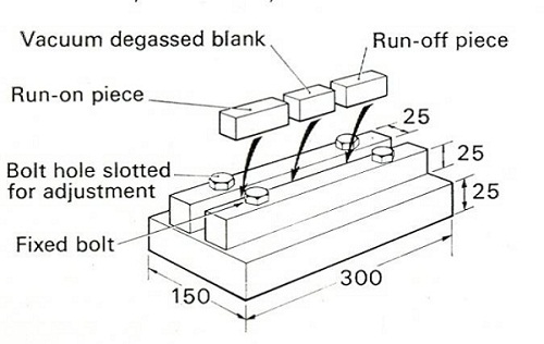

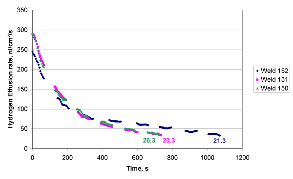

To explore this, manual metal arc weld deposits using consumables of different hydrogen potential were made for hydrogen analysis, using the equipment used for standard hydrogen determination in weld metal. Sets of three deposits were made at heat inputs of approximately 1.5kJ/mm to achieve a wide weld bead and were tested in accordance with ISO 3690, except that the welds were allowed to cool in the jig (shown in Figure 2) to 80°C prior to quenching. The welds were analysed for hydrogen concentration using gas chromatography.
Pargeter 2 Figure 2
Figure 2 The jig used for hydrogen determination to ISO 3690
Following an initial set of rutile welds, three further rutile weld deposits were made and the caps milled to allow the probe to be positioned on the sample. The hydrogen effusion rates were recorded at 80°C prior to quenching to allow analysis in accordance with ISO 3690.
Three more very high hydrogen (cellulosic) weld deposits were then made The welds were allowed to cool to 80°C, but this temperature was maintained until the hydrogen effusion rate reached the average level for the rutile deposits at 80°C. The weld was then quenched for analysis in accordance with ISO 3690.

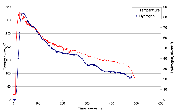

The initial trials confirmed that the method could be used to successfully record the hydrogen effusion and temperature over time. The Hydrosteel™ has two methods of operation - continuous measurement and measurement over one minute; in both cases, measurements are taken at five second intervals. Using the one minute monitoring option, the drop in hydrogen and temperature were recorded over ten minutes (Figure 3), for a basic electrode. The gaps in the data correspond to the resetting of the probe.
Pargeter 2 Figure 3
Figure 3 Hydrogen and temperature response for a basic electrode, deposited at approximately 0.4kJ/mm

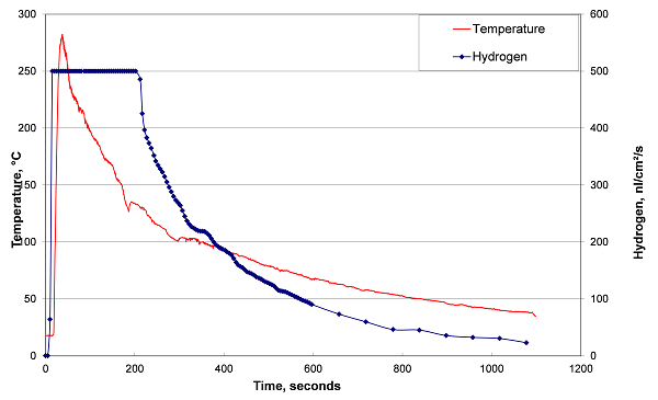

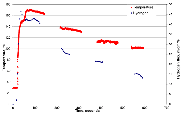

This was repeated using the continuous monitoring option for the cellulosic electrodes and for vacuum packed basic electrodes (Figures 4 and 5). The undulation of the traces is principally a result of some instability of the probe, giving some variability in coupling.

Figure 4 Hydrogen and temperature response for a cellulosic electrode, deposited at approximately 0.4kJ/mm. The maximum level of flux that can be recorded by the probe is 500,nl/cm2/s

Figure 5 Hydrogen and temperature response for a vacuum packed basic electrode, deposited at approximately 0.4kJ/mm
As indicated in Figure 4, the hydrogen flux from the cellulosic weld was very high, in excess of 500nl/cm2/s until the temperature of the weld had reduced to below 130°C. For the basic electrodes, the hydrogen released had dropped to 25-30,nl/cm2/s by the time the weld had reached this temperature.

The average hydrogen effusion rate recorded at 80°C for the second set of rutile welds (with local cap dressing) was 33.1nl/cm²/s, from the range 19.8 to 44.9nl/cm²/s. The values recorded for the cellulosic electrodes on completion of the hold at 80°C were in the range 33 to 42nl/cm²/s. The plot of the change in hydrogen effusion rate with time for the cellulosic welds is shown in Figure 6.
Pargeter 2 Figure 6
Figure 6 Change in hydrogen effusion rate with time at 80°C for cellulosic welds, with measured hydrogen content marked
The average hydrogen level in the rutile welds after cooling to 80°C with hydrogen effusion rate monitoring was 23.1ml/100g. This compares well with the range of 10.1 to 23.0ml/100g obtained for the rutile electrodes assessed in a manner similar to that described in the standard. The average hydrogen level in the cellulosic welds after cooling to 80°C and holding until the hydrogen flux was similar to the level in the rutile welds was 22.5ml/100g. This compares favourably with determination of hydrogen after cooling to 80°C in the rutile electrodes (23.1ml/100g).

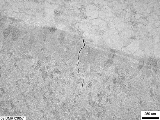

At all the locations where indications were identified in Welds A and C, only collapsed pores, or entrapped slag were found on metallographic sectioning. However, some weld metal cracking was identified associated with other indications in Weld B (Figure 7). The crack path was consistent with hydrogen cracking, and was transverse to the welding direction.
Pargeter 2 Figure 7
Figure 7 Weld metal hydrogen cracking identified in Weld B
