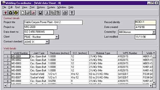

An integrated software system such as Welding Co-ordinator can help. Welding Co-ordinator is designed to be used live to manage fabrication as it is progressing. It is usually based around an electronic weld map, weld data sheet or weld schedule, into which data are entered as welds are designed, engineered, welded and tested. The weld map would also usually have some space for approval, either weld by weld, or once a project or structure has been completed. Figure 1 shows a detail of a typical weld map for a fabricator in the power generation industry.
Fig.1. Detail of a weld map from Welding Co-ordinator typically customized for a fabricator in the power generation industry.
Data are usually entered into the system from four functions, as follows:
  1. At the design stage, where information such as the weld ID number and other design parameters (material type, thickness, joint type, etc.) are entered.
  2. At welding engineering, where a procedure is assigned. It may also be possible to identify suitable welders or classes of welders qualified to make the weld, although this is more likely to be done at the production stage.
  3. At production, where the completion of a weld is registered (usually by entering the date) and visual inspection carried out and approved.
  4. At quality control, where acceptance of the weld is registered. This may be simply by typing test report numbers into the system, or it may be done with live links to electronic NDE reports.
Note that data should be entered live into the system as fabrication progresses.
The system also gives instant progress reporting. Anyone with access to the system can see how fabrication is progressing. This may be simply by looking at the weld data sheet on screen or by explicitly programmed progress reports.These can identify bottlenecks (by, for example, comparing the number of welds completed with the number of weld radiographed), or help to produce reports for stage payments in large projects.
It also provides automatic assignment of welding procedures and welder. If enough information is supplied at the design stage, the system searches through a database of procedures for suitable welding procedure specifications(WPSs). This may be a single WPS of a number from which to choose from, with a click of a mouse button. Having chosen a suitable WPS, the system searches through WPQs for qualified welders. If necessary, the system can list welders inorder of their certificate expiration dates - with those due to expire soonest at the top of the list - so maximum benefit can be made of extending their qualification.
The software also produces test requisitions automatically. The system automatically produces NDE requisitions based on the NDE requirements for the project. These can be selected manually, or the system could randomly select welds for testing.
The system can also produce reports on repair rates per welder (to identify training requirements), by procedure (to highlight defect-prone procedures) or by any other measure, providing the relevant data are recorded.
It also automatically generates document packs on completion of a project. A very time-consuming task manually, it's again ideally suited for computerization. With the click of a button, the system can print the weld maps for a project, along with all the WPSs used (with backup procedure qualification records [PQRs] if necessary and all the WPQs, which are updated automatically based on satisfactory production welds. In addition, if NDE specifications have been used to report testing, the system can print relevant NDE reports as well. This information can also be archived on CD.
It can also instantly trace production welds to the information backing them up. If the inspector wants to see a WPS that was used on a weld, or proof that the welder was suitably qualified, this can be done with the click of a button. This can be especially useful while inspecting a structure after a number of years of service. If a defect is found, the engineer can access the original WPS, for repair purposes, or the NDE report, to see if evidence of the defect was present at testing.
