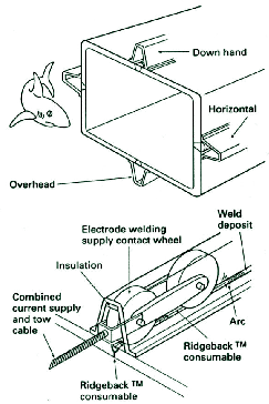

Fig.2 Basic principle of MCAW using a Ridgeback™ consumable
The process works as follows: the current supply is made with a sliding or rolling tool to the consumable via a narrow ridge which is part of the consumable core as shown in Fig.2. Initially an arc is struck, using a fuse or fine wire wool at the end of the electrode to ionise the consumable/substrate arc gap. The flux underneath the consumable core ensures electrical insulation between base material and the Ridgeback™ consumable and maintains a controlled arc length throughout the welding operation. The arc length can be changed by altering the thickness of the flux covering or by changing the shape of the metal core. The arc burns along the consumable electrode leaving a weld deposited onto the workpiece, as illustrated in Fig.4.

The welding tool supplies the welding current to the consumable at a distance of approximately 50mm from the arc end. The welding tool, depicted in Fig.3a, resembles a bicycle handle bar and consisted of a rectangular copper block mounted upon an insulated steel bar. To minimise friction between the welding tool and the electrode, a copper wheel can also be used instead of the skid, as is illustrated in Fig.3b.
Both an AC transformer and a DC power source were used for welding. Welding was carried out manually, mainly in the flat position. However, welding in position was also possible providing the right choice of process conditions, flux composition, core material and consumable geometry was selected. For the purpose of this paper, only bead-on plate welds have been reported.

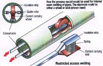

Fig.8 Restricted access welding
Internal welding of pipes or tubes also present access difficulties which can be overcome using the MCAW technique (see Fig.8).
