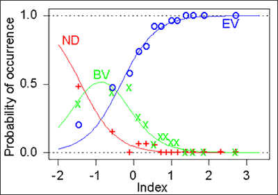

To help clarify the underlying physical processes governing flaw detection, TWI has developed an 'index of detectability' based on a simple model described by Pollitt [1] . The index is strongly correlated with the experimental results, and there is a simple functional relationship between the probability of defect detection and the index, for the data considered in this study. For example, Figure 1 illustrates Interpreter 1's results, together with the fitted relationships.
Fig.1. Performance of Interpreter 1 versus the index of detectability (+ = Not Detected, x = Barely Visible, o = Easily Visible)
Logistic regression analysis confirms previous findings that Pollitt theory is broadly pessimistic in predicting radiographic detectability, and enables the extent of this pessimism to be quantified in terms of the probability of defect detection.
The analysis shows that the index has a far stronger influence on the detectability of planar flaws than any other parameter studied. This confirms its value as a derived parameter. However, for a given index of detectability, additional factors due to human performance (the interpreter) and flaw morphology also seem to be important - the variation in detectability with flaw morphology partly manifests itself as an apparent variation with different flaw types. A recent experimental study of human performance has shown, however, that there is little variability between different interpreters in the detectability of large planar defects. This study suggests that the apparent variations of human performance in the earlier study were, in fact, largely due to different qualitative interpretations of defect visibility, rather than being related to defect detectability. Other factors that seem to have an effect on detectability, over and above that predicted by Pollitt theory, are unsharpness, effective source-to-film distance and penetrated thickness. However, these are weak effects and may be due to inaccuracies in the existing form of Pollitt theory. Further work, based on an alternative, more rigorous, theoretical formulation is already in progress.
The models described can be used to estimate how easily a defect can be detected, from knowledge of its size, orientation and other relevant parameters. In principle, the probability of detection and an associated confidence interval can be estimated. However, it is possible that the models may be biased by the choice of defect population in the experimental study, which comprises just 16 large planar flaws, all in thick-section welds; caution needs to be exercised in extrapolating the results to other flaws.
