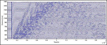

The A-scans obtained for the different positions shows clearly the existence of a principal non dispersive mode travelling at the velocity 5225m/s, this mode is the less dispersive and the corresponding wave number is around 72 for the frequency of 60 kHz. Different modes are also shown in the Figure 4, they are superposed and the identification is very difficult to be achieved from the A-scan of the Figure 4. For this reason we use the advanced 2DFFT post processing aiming the identification and the separation of the different type of modes. The 2DFFT processing algorithm is described in [10].
Fig.4. Time distance A-scans acquisitions
