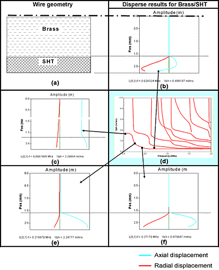

Dispersion curves are used to describe the nature of the existing wave modes at a particular frequency with respect to its travelling velocity. They have been constructed for an insulated wire with the following parameters[10,12]:
Table 1. Material property and dimensions for the brass and heat shrink tubing [10,12]
MaterialBrassHeat Shrink Tubing
Young's Modulus (GPa) 108.94 0.72
Density (kg/m3) 8500 958
Passion's Ratio 0.35 0.46
Rayleigh Velocity, (m/s) 2036 484
Radius, (mm) 1.59 2.175
The radial displacement in Figure 1a shows very little amplitude vibration taking place. On the other hand, operating at the high frequency non-dispersive region (see Figure 1b), the longitudinal wave mode L (0,1) turns its axial displacement to radial displacement. Here, most of the propagation takes place in the insulation with no displacement in the conductor's material. Furthermore, Figure 1e & 1f shows that operating at the dispersive region, all the axial and the radial displacement will take place in the insulator with no propagation in the conductor's material. Therefore, in order to propagate L (0, 1) in both insulator and conductor materials, exciting longitudinal wave-mode at low frequency will be the convenient way to propagate guided waves.
Fig. 1. Shows different graphs for describing the displacement at different regions in the dispersion curves for the insulated wire:
(a) representation of the insulated wire structure,
(b) displacement of guided wave at high frequency in the non-dispersive region,
(c) displacement of guided wave at low frequency in the non-dispersive region,
(d) dispersion curves for insulated wires,
(e) displacement of guided wave at the dispersive region at the low frequency region,
(f) displacement of guided wave at the dispersive region at the high frequency region

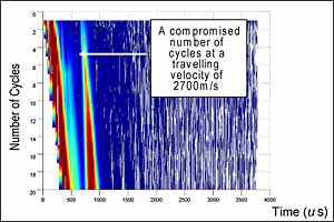

3.2 Optimum excitation parameters
There is a need to find the optimum frequency range and number of cycles as this will have a significant effect on the nature of the excited wave, propagation distance, attenuation and dispersion. Therefore, a full study and analysis is needed to determine the parameters which satisfy these two factors. An initial experimental trial has been carried out to look into the effect of the number of cycles at different frequencies. A range of frequencies from 20 kHz up to 100 kHz with an increment of 10 kHz between each test was applied to the insulated wire.
Fig.5. Experimental results for insulated wire at 60 kHz
Figure 5 shows the number of cycles (vertical axis) versus time (horizontal axis) at the excitation frequency of 60 kHz. From the figure, it shows that 5 cycles are a reasonable compromise number of cycles for the tone-burst signal to be constructed and propagated. Furthermore, the frequency range is also sufficient to propagate guided waves. The lower the frequency is the higher energy the wave has. In contrast, the high frequency is, the lower energy the wave has, hence, higher attenuation. This attenuation is due to the presence of the insulation. At this frequency, the effect of dispersion of the output signal does not exhibit itself.

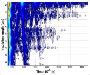

3.3 The effect of insulation in an insulated wire
To study the effect of insulation on propagating guided waves, as well as to confirm the findings in section 2, verification was required to confirm that there is only one wave mode present at the low frequency region. A number of experimental works were carried out for different lengths of insulation. The experiment started with a 1 meter insulated wire, the insulation was then gradually removed every 5 cm. This is shown in Figure 6, where L represents the length of the removed insulation. Throughout the experiment at 40 kHz, 5 cycles, tone burst signal was used. The results are shown in pitch catch form in Figure 7, where the x-axis shows the time of arrival for the signal, while the (y-axis) represents the insulation length. The results show that there is only one wave mode present at this structure. However, the presence of the insulation has decreased the inspection range. In addition, insulation imposes the effect of dispersion as well as increases the presence of attenuation of the wave.
Fig.6. An insulated wire with a gradual insulation removal
Fig.7. Wave propagation in a gradual insulation removal at a frequency of 40kHz

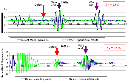

3.4 Correlation between experimental and modelling results
In order to validate the numerical modelling and the experimental results, the received signal in both the modelling and the experimental results were correlated against each other. The correlation is done on 20 kHz and 100 kHz on an insulated wire with the presence of a defect. The amplitude of the reflected signals were normalised with respect to the 1st reflection of the wire end. Figure 8 shows the correlation of the signals, there is a large degree of correlation between the modelling and the experimental results. However, there is an amplitude difference between the modelling and the experimental results. In addition, there is a velocity difference by 1.8% and 2.5% for the two frequencies, 20 kHz and 100 kHz respectively. These differences are due to the attenuation existing in the experimental conditions which is not included in the model, as well as the difference in the insulation loss representation in the model. The model can be improved by including attenuation and damping, and a better description of the defect.
Fig.8. Correlation between experimental and modelling results at two different frequencies 20 kHz and 100 kHz respectively

Finally, the experimentation and modelling results have shown a large degree of agreement with few variations. These variations are in part due to the electronic noise generated by the equipment used in the experimentation and also because the attenuation and damping have not been taken into account in the model.
