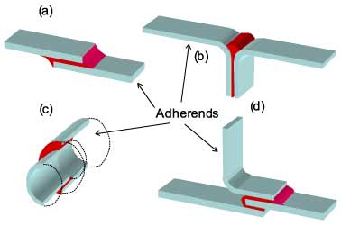

Sections of bonded joints are illustrated in Fig 1.1; the bonds may also curve to form non-flat, non-straight bond surfaces. In the figure the lighter parts are the parts being bonded (adherends), and the darker parts the adhesive.
Fig. 1.1. Examples of adhesively bonded joints
(a) simple lap,
(b) t-peel,
(c) tubular sleeve joint and
(d) a more complex joint.

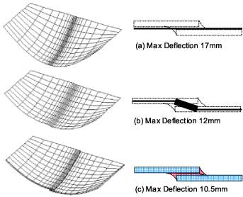

To model components using 3D solid meshes, it is usually impractical to include full geometric detail of the joints because the model size would increase to unmanageable proportions. Also many bonded components are made of sheet and hence are amenable to modelling with plates or shells. However, the adhesive is better represented with solid elements. It is not always easy or possible to combine the two types of element. Therefore the joints are usually simplified. At the lowest level the joint can be left out of the model; however, where an over-lap joint causes local thickening it is prudent to locally thicken the elements to represent the extra stiffening. This is illustrated in Fig 1.2, which shows models of a pressure-loaded panel. The model on which the example is based was much larger and a solid (brick) element model was impractical. Thickening the bond region in the shell model had a minimal effect on computation time but introduced stiffening to make the model more realistic.
Fig. 1.2. A simplified model of the floor of a bonded pressurised vessel. The floor has a lap bond along its centre and is simply supported around the periphery.
(a) shell model where the bond features are ignored,
(b) shellmodel with local thickening and offset and
(c) a solid element model.

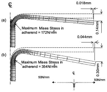

Some components can be modelled with 2D meshes (plane strain, axisymmetric etc); this makes model size considerations less onerous and any bonds can be explicitly modelled. Also detailed models of sections of the joint may be produced to investigate the influence of joint parameters. These models may also be produced to determine stiffness characteristics of the joint so they can be fed into a larger component model (super-elements or sub-structuring). Hence there are a number of reasons for making detailed models of the joints. This example illustrates an extreme case of how joint detail can influence the joint behaviour.
Figure 1.3 shows two half-symmetric models of a T-joint, the adhesive is on the centre-line. In (a) a small amount of adhesive spew is present between the radii (as in Fig 1.1(b)), and in (b) it is not present. This is the sort of detail that can easily change in production joints. The spew changes the load flow path across the joint, influences the joint stiffness and the stresses. It should be emphasised that these kinds of influences will be dependent on the relative stiffness of the adhesive compared to the rest of the joint and the boundary conditions.
Fig. 1.3. Two models of T-peel joints: both represent 2mm thick steel bonded with epoxy resin.
Model (a) has an adhesive fillet extending 1/ 3 of the way up the radius whereas model (b) lacks the fillet. The model (a) exhibits over double the stiffness of (b). Both meshes shown at x20 displacements.

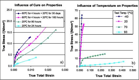

1.5 Material Properties 1: sensitivity
Even for some metals, reliable materials data to use in FEA models can be difficult to find. With adhesives the problems can be magnified ten fold! Often the properties are dependent on hardener-resin ratio, cure conditions, strain rate, water up-take etc. Obviously different materials are affected by different amounts and over different time scales. For instance most epoxies will be fully cured in a few days but some acrylic adhesives may carry-on hardening for many weeks or months. The effects of cure schedule and temperature on the stress-strain properties are illustrated in Fig 1.4. The dramatic change in strength and ductility with temperature of some adhesives is illustrated in Fig 1.4(b); large changes are often attributed to crossing the adhesive glass transition temperature.
For many materials only rudimentary property data are available, say from a manufacturer's data sheet. The analyst is further warned that such data can be misleading because it may be based on the bulk properties and not on joint properties. For instance the thermal resistance of an adhesive in a joint can be many times higher than the equivalent bulk material property would suggest because of porosity (entrapped gas) and/or contact resistance at the bonds. Another reason is that large samples of adhesive will cure differently to small amounts in a joint (eg exothermic reaction raising the temperature of adhesive castings during cure).
Fig. 1.4. Examples of stress-strain behaviour of adhesives.
(a) Influence of cure schedule for a hybrid acrylic-epoxy adhesive and (b) temperature dependence of an anaerobic adhesive.

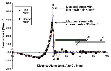

The implications of meshing decisions for solid models are more profound - more geometric details are being represented so the models are more sensitive to mesh detail. Mesh density is a first consideration. In general, for elastic analyses with small displacements, three nodes across the adhesive thickness will be adequate (ie two linear or one quadratic element). In the centre of the joint the elements can be surprisingly long (high aspect ratio) because the stress gradients are usually quite low, this is illustrated at A in Fig 1.6. Hence mesh refinement should be concentrated at the joint edges where the stress concentrations occur (but also see section 1.8). The level of refinement will have to be investigated and will be constrained by the objectives of the modelling and the available computer power.
Fig. 1.6. The predicted peel stress in a single lap-shear joint. Results from two solid models with different mesh densities are shown. Symbols indicate nodal positions and hence element density.
Note: the peel stress is that prising the adherends apart, normal to the bond-line
The second major consideration is the element type, of which there are many variations. At this stage the analyst is warned not to use triangular based elements in the bond-line, these elements have poor shear behaviour. Anyway the bond will usually be amenable to meshing with quadrangle based elements. For 3-D meshes, reduced integration elements can significantly reduce computer run time and still maintain accuracy; however, they do not work well when distorted so use them sparingly if large element distortions are expected (e.g. with rubbery adhesives). With rubbery adhesives that are almost incompressible ( ν ≥0.48), the analyst should consider using incompressible or hybrid elements.

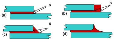

By modelling the joint ends are geometrically sharp, as indicated in Fig.1.7, material and geometric discontinuities can give rise to strain singularities. In elastic analyses the strain singularity have a related stress singularity. These singularities are 'theoretical' because the strains and stresses in real components cannot be infinite - but they can introduce problems that are real enough in the models. The phenomenon is covered in more detail elsewhere [3,6] .
The strains and stresses are calculated at Gauss points, which are located inside the elements, where they must be finite. The strains and stresses are then extrapolated to the nodes using the element's shape function. The shape functions are normally polynomials and infinite strains at the singular points cannot be attained. Therefore, refining the model's element density will only serve to change the reported strain at the singular point. Figure 1.6 illustrates this effect, further refinement would only increase the stress at B (as the mesh gets finer
Fig. 1.7. Representations of the adhesive fillet. (a) no fillet, (b) square fillet, (c) angled and (d) concave curved. The 's' indicates potential singularity points.
In elastic perfectly-plastic analyses, even if a strain singularity exists, the stress will be limited to the yield stress; but the yielding and its extent will depend on the reported strain which is mesh dependent. Hence there are good reasons for avoiding these singular points in models. In real joints the corners will not be perfectly sharp and singularities will not be produced. Furthermore some joints have corners rounded to lower the local stresses; the singular behaviour can therefore be eliminated from models, as shown in Fig 1.7(d). However the model geometry should have a physical basis or else the results will not reflect the real stresses.
