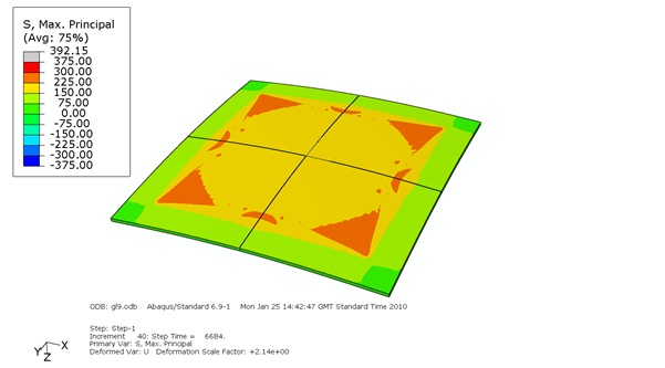

Figures 7 to 9 show the maximum principal stress field for three examples of different thicknesses of aluminium for the square design (0.35mm, 1mm and 3mm). It can be seen that there are two critical regions, namely, on the bottom surface and at the corners. Note that the strength of the alumina is around 300MPa therefore models showing red or grey are likely to result in tensile failure.

Figure 7 Predicted maximum principal stress field in model of square arrangement for 0.35mm thick aluminium - Top face showing relatively low stress levels
Figure 7a
Figure 7 Predicted maximum principal stress field in model of square arrangement for 0.35mm thick aluminium - Bottom face showing stress peaks in alumina
Figure 7b
Figure 7 Predicted maximum principal stress field in model of square arrangement for 0.35mm thick aluminium:
a) Top face showing relatively low stress levels
b) Bottom face showing stress peaks in alumina
