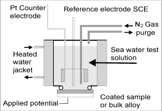

The corrosion behaviour of the coated test pieces was evaluated using an electrochemical test method similar to that described by the ASTM standard G61 for bulk iron and nickel based alloys. The coating surface was tested in the as-sprayed condition, immediately following a detergent wash, water rinse, acetone degrease and drying in air. The electrochemical corrosion test comprised of cyclic anodic polarisation in artificial seawater solution (3.5% NaCl)purged with nitrogen, with a pH of 8.2 and at a temperature of 25°C.
A 25x25mm coated test piece was clamped to the bottom of an Avesta-type cell arrangement, with a 1cm 2 diameter area of the coating in contact with a 250 ml volume of de-aerated seawater solution. The cell seal design allowed flushing with purified water to minimise crevice corrosion problems, associated with the cell edge contacting the coating. A schematic of the test cell is shown in Figure 1. After a stabilisation period of 2 hours, the corrosion potential was measured relative to a reference saturated Calomel electrode (sce). The coated sample was then anodically polarised from the corrosion potential ata rate of 10 mV.min -1, whilst measuring the corrosion current to a platinum counter electrode. On reaching a corrosion current of 10mA, the applied potential was reversed and scanned back down to the corrosion potential. A plot of corrosion current in mA from the 1cm 2 test area was obtained as a function of the applied potential (in mVsce).

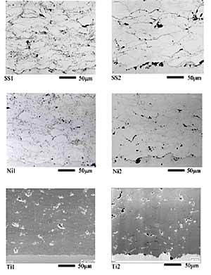

The measured porosity and oxide levels for coatings are given Table 2. These results show that coatings were prepared with low levels of porosity, at or below 5vol%. The actual levels of porosity are different for the three material types and depend on the powder size distribution used for each material. For the three coating materials, the smaller powder size range gave coatings with lower porosity. Similarly, the oxide level in each coating type is very dependent on the powder size range, with the smaller size giving a noticeably higher oxide content in the prepared coatings.

The stainless steel coatings had the lowest porosity levels at 0.9 and 1.5 vol% for the two powder size. Oxide levels in these coatings showed a wide range, from 0.8wt% (larger powder size) and up to 2.9wt% (smaller powder size).The measured level of porosity in the nickel alloy coatings was slightly higher at 2.2 and 2.5vol%, while the oxide levels were quite similar to those in the stainless steel coatings. The smaller powder size for the nickel alloy gave an oxide content of about 3.3wt%. The level of porosity in the titanium coatings was 2vol% with the smaller powder size and 5vol% with the larger powder size. The smaller titanium powder size produced a particularly high oxide contentin the coating, measured at about 11.7wt%, compared to 1.4wt% with the larger powder size.
Cross sections of all the coatings are shown Figure 2. These figures illustrate the lamella nature of the coating microstructures, with the deformed powder particles (splats) and inter-particle boundaries clearly visible. The figures also show the presence of oxide in the coating microstructures (dark contrast phase), and reveal that most of this oxide is located at the inter-particle boundaries. The stainless steel, nickel alloy and titanium coatings prepared with powders having the smaller powdersize contain higher amounts of oxide at the inter-particle boundaries.

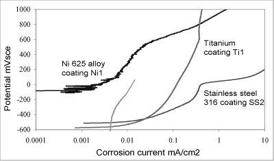

Values for the measured corrosion potential and corrosion currents at 100 and 400 mVsce are given in Table 2. Examination of these results reveal that for the three coating types, the stainless steel coated test pieces gave the highest corrosion currents, measured at 4.3 and 7.7 mA.cm -2 (100mVsce). The titanium coated test pieces exhibited corrosion currents an order of magnitude lower than those for the stainless steel coatings, measured at 0.15 and 0.69 mA.cm -2 (100mVsce). These values for corrosion current are quite high and well above the value of 0.01 mA.cm -2 usually taken to indicate the onset of localised attack (pitting or crevice). However, the lowest corrosion currents and least negative corrosion potentials were measured for the nickel alloy coated test pieces. Depending on the powder size used, these coatings had a corrosion current of 0.006 and 0.024 mA.cm -2, an order of magnitude lower than those for the titanium coatings. This result is also demonstrated by Figure 3, which shows a proportion of the forward scans for these coatings.
Fig. 3. Forward polarisation scans for coated test pieces
The results suggest that high quality, HVOF sprayed coatings of nickel alloy with composition similar to alloy 625 can provide significantly better corrosion resistance and consequently better protection of a steel substrate, than similar high quality coatings of stainless steel or even titanium.
This work also indicates that for the nickel alloy, a smaller size powder gives a coating with noticeably better corrosion resistance. For example, the nickel alloy coating prepared with the smaller sized powder (Ni1) gave a corrosion potential of -125 mVsce and a corrosion current of 0.006 mA.cm -2 (100mVsce), compared to -375 mVsce and 0.024 mA.cm -2 for the coating prepared with the larger particle size (Ni2). This improvement in corrosion performance is achieved despite the smaller powder size giving a much higher oxide content in the deposited coating. This is an interesting observation because it is often argued that higher levels of oxide formation are detrimental to good corrosion resistance. The oxide formation removes alloying elements, such as Cr, from the alloy material making it more susceptible to corrosive attack. Measured values of porosity are similar for the nickel alloy coatings prepared with the small and larger powder sizes. It appears that a smaller sized powder is able to produce a coating micro structure more resistant to localised corrosion attack, possible due to differences in the nature of porosity in the coatings or in the nature of the inter-particle boundaries.
Titanium in bulk form would be expected to show better resistance than nickel alloy 625 to localised corrosion in seawater. The results reported here show that a titanium coating (Ti1) with a reasonably low porosity of about 2%,achieved using the smaller size powder, did not produce a more corrosion resistant coating than a nickel alloy coating with similar porosity levels (Ni1). This may be due to the titanium coating containing much higher levels of oxide. For pure titanium, the formation of oxide will clearly not deplete the surrounding material of alloying elements (they are not present). The occurrence of the titanium oxide itself must be detrimental to the corrosion resistance of the alloy. When the level of oxide in the titanium coating was reduced, by using a larger powder size, the porosity in the coating (Ti2) increased to 5vol%. This coating showed an increase in measured corrosion current, possibly as a result of the higher porosity level that may have exposed the underlying substrate.

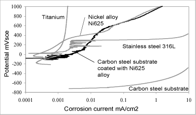

It is worthwhile comparing the corrosion performance of the best coating achieved in this work (Ni1) with that for the three coating materials in bulk form. Measured values for corrosion potential and corrosion current can be found in Table 2. A proportion of the forward scans obtained for the nickel alloy coating Ni1 and for stainless steel, nickel alloy and titanium in their bulk form, together with that for the uncoated steel substrate are shown in Figure 4. These results show that a Ni alloy coated steel substrate has a much lower corrosion current and consequently is believed to have better corrosion resistance than the uncoated substrate material. But, the corrosion resistance of the nickel alloy coating does not match that of the same nickel alloy in its bulk form. The nickel alloy coating gives much higher corrosion currents than the bulk nickel alloy, and has values slightly higher than those measured for bulk stainless steel (below its pitting potential). A steel substrate with a HVOF sprayed nickel alloy coating should be considered as having the ability to offer corrosion resistance similar to bulk stainless steel, but not that of bulk nickel alloy.

A steel substrate coated with HVOF sprayed nickel alloy may have the ability to offer corrosion resistance (in a seawater environment) similar to bulk stainless steel, but not that of the nickel alloy in bulk form.
