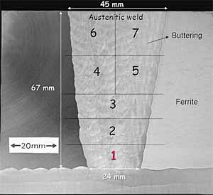

The crystallographic orientation of the entire weld cross-section at several lengthwise positions was mapped using EBSD. Figure 1 shows a macrograph of a dissimilar weld. The weld was sectioned into 7 zones for scanning by EBSD; this paper will make use of the weld structure in zone 1, the weld root.
Fig. 1. An austenitic weld showing the buttering and cladding layers, and the section zones for EBSD scanning

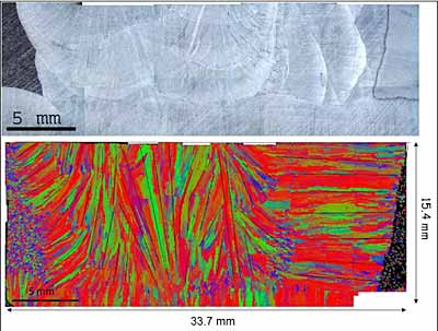

For scanning the weld map cost effectively through EBSD the spatial scanning resolution must be established. The scanning resolution impacts on the time taken to generate the map: scan of an area ~4mm2 at a resolution of 5µm takes ~6 hours whereas the same area at a resolution of 40µm takes only 6 minutes. The transducer frequency was set at 2MHz generating a longitudinal wave with a wavelength of ~3mm. Assuming the dominant Rayleigh scattering mechanism[1] the wave would be sensitive to a minimum scatterer size of 300µm, ie 1/10 of the wavelength. Hence a scanning resolution of 40µm was deemed sufficient to capture significant regions within the weld.
The second important parameter to establish is termed the misorientation angle. The EBSD data is represented as a colour map where each colour corresponds to a particular orientation of the crystal structure with regard to the sample coordinate system. The orientation of the crystals can be expressed in terms of the three Euler angles[5] which are rotations performed in a specific sequence to transform the sample coordinate system onto the crystal coordinate system. The misorientation parameter is used to define the position of the grain boundaries, ie the higher the parameter the smaller the numbers of grain boundaries. Establishment of this parameter is an ongoing activity and is subject to modification due to both experimental validation results and parametric modelling studies of significant orientation mismatches across boundaries. On the first iteration, the misorientation parameter was again set using the Rayleigh scattering assumption, ie the misorientation angle is that which leads to the size of the regions in the path of the propagating wave being no less than 300µm, the minimum scatterer size. An advantage of the misorientation parameter, unlike the scanning resolution, is that any value can be chosen post-scanning, as it is applied on the collected data to generate the maps.
Figure 2 shows the macrograph of zone 1 and the associated EBSD map, where faint black lines within the scan map illustrate general orientation of homogeneous regions. Firstly, note the impact of different deposition procedures for the weld and the buttering, where the buttering was applied prior to flat 1G position manual deposition of the weld. Secondly, the grains appear to grow through several deposit runs leading to the characteristic columnar grain structure observed in austenitic welds.
Fig. 2. The macrograph of zone 1 and the associated EBSD orientation map; scanned at a resolution of 40µm and processed with a misorientation parameter of 20°

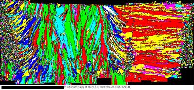

The weld map, however, had excessive boundaries for cost effective expression within the model (see section 3.2). Hence a processing method was devised termed 'orientation unification'. In this technique several dominant orientations are identified within the weld map shown in Figure 2. Subsequently, an angular spread of between 15 and 20° either side of the dominant orientation is set to be equal to the dominant orientation; all other regions (and those smaller than the minimum scatterer size) take the nominal orientation of the grain or that of the parent. In addition, the Euler angles (referenced to the axes of the unit cubic cell) are transformed to the rotation angles following the rotation sequence adapted by the simulation program. Figure 3 shows the processed weld map ready for input to the ultrasonic models and Table 1 shows the ten selected dominant orientations for zone 1. The development of the orientation unification technique is ongoing and is subject to feedback from experimental validation trials.
Fig. 3. Processed weld map for input to the models; the ten dominant orientation regions are detailed in Table 1
Table 1 The ten dominant orientations selected for the weld map of zone 1; the crystallographic orientations are expressed as three rotation angles about the x, y and z axes of the component reference frame, as required for ultrasonic modelling.
Colourα(°) (rotation about x)β(°) (rotation about y)γ(°) (rotation about z)
Red 0 0 0
Blue 0 0 45
Lime Green 318.72 6.37 193.09
Yellow 12.55 28.25 18.91
Cyan 8.17 4.52 338.91
Brown 30.81 -13.41 29.96
Pink 348.11 -22.77 177.97
Green 21.73 -1.78 8.36
White 351.5 -22.86 138.12
Black 19.95 -1.16 56.60
The elastic stiffness of the various mapped regions of the weld has to be determined to model the propagation of a stress (ie sound) wave. In a previously reported approach,[6] a thin sample from a region of the weld containing columnar grains oriented in the same direction was removed. The stiffness was then evaluated using through-transmission experimental measurement of ultrasonic velocities. The weld was then discretised into regions where the grains had similar orientations, the assumption being that the solidification direction along the [100] axis is in the orthogonal plane to the welding direction, and that all the homogenized regions of the weld contain similar columnar grains such that the weld can be described using just the angle of the columnar grain orientation. [6]
Figure 3 shows that the weld and buttering consist of grains of differing crystallographic makeup, hence the EBSD map offers the possibility to describe the weld in its full three-dimensional state. The stiffness is evaluated using a single-crystal of the weld alloy grown through a casting process. The velocity of the longitudinal and the two polarized shear waves along [100], [110] or the [111] are related, by Newton's law of motion and Christoffel's equation, to the stiffness of the cubic crystal. The results presented in this paper make use of the cubic stiffness constants measured on an alloy of similar composition to the weld presented in Figure 1 using velocity measurements in a single-crystal.[7] The measured stiffness constants are C11=203.6GPa, C12=133.5GPa and C44=129.8GPa.

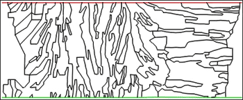

The weld map of Figure 3 was processed using a digitizer to generate a 2D CAD drawing.[4] The boundaries were manually identified according to the criteria of minimum scattering regions/distances. Figure 4 shows the expression of the zone 1 weld cross-section within the CIVA model, containing 89 closed regions leading to a total of 1276 boundaries. The weld cross-section is extruded to create the three dimensional component, ie assumes that the weld structure is uniform along the welding direction.
Fig. 4. The CAD drawing of the zone 1 weld cross-section input into the CIVA model. The drawing consists of 89 closed regions with a total of 1276 boundaries

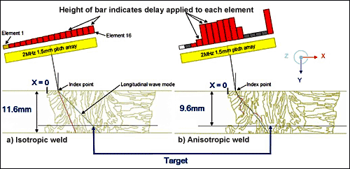

The CIVA model is used here to illustrate the distortion induced by the microstructure onto the sound field. In all the results presented in this paper a 2MHz linear phased array probe with a pitch of 1.5mm is used in the inspection simulations. Figure 5(a) shows the ray trace of a 16 element array generating a 45° longitudinal wave beam (green trace) and associated shear beam (red trace) within zone 1 of the weld, when all the regions in the weld take the stiffness value of the parent austenitic, ie the weld is isotropic. Note that the array is not programmed to focus the sound field, only steer. Figure 5(b) shows the ray tracing of the sound beams when the full anisotropic weld structure is input, ie each region takes the set dominant orientations. The distortion due to the microstructure is illustrated by the ray tracings which are no longer straight; note that the red shear wave of Figure 5(a) becomes two orthogonally polarized shear wave components in the three-dimensional anisotropy of the weld in Figure 5(b).
Fig. 5. Ray tracing of a 2MHz 16 element array with a pitch of 1.5mm programmed to generate a 45° beam within
a) an isotropic weld and
b) anisotropic weld measured by EBSD. The array was inclined at 10° to the horizontal and is in immersion with a water path of 10mm
The bars above the array associated with each element represent the delay applied to each element. The delay law applied for the isotropic weld in Figure 5(a) dictates that the first element fires first followed by successive firing of the adjacent element up to element number 16. Hence the delay of elements 2 to 16 are relative to element 1 which fires at time equals zero. In Figure 5(b) the CIVA model has used the criteria of generating a longitudinal beam at 45° to set the delay law such that only those elements which contribute to the goal are activated, ie elements 1, 2, 12, 13, 14 and 15 are turned off. Note, however, the microstructural condition does not appear to allow optimisation of the delay law such that the longitudinal ray trace passes through the same target point as in the isotropic medium.

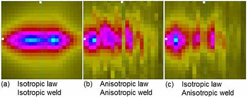

The beam sections in the x-z plane 9.6mm from the surface (see Figure 5) are evaluated using the CIVA model; Figure 6 shows the results of the three cases which were considered. Note that the index point of the sound incident on the surface of the component was at x=3mm (see Figure 5). Figure 6(a) presents the beam of the case shown in Figure 5(a), ie the weld is isotropic and the beam is generated using the isotropic delay law, and the beam profile is as expected. Figure 6(b) represents the case shown in Figure 5(b), ie with the anisotropic weld properties included and the delay law calculated by CIVA to propagate the beam. The distortion due to the microstructure is revealed by the output and the maximum amplitude of the beam in Figure 6(b) is 27dB less than the isotropic case shown in Figure 6(a).
Fig. 6. Beam sections calculated in the x-z plane at depth of 9.6mm from surface for:
a) isotropic delay law for an isotropic weld
b) anisotropic delay law calculated by CIVA for an anisotropic weld and
c) the isotropic delay law applied for an anisotropic weld
A further case was considered, shown in Figure 6(c), where the isotropic delay law shown in Figure 5(a) was used to generate the sound and propagate it within the anisotropic weld. The loss in signal amplitude in the case shown in Figure 6(c) was only 19dB less than the isotropic case. Hence, turning off elements in the array when generating the delay law (ie the anisotropic delay law generated by CIVA for the case shown in Figure 6(b)) reduces the amount of energy coupled into the weld, which would in turn impact on the S/N performance of the inspection.

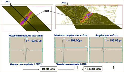

A simulation of using the 2MHz 16 element probe to scan the weld along a line from x=-5mm to x=9mm with a resolution of 1mm was performed. A 3mm diameter side drilled hole (SDH) target was introduced at a depth of 9.6mm, ie where the beam sections of Figure 6 were evaluated. Figure 7 shows the results of the simulated scan.
Fig. 7. A simulated scan in CIVA from an index point of x=-5mm to x=9mm. A 3mm SDH was introduced at a depth of 9.6mm from the surface in an isotropic medium (left) and in the anisotropic weld (right)
In the isotropic case of Figure 7, the 45° beam is directly incident on the SDH at an index position of x=3mm giving the largest signal amplitude. However, in the anisotropic case the maximum signal amplitude was received at an index position of x=9mm, which is 19dB below the signal received from the target SDH in the isotropic case (see Figure 7). In fact, at x=3mm in the anisotropic case shown in Figure 7, the signal strength was 13.6dB weaker than at x=9mm in the same case. Note that the model only resolves the interaction of the sound field with the SDH target, ie no boundary interactions are evaluated, such that no back scattered noise signals are predicted.
In summary, the observed errors in plotting signals from flaws due to the distortion of the sound field by the microstructure of austenitic welds is predicted by the CIVA simulation platform. In the ongoing project, the predictions of the CIVA model are being validated with experimental data and the effectiveness of the EBSD route to quantify the microstructure will be assessed. The main aim of the project, however, is the development of strategies to overcome the distortion induced by the microstructure.

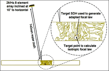

This simulated time reversal concept for generating adapted focal laws is illustrated using zone 1 of the weld (shown in Figure 1), its anisotropy quantified by EBSD (see Figure 3) and expressed within the CIVA simulation platform. A 2MHz linear array with 8 elements at a pitch of 1.5mm is coupled to the model description of zone 1 of the weld in immersion testing. The probe was inclined at an angle of 10° to the horizontal and the index point of the probe was set to x=2mm (see Figure 8). In the first case, a water path length of 140mm is selected to place the SDH target very close to the range of the natural near-field point (end of the Fresnel zone) of the array.
The simulation shown in Figure 8 is used to first illustrate that the concept of generating the delay law through received signals from the target SDH (ie the adapted law) is sound, since at the near-field range its performance should be similar to that of the calculated law. Secondly, the simulation is used to study the sensitivity of the received signal amplitude in two different scenarios: (1) the null-point of the wave, where the arrival phase of all waves is at zero amplitude, was chosen as the reference to generate the adapted delay law, and (2) the adapted law generated was reversed without taking into account the pulse-echo nature of the travel time. Both these scenarios illustrate the degree of S/N performance change that could take place due to the nature of the delay law used when inspecting an anisotropic weld, as well as the precision available in the simulation platform.
Fig. 8. Simulation of the anisotropic weld inspection with a 2MHz linear array of 8 elements at a pitch of 1.5mm, inclined at 10° to the horizontal with a water path of 140mm; the index point of the probe was set to x=2mm
The isotropic delay law was calculated by ensuring that the sound energy from all 8 elements arrives at the target point (see Figure 8) at the same time and in phase to constructively interfere for maximum sound pressure; the algorithm used was termed 'single point focusing' in the CIVA model. The adapted focal laws were not calculated mathematically. Each element of the array was fired and received on within the simulation, recording the reflected signal from the target SDH shown in Figure 8, while all other elements were turned off. Each element, due to its small size, would generate a widely divergent beam and the model evaluates the interaction of this beam front with the SDH after traversing the anisotropic weld. Due to the distortion induced by the microstructure, sound energy emanating from different points (ie elements) on the array will take different paths to the SDH. This is shown in the A-scan signals from the SDH due to the 8 elements where the arrival times are offset with respect to each other, as shown in Figure 9, and the non-uniformity of the offsets suggests that it is induced by a phenomenon in addition to the difference in the geometrical direct line paths to the target SDH. Figure 9 also shows the difference in received signal amplitude with respect to that of element 1, illustrating the degree to which the microstructure influences the propagation of sound energy within the weld. The amplitude results imply that each element will impart differing amounts of sound pressure to the composite wave front generated at the target region; hence some elements are more influential than others towards generating high sound pressure amplitudes for any given microstructural path.

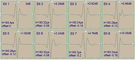

Fig. 9. A-scans from each of the 8 elements collected independently of all others. The arrival times are shown, with their offset from element 1, along with the change in received amplitude relative to element 1

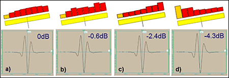

The simulated arrival times to the target are used to generate the adapted focal law, following the same criteria as for the calculated focal law (assuming an isotropic weld): the wave fronts must arrive at the target at the same time and in phase to maximise the sound energy. The isotropic and adapted focal laws applied to the 8 element array are illustrated in Figures 10(a) and 10(b), respectively, along with the resultant echo signal from the SDH target. In addition, the results from the two scenarios described earlier are shown in Figure 10(c) and 10(d).
Fig. 10. Illustration of
a) calculated focal law assuming isotropic conditions
b) adapted focal laws generated through simulation
c) adapted focal law generation using the null-point of the received signal as reference and
d) incorrect adapted delay law, applied in reverse to the array without accounting for pulse-echo travel path
The adapted law (Figure 10(b)) showed similar performance to the calculated law (less than 1dB) at the near-field range, which is at the edge of the range at which the delay laws begin to impact on the S/N performance. The sensitivity of the received signal to changes in the applied delay laws of less than 0.1µs (shown in Figures 10(c) and 10(d)) illustrate the level of change in S/N performance that could be observed even at the edge of the applicable envelope (ie the near-field range).

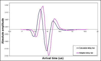

Figure 11 shows the received signal from the SDH when using the calculated and adapted delay laws, where the amplitude of the received signal using the adapted delay law was 1.7dB greater than when using the calculated delay law. The case presented here was at a single incident position and a specific microstructural conditions but the concept of adapting the focal laws to the microstructure of the weld could potentially lead to significant improvement in S/N performance.
Fig. 11. Received signals from the target when using the calculated and adapted delay laws; the signals are offset in time with the signal due to the adapted law being 1.7dB higher

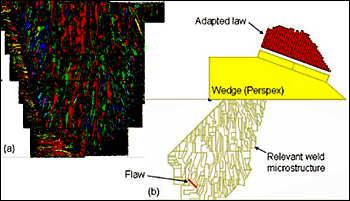

Figure 12 shows a further case with an 85mm thick austenitic weld which contains a rectangular flaw near the root, above the buttering. Figure 12(a) shows the full EBSD scan of the weld and Figure 12(b) shows the processing of the weld into the model along with the inspection scenario. Note that only the 'relevant' part of the weld is used in the model, ie the material through which the sound will propagate to the flaw; by not evaluating the sound propagation over the full description of the weld the computing times can be reduced significantly.
Fig. 12. The inspection scenario on an 85mm thick austenitic weld, showing the adapted delay law generated for a 32 element linear array on a Perspex wedge designed to generate longitudinal waves;
a) shows the full weld map using EBSD and
b) shows the relevant part of the weld processed into the model
The inspection was simulated using a 32 element linear array on a Perspex wedge optimised for generating longitudinal waves. The calculated delay law was designed to focus the sound at the depth of the flaw assuming that the weld is isotropic; the adapted delay law was generated as described above. In the simulation, the probe and wedge were moved a distance of 14mm (with 1mm resolution) on the surface such that the beams traversed the area of the flaw. The resultant B-scan due to the simulated scanning is presented for three distinct cases in Figures 13, 14 and 15.

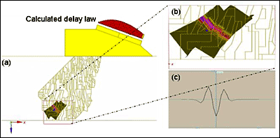

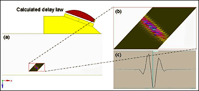

Figure 13(a) illustrates the case where the weld was absent, ie the medium was isotropic, taking nominal value for the longitudinal wave velocity in stainless steel (5750m/s). The delay law was calculated to focus the sound energy to the center of the flaw and, as shown in Figure 13(b), the maximum signal was plotted near the flaw center. The simulated time of flight for the maximum signal on the flaw center was 46.26µs (Figure 13(c)).
Fig. 13. The inspection scenario where the anisotropic weld was absent;
a) shows the case with the calculated delay law
b) shows the plotted signal and
c) show the A-scan at flaw center

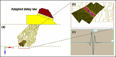

Figure 15(a) illustrates the case with the anisotropic weld introduced and where the adapted delay law was generated using the time reversal concept for each element of the array. Figure 15(b) shows the simulated results where the signal maximum plots <1mm from flaw center and the signal strength is nearly 2dB higher in comparison to the maximum signal strength of the case shown in Figure 14. The simulated time of arrival of the signal on flaw center was 45.43µs (Figure 15(c)), which is 0.84µs later than in the case of Figure 14, illustrating the degree of distortion imparted by the weld medium. Clearly, the simulation results then illustrate the degree to which positioning errors can be reduced, in addition to gains in S/N, when the delay law is appropriately adapted for the medium.
Fig. 15. The inspection scenario where the anisotropic weld is introduced and the adapted delay law was used instead of the calculated one;
a) shows the case with the adapted delay law
b) shows the plotted signal with positioning error <1mm and
c) shows the A-scan at flaw center
