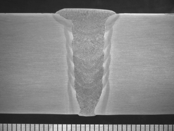

The centre-hole air abrasion drilling method (8) was used for residual stress measurements near surfaces, with the holes located at either the weld cap toe or the weld root toe, which are typical fatigue crack initiation sites. a total of eight measurements were performed on three ring samples (ring ID: 1, 5 and 6), each being 0.9m long. for ring 1, four measurements were carried out: weld cap and weld root at both weld start and stop positions. For rings 5 and 6, the measurements were carried out at a position 60o from the weld start position, Figure 2. The results are presented in Table 3. The following can be seen from the table:
Residual stresses in the hoop direction (parallel to the girth weld) were very high, the largest being about 90% and 64% of the yield strengths of the base and weld metals, respectively. The levels of the residual stresses at the weld start and stop positions were higher than those at other positions. At both the weld start and stop positions, the residual stress was markedly higher at the weld root than at the weld cap.
FIGURE 1 Macro-sections of the girth welds in the 16 inch and 20 inch pipes: a) 16 inch
FIGURE 1 Macro-sections of the girth welds in the 16 inch and 20 inch pipes: b) 20 inch

It can be seen from the macro-sections of the girth welds in Figure 1, the 20 inch girth weld was completed in eight passes while the 16 inch girth weld was completed in seven passes. Each pass was completed in two separate welds. The first weld laid down the pass on one side of the pipe from the start to the end 180° away. The second weld started and ended at the same location on the pipe, traveling in the opposite direction.
