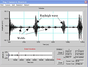

The results were very encouraging. The far end of the pile was clearly seen and the holes were readily detected. Clear signals were also observed from each of the nine circumferential welds. A typical result is shown in Figure 6.
Fig.6. Result from a test on a full scale pile. The far end signal may be seen on the right hand side
The pile end signal may be seen on the right hand side of the trace. However, the most significant feature of these tests was the presence of high amplitude Rayleigh waves which were propagating around the circumference of the pile at the top end. These waves appeared to be generated from each end of the array and were virtually impossible to dampen. Rayleigh waves at megahertz frequencies are readily damped by placing a layer of a substance such as grease on the surface. However, this was ineffective in this case. There were also issues of coupling of the individual transducer elements. Differences in efficiency between the elements produced non-optimum conditions for array performance and affected the focusing and steering behaviour. Consequently, it was decided to conduct a thorough investigation of the array characteristics and coupling effects.

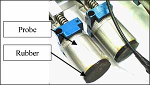

4.2 Improving coupling consistency
In order to improve the consistency of transmission of the wave into the component, some coupling medium has to be used. The most suitable for this application is to use dry coupling by adding a soft material such as neoprene rubber to the face of the transducers (see Figure 8). This reduces the difference of acoustic impedance across the interface and thus allows a better transmission of the wave between the probes and the material under test. A study was carried out into the transmission of the ultrasonic energy for different surface roughnesses. It was shown that for a roughness above an Ra value of 3µm, the transmission coefficient is low, and that the transmission is better at lower frequency.
Fig.8. Rubber coupling layer

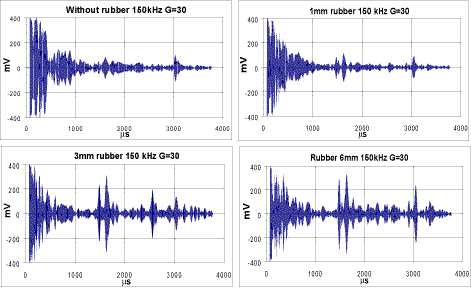

In order to see the effect of the rubber on the output signal, some experiments using different thickness of rubber were carried out (see Figure 9):
Fig.9. A-scans, different thickness of rubber
For each A-scan, the Signal-to-Noise ratio (SNR) was calculated, see Table 1:

It may be seen from Figure 9 and Table 1 that the presence of rubber decreases the transducer ringing and thus improves the quality of the signal. Also, the amplitude of the signal increases considerably with the thickness of rubber. However, the amplitude of the noise behaves in the same way. It may be seen that the signal to noise ratio is maximum when 3mm rubber was used. Therefore, this thickness of rubber was adopted for the experiments.

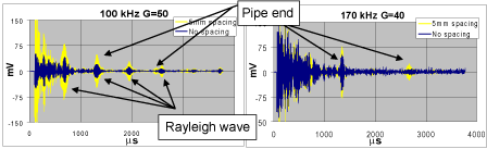

4.3 Rayleigh wave suppression (spacing of the array)

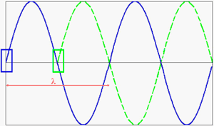

As found in the field tests on the full scale piles, the linear array also generates Rayleigh waves propagating around the end of the pipe. The Rayleigh wave is a non dispersive surface wave propagating with a velocity slightly less than the shear wave (about 2970 m.s-1) in a steel material. This wave is of high amplitude and can thus hide the other peaks which may appear. One way to cancel this Rayleigh wave is to space the transducers in the array at half the wavelength of the Rayleigh wave, see Figure 10.
Fig.10. Cancellation of the Rayleigh wave
The Rayleigh wave component generated by the first transducer is cancelled by the out of phase wave from the second transducer when the spacing is λ/2. Thus, for a given frequency, the spacing between the transducers (in order to cancel the Rayleigh wave) may be calculated, Table 2 presents the optimum spacing between the transducers, depending on the frequency:
Table 2. Optimum transducer spacing with frequency
Frequency (kHz) 50 60 70 80 90 100 110 120 130 140 150 175 200
λ (mm) 59.4 49.5 42.43 37.13 33 29.7 27 24.75 22.85 21.21 19.8 16.97 14.85
λ/2 (mm) 29.7 24.75 21.21 18.56 16.5 14.85 13.5 12.38 11.42 10.61 9.9 8.49 7.43
The minimum spacing between two transducers is 25 mm, as at this point adjacent elements touch each other. It may be seen from Table 2, this distance is optimum at 60 kHz. Above this frequency, it is impossible to reach the optimum spacing, so it is not possible to suppress the Rayleigh wave by this method at the frequency of interest for the small scale mock-up, which is at around 150kHz.
However, the observed results were not as bad as the predictions in Table 2 would suggest. This may be explained by the fact that most of the energy of the Rayleigh wave is concentrated within one wavelength of the surface. Using a high excitation frequency increases the concentration of the energy in the wave near the surface, so that the Rayleigh wave component is more highly attenuated than at lower frequencies. The effect of this is shown in Figure 11. At 100 kHz the amplitude of the Rayleigh wave is high, with repeat echoes being observed which correspond to the wave travelling around the pipe circumference at the end. The first reflection of the pipe end is hidden behind the peak of the Rayleigh wave at approximately 1300 µs. At 170 kHz, the Rayleigh wave is not present and the reflections from the pipe ends may be clearly seen.
Fig.11. A-scans, influence of the frequency on the Rayleigh wave

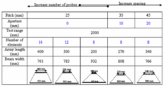

A study was made of the key parameters of the array which affect divergence of the beam. These are: the number of transducers, the spacing between them (see Figure 13) between their centre (Pitch) and their edge (Aperture), the frequency, the velocity of the wave, the material under testing, the couplant and the focus distance.
Fig.13. Spacing between transducers
A number of different arrangements of transducer elements were considered. Table 3 presents the results for different spacing between the probes and for a different numbers of elements. The width of the beam was calculated at a range of 2 metres from the transducer.
Table 3. Influence of the spacing and the number of probes on beam width at 2m.
These results show that the principal influence on the divergence is the width of the array. The number of transducers does not affect the beam geometry, provided that they are close enough to act as a single array.

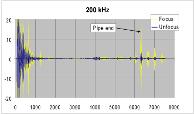

Nevertheless the beam width is large for all cases studied and over the whole length of the pile there would be insufficient lateral resolution. It was therefore decided to use a delay profile in the signals applied to each of the transducers in order to focus the beam. In fact a number of measures were used to achieve enhanced beam characteristics. These were:
  • Increase in frequency to 200 kHz (f x t = 2 MHz.mm) to reduce the Rayleigh wave component, and to reduce the divergent angle (which is proportional to frequency)
  • Application of the delay profile to concentrate the energy,
  • Use of the smallest array length (200mm) to start with the narrowest beam.
The results are shown in Figure 14. The dark trace is the unfocused signal. The reflection from the far end of the 8.18m long 22" pipe may be seen at approximately 6300µs. The pale trace is the focused result (the focus was at the pipe end). It may be seen that there is an increase in amplitude of 14.5dB (a factor of 5) when the beam is focused.
Fig.14. A-scan, focusing test
These design principles are now being applied to the array geometry for the full scale tests and the procedures are being based on the focusing regime demonstrated on the small scale specimen.
