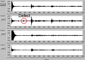

The F3 mode was successfully generated on the head as shown in Fig.4(b). In this experiment, a 1mm saw cut defect has been introduced to the rail head. This defect is located at 4.46m from the position of the piezo-elements arrays, as shown below in Fig.4(a). According to the theory, the saw cut defect should be represented on the A scan by a peak at 2877m/s. The experimental data in Fig.4(b) shows that the signal from the defect arrives at 2834m/s. This clearly shows good correlation.
Fig.4a) 2mm depth defect on the railhead
Fig.4b) Results obtained with a 2mm saw cut defect on the railhead
