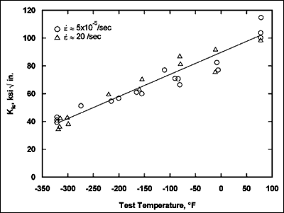

Early investigations (e.g. Ref.19, 20 ) focused on the effect of strain rate on the plane strain (brittle) fracture toughness K Ic, noticing especially that an important effect of loading rate is the shifting of the fracture toughness transition curve to higher temperatures, and that this shift is dependent on the strength of the steel, higher shifts being generally obtained for lower strength steels. Figure 9 depicts this trend for ABS-C and 18 Ni marageing steels (yield strength approximately 270MPa and 1700MPa, respectively). The ABS-C steel ( Fig.9a) exhibits marked loading rate sensitivity (the 40 ksi √in ( ≈ 44MPa √m) transition temperature is shifted by about 170°F ( ≈ 100°C)), whilst there is no shift for the very high strength steel ( Fig.9b).
Fig.9a. Effect of temperature and strain rate on crack toughness of ABS-C steel [19]
Fig.9b. Effect of temperature and strain rate on crack toughness of 18Ni (250) maraging steel [19]
