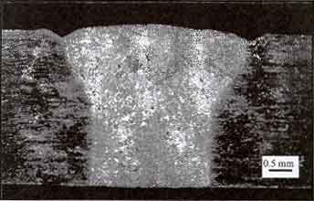

Several of the alloy/laser combinations showed the characteristic 'wine glass' shape often found in laser welding. An example is shown in Figure 1, a Nd:YAG laser weld in 2219 material. Two types of heating take place during laser welding. One is the absorption of laser light from the keyhole, which releases heat throughout the thickness of the material and tends to create a parallel sided weld. The second heat source is the plasma above the weld, which absorbs and re-emits laser energy to create a hemispherical weld centred near the surface of the sheet. The observed weld shapes are affected by the balance between these two heat sources. [6]
In Figure 1, the rolled microstructure of the parent plate can be seen as can the very fine microstructure of the weld bead. Small round pores are present and are more common in the lower part of the weld. This autogenous weld shows only a small amount of undercutting due to gap filling and some losses through evaporation and splatter.
Fig. 1 - Cross sectional weld shape of pulsed Nd:YAG laser welded 2219 aluminium

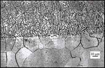

Figure 2 shows a plan view of the edge of a weld in 8090 made with the continuous wave Nd:YAG laser. The weld metal, to the top of the image, shows the very fine growth structure in comparison, to the base metal. The growth type in these welds was mainly cellular-dendritic, with dendrite arm spacings, (where visible) of 5 µm or less.
Fig. 2 - Top section of fusion line of continuous wave Nd:YAG laser welded 7475 aluminium
A thin white layer is evident at the fusion line. In this region, the temperature gradient is high. As the laser approaches and passes, the parent material melts back and then begins to solidify, giving very low growth rates at the very edge of the weld. The growth rate then increases slowly, depending upon the shape of the back of the weld pool. Thus the temperature gradient/growth rate ratio is very large and this causes the initial stages of growth to be planar. The rejection of solute that occurs as this solidification starts results in an initial layer of weld metal that is free from second phase particles; it is this layer that is visible at the fusion line.
In the base metal, in the lower half of Figure 2, clear evidence of constitutional liquation can be seen. The dark lines along the grain boundaries are areas where melting has occurred. These are only present close to the fusion line where temperatures approach the bulk solidus and are above the local solidus. This evidence of constitutional liquation was seen in all alloys, but most clearly in the 7475 and 8090 alloys. In these parent materials, the composition is not homogeneous on a micron scale, with variations in composition within primary α grains and regions at grain boundaries where larger amounts of alloying elements are present, and so lower the local melting point. [7]
The behaviour of the liquated regions depends upon the thermal cycle and upon diffision of the solute materials into the grains. The narrow width of the films (<1 µm in this study) means that the diffusion distances involved are short and it has been suggested that diffusion has a controlling effect upon the behaviour and persistence of these films. [8]
These liquid films can act as initiation points for cracking. While no liquation cracking was observed in the current study, if the hot cracking was reduced, for example by the use of appropriate filler wires, then liquation cracking may become a difficulty in these alloys.
