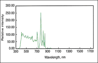

Fig. 1. TIG welding arc spectrum, 150A, argon shielding gas
The main difficulty in vision-based systems is to eliminate the high intensity arc light, which prevents good visibility of the weld pool. Figure 1 shows the broad spectral response of arc light emitted by TIG welding on stainless steel. The spectrum ranges from the ultraviolet at about 350nm through the visible region and into the infrared at about 850nm. In this vision system, a narrow band-pass filter has been placed in front of the camera to eliminate the arc light.[1] This filter only allows light of limited wavelengths to pass through. In this case, the filter is chosen for a wavelength where the arc light intensity is low. However, the band-pass filter darkens the image, making it difficult to see the weld. By adding an illumination source, an overall view of the welding area can be obtained.[2,3,4] The wavelength of the emitted light must be in the same range as the band-pass filter. This can be achieved using a laser light source. Figure 2 shows the effect of the band pass filter with the laser light source. The result of this combination is a much attenuated arc light with a dominant laser light which illuminates the weld pool and its surroundings.
