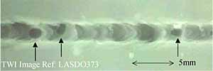

Autogenous Nd:YAG laser welding. Full penetration in the 6.35mm thickness plate was achieved using either a laser spot diameter of 0.45 or 0.6mm. Due to a two-fold reduction in power density between the 0.45mm and0.6mm spot sizes, a three-fold reduction in welding speed was required to obtain full penetration in the latter case. Moreover, that penetration was not consistent over the entire length of the 300mm long test weld. Therefore,autogenous welding with the 0.6mm spot was not pursued further. With the 0.45mm spot, consistent penetration was achieved, but with poor internal weld quality. Welds contained a number of irregularly shaped cavities, in addition to spherical gas porosity. Cavities, as seen in Fig.1, are associated with momentary keyhole collapse. Collapse occurs when a fluctuation in the keyhole leads to a transient imbalance between the metal vapour pressure holding the keyhole open and the metallostatic pressure of the surrounding weld pool trying to close the keyhole. [3] It is thought by the authors that for any given fluctuation in the keyhole, the narrow diameter keyhole in the case of the smaller spot size could be more likely to close than in the case of the larger diameter keyhole with the larger spot size. The slower welding speed and longer solidification time in the latter case may also allow more time for any associated porosity to escape.
Fig.1. Radiograph of autogenous Nd:YAG butt weld in 6.35mm thick 7xxx plate, made using a 0.45mm diameter focussed spot, showing presence of coarse cavities (arrowed) associated with keyhole collapse duringwelding

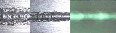

Hybrid Nd:YAG-MIG welding. Lack of consistent penetration and slow speed again precluded a 0.6mm laser spot size as a viable process option. The 0.45mm spot size in the hybrid configuration did, however, achieve an internal weld quality that was free of the cavities observed in the corresponding autogenous welds, as shown in Fig.2. This could be due to the larger weld pool size in the hybrid technique, and hence slower solidification time and easier passage of porosity out of the weld pool prior to freezing. Some finer porosity was still present in these welds, however.
Fig.2. Top bead photograph (left), under bead photograph (centre) and radiograph (right) of hybrid Nd:YAG laser-MIG butt weld in 6.35mm thick 7xxx plate made using a 0.45mm diameter spot

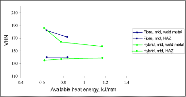

Before considering the implications of non-uniform weld metal composition through thickness, Fig.5 shows the variation with heat input of minimum hardness values after proprietary post weld heat treatment (PWHT) for both Yb-fibre laser and hybrid Yb-fibre laser-MIG welds, from mid-thickness positions, in both the weld metal and the HAZ. The softest material was weld metal in both cases. Heat inputs were generally higher for the hybrid welds, from the additional heat input introduced by the MIG arc, in spite of faster welding speeds used. Fig.6 shows hardness profiles for both types of welds, using the optimum heat input consequently determined, measured transverse to welding direction. As Fig.6 shows, the weld metal hardness values towards the weld top and in the mid-thickness of the hybrid weld were very similar, indicating that the non-uniform weld metal composition, as shown previously in Fig.4, was not likely to significantly affect mechanical properties measured at different thickness positions. The ratio of the minimum hardness in the weld metal to the parent material hardness as a percentage was between 65and 70%.
Fig.5. Variation of minimum hardness values with available heat energy for Yb-fibre laser and hybrid Yb-fibre laser-MIG welds, after PWHT, from mid-thickness positions, in both the weld metal and the HAZ

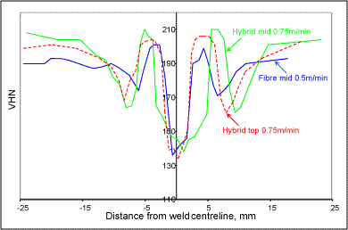

Fig.6. Transverse hardness profiles for Yb-fibre laser and hybrid Yb-fibre laser-MIG welds, after PWHT, showing mid-thickness profiles for both weld types, and also a profile towards the top of the weld for the hybridweld

  • The properties of the HAZ of the two weld types were very similar, which contrasts to the measurement of a softer HAZ in the hardness profile from the hybrid weld. In both welds the HAZ had higher strengths and larger elongations than the corresponding weld metal.
