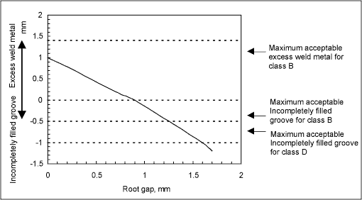

The same conditions developed on zero-gap butt joints were used for completing welds with a varying gap (0mm gap at the start and 2.0mm gap at the end) along the weld length. The transverse sections made along such a weld at various joint gaps are shown in Figure 4a-f the geometrical features of these weld sections are summarised in Figure 4g.
It was possible, under the varying joint gap conditions, to produce fully penetrating, square edge butt joints, without the weld pool falling through, even for the largest gap, i.e. 2.0mm. However, the geometrical features of the weld profiles produced at different positions were different. With a small gap (<1.0mm), the transfer of filler material via the arc caused a build-up of metal on top of the weld, leaving the weld with an excess weld metal profile. The height of the excess weld metal was approximately 1.0mm at the beginning of the weld ( Figure 4a), corresponding to a quality level B (stringent) defined in BS EN ISO 13919-1:1997. The amount of excess weld metal decreased with the increase of joint gap and effectively reached zero at a joint gap of about 0.9mm( Figure 4c). An incompletely filled groove then became evident which was within the limit (0.5mm) of quality level B (stringent) when the joint gap was between 0.9 and 1.2mm. By a joint gap of 1.4mm, the incompletely filled groove was close to the limit (1.0mm) set for quality class D (moderate) in BS EN ISO 13919-1:1997 ( Figure 4g). For a joint gap above 1.5mm, the weld became unacceptable because the incompletely filled groove was beyond the limit defined in BS EN ISO 13919-1:1997.

4g) Graph showing the measured excess weld metal and incompletely filled groove, based on the result above. The measured values are compared to values defined in BS EN ISO13919-1:1997
The results indicate that when the hybrid CO 2 laser MAG welding process was used to produce butt joints in 8mm thick C-Mn steel, conditions optimised for zero gap could be used up to a maximum joint gap of 1.2mm, if the stringent quality level B is required. This could be extended to 1.4mm if the moderate (D) quality level is required due to changes to the incompletely filled groove.

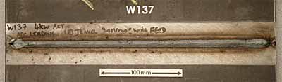

Figure 5 shows cross-sections of welds produced on butt joints made using a series of constant joint gaps of 0.2mm, 1.0mm and 1.5mm, using the welding conditions developed for zero gap butt joints, with a MAG pushing, zero process separation and with a MAG pulling 2.0mm process separation. These results also indicated that gaps up to about 1.4mm could be tolerated by the hybrid CO 2 laser MAG welding process in 8mm thick steel, without the weld profile becoming unacceptable.
Hybrid welding trials were performed on square edge butt joints to determine what changes to the established zero gap parameters would be necessary to produce an acceptable weld profile at a speed of 1.0m/min, at a fixed joint gap of 1.0mm. In practice, this was achieved by variation in only a single welding variable, that of wire feed speed. Figure 6 shows the weld sections produced for a constant gap of 1.0mm, with a wire feed speed of 9.0m/min at a travel speed of 1.0m/min. A MAG pulling configuration was used with a process separation of 1.5mm. The geometrical features of this weld led to a level 'B' quality classification. These conditions were then applied on butt joints with 0-2mm variable gap to determine the gap tolerance limit of the modified condition. Figure 7 shows the weld cross sections taken at different locations along the joint. For a joint gap up to 1.6mm, the incomplete filled groove was still within the limit (0.5mm) of quality level B.

Fig.6. Hybrid laser/MAG weld in 8.0mm C-Mn steels on a square edge butt joint with 1.0mm constant gap, produced with 4.0kW laser power, -2.0mm focus, MAG pulling 1.5mm separation, 4.0kW MAG power, 9.0m/min wire feeding rate and a travel speed of 1.0m/min:
a) Weld top bead appearance
b) Weld cross section

  • The hybrid process could be conducted at a much higher speed than when laser welding with filler wire, using the same work piece laser power. Class B welds could be produced at 1.0m/min using the hybrid CO 2 laser MAG welding process, whereas the maximum travel speed achieved for the process of laser welding with filler wire was only 0.4m/min.
  • The hybrid process had a much larger gap bridging capability than either autogenous laser welding or laser welding with filler wire. With the hybrid process, it was possible to weld joint gaps that were four times as wide as those tolerated by the autogenous laser welding process, at a similar welding speed. Acceptable welds could be produced on butt joints with a gap up to 1.4mm, without adjusting the welding parameters, when using hybrid welding. Larger joint gaps up to 1.6mm could also be accommodated by adjusting the wire feed speed or the travel speed, with other welding parameters remaining unchanged.
