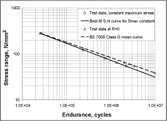

5.2 Constant amplitude tests
The results obtained from the type G specimens, together with a result obtained by Gurney from the same batch of specimens that happened to be tested with the same S max [5], are given in Table 5 and plotted in Figure 7. Also shown is the best-fit S-N curve:
ΔS2.728 N=1.183x1011 [2]
Table 5 Constant amplitude test results for the type G specimen, Smax=280N/mm 2
| Specimen No. | Stress range, N/mm 2 | Stress ratio R | Cycles to failure |
| G-01 |
80 |
0.71 |
736,000 |
| G-02 |
120 |
0.57 |
237,000 |
| G-03 |
55 |
0.80 |
2,240,000 |
| G-04 |
65 |
0.77 |
1,350,000 |
| 871* |
280 |
0.0 |
26,500 |
*: from[5].
Fig.7. Constant amplitude test results for the type G specimen, tested at a constant maximum stress of 280N/mm2. The test results obtained at R=0[6] were virtually on the BS 7608 Class G mean S-N curve
It may be noted that the test results obtained at R=0 from this batch of specimens[6] happened to lie virtually on the BS 7608 Class G mean S-N curve, as shown in Figure 7. The present results obtained at low stress ranges are lower than those obtained at R=0. This will be seen to have a significant effect on Σ(n/N) when the VA test results are evaluated.
