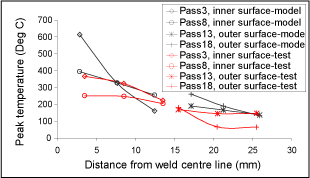

The initial temperature of the whole model was set to the ambient temperature (ie 20°C). The heat transfer coefficient and emissivity at all the exposed surfaces of the pipe were assumed to be 10W/m2K and 0.4, respectively. [Simonson 1975]
The heat input from a moving heat source was firstly converted to an equivalent value for the 2D axisymmetric model of heat transfer in which the welding process was simulated with a body heat flux applied instantaneously around the full circumference of the pipe. The heating time for each weld pass was estimated from the time for an 8mm length weld pool (about two times the weld bead width) to pass any location on the pipe. A triangular welding heat flux was adopted. The heating body heat flux rose linearly to a peak and then linearly back to zero during heating. The body flux form was chosen so that the total heat input divided by the length of the weld was equal to the welding power in kJ/mm. In addition, the modelling was repeated to ensure that the predicted melt pool shape was equal to the melt pools measured in a sister test specimen that was sectioned.

Fig.7. Comparison of the predicted and measured peak temperature distributions
