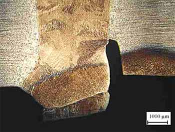

The results from the three full-scale pipe bend tests are summarised in Table 2. The first survived an overall strain of 2.6% before the pipe was unloaded. Local strains in the weld metal were about 0.5% lower. The test set-up and curvature achieved in the pipe is shown in Fig.1. A metallographic section taken at mid-length of the notch confirms that the tip was located in the fusion boundary and that initiation by ductile tearing had taken place, see Fig.2. Fractography and metallography indicated that approximately 0.2mm of crack growth had taken place at a CTOD (estimated from a pair of clip gauges mounted above the notch) of 0.98mm.

Fig.2. Macrosection from first pipe bend test crack tip at mid-length

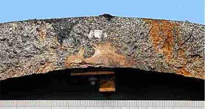

The second pipe fractured in a brittle manner at 0°C and a stress of 276MPa or 60% of the parent pipe SMYS. Post-test fractography showed a much larger and more irregular shaped flaw than expected. In fact, two fusion boundary flaws were created, see Fig.3
. The first was an irregular shaped surface flaw on the pipe inside diameter approximately 45mm long with a maximum depth of 15mm. The second was an embedded flaw, ahead of the first flaw, which was about 4.5mm high and11mm long.
Fig.3. Deliberate welding flaws in second pipe bend test

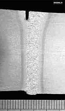

The final, third pipe test survived an overall strain of 3.01% at 0°C before being unloaded. The local strain reached in the girth weld was lower, at about 2%, probably because of the significantly overmatched weld metal strength compared with the parent pipe. This may explain the relatively low CTOD achieved of 0.2mm, although the notch depth was 1.6mm.
Post-test metallography confirmed that the notch tip was located on the grain coarsened HAZ side of the weld, very close to the fusion boundary, see Fig.4. Indeed, ductile tearing (about 0.1mm) had just commenced.
Fig.4. Crack tip in HAZ of weld root in third pipe bend test

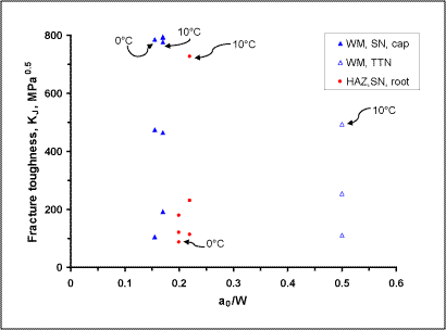

In girth welds representative of pipe tests 1 and 2, HAZ and weld metal fracture toughness values were similar and there was only small increase in toughness when temperature was increased from 0 to 10°C, see Fig.5. Although there is a weak affect of notch depth (a/W), higher weld metal fracture toughness can be achieved in shallow surface notched specimen compared with deeply notched through-thickness specimens.
Fig.5. Fracture toughness versus crack depth to specimen width ratio (a 0 /W) for girth weld representative of first pipe bend test

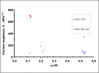

In the HAZ of the girth weld representative of the third pipe test, there was a more discernible increase in fracture toughness with reduction in notch depth, see Fig.6. However, lower bound results are the same irrespective of notch depth
Fig.6. Fracture toughness (at 0°C) versus crack depth to specimen width ratio (a 0 /W) for girth weld representative of third pipe bend test

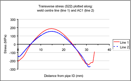

The second factor is the beneficial role played by welding residual stresses in the full-scale pipe tests. Numerical analysis was used to predict the transverse residual stresses through the thickness of the RPEB girth weld. For the pipe sizes, strength grade and welding conditions employed, compressive residual stresses were predicted at both the pipe internal and external surface, as shown in Fig.7. These are balanced by tensile residual stresses within the central two thirds of pipe wall thickness.
Fig.7. Predicted transverse residual stresses in girth welds in pipe tests 1 and 2 (line 2 is close to the edge of the transformed HAZ)
