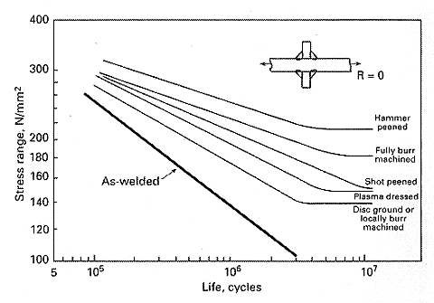

Some converted-tanker FPSOs have a tendency to develop fatigue cracks in fillet welded structural details in the hull. The poor fatigue performance of these details can be explained, firstly in terms of the overall geometric stress concentrations due to the details themselves, e.g. stiffener brackets, Figure 8. Secondly, the shape of the weld, which enhances the stress concentration. Thirdly, microscopic crack-like discontinuities, which are inherent in the toes of fusion welds and effectively eliminate the initiation phase in fatigue. And finally, the presence of high tensile welding residual stresses that effectively make all applied fluctuating stresses completely damaging.
Fig. 8. Potential sites for fatigue crack propagation from typical hull details
As part of the fatigue assessment programme, an investigation of two commonly used fatigue life improvement techniques was undertaken, i.e. weld toe rotary burr grinding and weld toe needle-peening. The aim of this programme was to quantify the magnitude of the fatigue life improvement provided by these techniques relative to as-welded details, Figure 9. Fillet welded fatigue test specimens of the two different grades of steel were fatigue tested in the as-welded, needle-peened and ground conditions, Figure 10. A variable amplitude load spectrum, based on the WASH spectrum for offshore structures was applied to obtain a ranking of the improvement techniques [10,11] . It was anticipated that in the case of the burr ground high strength steel, a more significant crack initiation period would be introduced than in the ordinary strength steels. However, in the case of needle peening, there was a concern that occasional compressive overloads could relax the beneficial compressive residual stresses induced by this technique.
Fig. 9. Typical improvement in fatigue strength of mild steel fillet welds resulting from selected weld toe improvement techniques
Fig. 10. Rotary ground fillet welded test specimens tested under variable amplitude fatigue loading
Surprisingly, it was consequently found that the calculated life improvement factors did not favour the use of one or the other life improvement technique. Both fatigue life improvement techniques were found to enhance the fatigue performance of non-load carrying fillets by a factor of at least two, compared to as-welded fillet welded joints, irrespective of the grade of parent material. The operator's choice of a suitable life improvement technique could therefore be based on practical considerations, e.g. ease of quality control, speed of application, required level of operator skill, etc.
