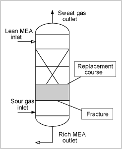

The investigation into the failure found that the tower fractured at the circumferential weld between a replacement course and the lowest course, Fig.2. Four large cracks in the heat affected zone (HAZ) had been present prior to the explosion, originating at the inner surface of the tower and extending almost through the wall thickness.
Fig.2. Section through the tower
Microhardnesses measurements in the HAZ near the surface pointed to the cracks initiating by hydrogen cracking and then progressing by hydrogen-induced stepwise cracking (HISC). Tests according to a NACE standard procedure confirmed that the material was susceptible to HISC.

Taking all of these findings into account, it was concluded that this failure occurred because the welding procedure used, when replacing a shell course, caused the formation of a hard HAZ microstructure. This hard region was therefore susceptible to hydrogen assisted environmental cracking, resulting in the growth of large cracks in the vessel. The uncracked material in the vicinity of these cracks had low fracture toughness due to hydrogen embrittlement. The vessel subsequently failed under normal operating pressure and the residual stresses at the weld.
