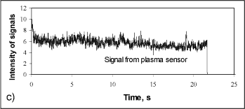

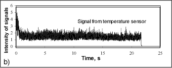

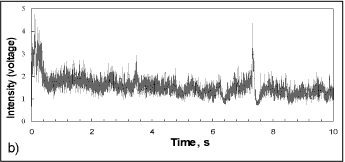

Figure 2 shows the recorded sensor signals from a typical autogenous laser weld produced using the reference laser welding conditions. The particular weld corresponding to the trace in Fig.2, had a smooth top and under bead and was free from visible imperfections. No obvious step changes or peaks in the signals from the various sensors were seen. Radiographic examination of the weld indicated that it was free of pores larger than 0.5mm diameter, no assessment of pores less than this having been made.
Fig.2. Sensor signals from the temperature, and plasma sensors, arising from the reference autogenous laser welding conditions for a 6mm stiffener plate welded to an 8mm base plate:
a) Weld top bead;
b) Temperature sensor response;
c) Plasma sensor response

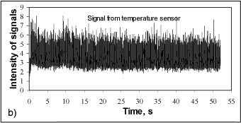

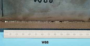

Figure 3 shows the sensor signals received from a T-butt weld produced using the reference set of welding conditions but with silver solder wire added to two areas in the joint. Both the recorded plasma signal and temperature signal showed changes corresponding to the placement of the wire, which resulted in the formation of surface pores, which can be seen in Fig.3a.
Fig.3. Sensor signals received from a 6mm stiffener welded to an 8mm base plate made with two small pieces of silver solder introduced at the joint line:
a) Weld top bead;
Tests were also carried out to simulate different imperfections by changing process parameters and joint fit-up conditions during laser welding, such as changes in laser beam focus (causing incomplete penetration), beam to joint misalignment (causing incomplete penetration and lack of fusion), and variation in plasama suppression gas flow rate (causing incomplete penetration).
It was noted that, for this particular joint/material combination, the temperature sensor detected most of the changes in joint fit up, process parameters and contamination of the joint face. It provided responses to added solderwire and grease (causing surface pores and excessive spatter), with step changes in the amplitude of the signal. The responses to the changes in characteristics of the optical signals caused by addition of wire and grease to the joint were different. The temperature sensor showed a step decrease in the area with added solder and a step increase in areas with applied grease. The temperature sensor was also sensitive to variations in laser focus position and changes in laser beam position on the stiffener plate (caused incomplete penetration and lack of root fusion in welds). This sensor also responded to changes in laser focus (causing incomplete penetration), with gradual increase in the amplitude of the signal as the laser was moved away from the optimised focus position. A similar behaviour was observed when the position of laser beam on the stiffener plate was varied. The sensors could detect a changes in emitted radiation caused by a change of laser beam position on the stiffener plate, (resulting in lack of penetration) when the weld top bead showed no obvious changes.
For autogenous welding the plasma sensor showed a similar capability to detect variations in emitted radiation caused by changes in joint fit-up and surface condition as the temperature sensor, apart from not being able to detect the results of adding grease (causing excessive weld spatter). However, the responses from the plasma sensor to some of the engineered anomalies were different to those from the temperature sensor in terms of the magnitude of variation in recorded intensity, with respect to the signals from the reference weld. For example, the temperature sensor exhibited an increase in amplitude to changes in laser focus position (causing incomplete penetration). In contrast, the plasma sensor responded to the same change with a decrease in amplitude.
It is also interesting to note that the temperature sensor could clearly detect changes in the optical signals associated with adding grease (resulting in excessive weld spatter), whereas the plasma sensor showed little response to this. The combination of the plasma sensor and the temperature sensor was able to detect changes in the emitted radiation corresponding to all the simulated imperfections studied.

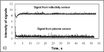

Figure 4 shows the recorded sensor signals from a typical weld produced using the reference hybrid laser-MAG welding conditions. The weld had a smooth top and under bead and was free from visible imperfections. A smooth response in signal was recorded for the full length of the weld. Radiographic examination indicated that the weld was free of pores, greater than 0.5mm diameter. The weld quality was classified as Class B in accordance with BS ENISO13919:1 - 1997, in terms of profile and porosity levels.
Fig.4. Sensor response from a hybrid laser-MAG arc weld made using the reference welding conditions, for an 8mm thickness stiffener welded to a 12mm thickness base plate:
a) Weld top bead;
c) Reflectivity and plasma sensor response.

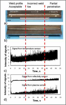

Figure 5 shows sensor signals received from a hybrid weld produced by changing the axial position of the beam focus along the beam incident axis from 2mm at the weld start to 12mm at its end. It is clear that all three sensors were sensitive to this change in laser focus position. The amplitude of the signals from the sensors gradually increased as the laser beam moved away from the optimised focus position. Visual examination of the resulting weld indicated that the weld bead profile was similar to that of the reference weld for a laser beam focus position from 2 to 4mm above the stiffener plate, i.e. for the first third of the weld. There was little change in the sensor signals in this part of the weld ( Fig.5a). In the second third of the pass, the weld still showed full penetration, but on the top of the weld, incorrect weld toe could be seen. In this region, the amplitude of all three detectors can be seen to rise. In the final part of the weld, the top bead became wider and more concave and weld penetration was eventually lost. In this region, the amplitude of the signals continued to rise for all three detectors, but no obvious step-change in signal could be seen on the change from full to partial penetration.
Fig.5. Sensor response from a hybrid laser-MAG weld made at the reference conditions but changing the axial position of the beam focus from 2mm away from the joint position at the start of the weld, to 12mm away fromthe joint position at the end of the weld. (8mm thickness stiffener and 12mm thickness base plate):
a) Weld top bead;
b) Weld under bead;
c) Temperature sensor response;
d) Reflectivity and plasma sensor response

Results from the plasma and temperature sensors during hybrid laser-MAG welding indicated differences when compared to the results from these sensors in the autogenous welding trials. If the results for the reference welds are compared, then for hybrid laser-arc welding the signals from the plasma detector appear to be of a lower relative intensity, but are also less noisy. In comparison, for hybrid laser-MAG welding the signals from the temperature detector seem to be slightly higher in average intensity, and noisier, than those found during autogenous welding.
For hybrid welding, the plasma sensor exhibited clear responses to changes in joint fit-up, surface condition and process parameters causing undercut, incomplete penetration, excessive weld metal, excessive weld spatter and possibly internal porosity. The largest response from the plasma sensor was from the added silver solder, causing regions of undercut, and changes in arc current (wire feeding rate) resulting in the formation of excess weld metal. Changes in laser beam (and MAG torch) position with respect to the joint line could lead to lack of root fusion and incomplete penetration in the weld. This change could be detected by the plasma sensor. When the axial position of the beam focus was changed, it was possible to detect changes in the sensor signal corresponding to the change from an acceptable top bead weld profile to an irregular weld profile, and from an irregular weld profile, to partial penetration. This behaviour was similar to the results for autogenous welding.
For hybrid welding, the temperature sensor exhibited clear responses to factors causing undercut, lack of penetration, excess weld metal and excessive weld spatter. In a similar manner to the response from the plasma sensor, the largest response by the temperature sensor was from changes in arc current, causing excess weld metal and variations in laser focus, causing lack of penetration.
The temperature sensor, however, did not show any response to changes in the position of the laser beam with respect to the joint line, resulting in lack of root fusion. When the beam focus position with respect to the stiffener was kept constant but the focus position away from the base plate was varied from 0 to 5mm, the plasma and reflectivity (to a lesser extent) sensors measured changes corresponding to the appearance of lack of fusion on the top bead whilst still achieving full penetration, to the condition where the beam was so high on the stiffener that no fusion was achieved in the base plate, effectively resulting in a fully penetrating bead-on-plate run. For this particular trial, no change at all was registered by the temperature sensor. The plasma sensor, exhibited a very small increase in the amplitude of its signal when lack of root fusion occurred. This indicates that for this particular joint configuration, factors causing lack of side-wall fusion will be more difficult to identify with these sensors, compared to the other imperfections tested in this work.
It has been claimed [5] that the reflected laser light, ie that light detected by the reflectivity sensor, is an indicator of weld penetration, as the amount of reflected light correlates with the aspect ratio of the keyhole. If a constant diameter keyhole is maintained, the aspect ratio of the keyhole only depends on the keyhole depth. The deeper the keyhole, the more keyhole surface is available for absorption of the laser beam. For this particular joint/material combination, ie a steel T-joint, the maximum speed for achieving fully penetrating welds was when the laser beam was focused 2.0mm from the stiffener plate surface and 1.0mm away from the base plate surface. If the argument is used that when the laser beam is moved away from an optimized position, the weld penetration (keyhole depth) decreases, then this should correspond to an increase in reflected light. The reflectivity sensor has clearly picked up the changes in signal caused by variations in laser focus position, resulting in incomplete penetration in the weld, as shown in Fig.5. The reflectivity sensor did not indicate any significant changes when the laser focus position was kept unchanged, (unless it detected some other anomaly).
