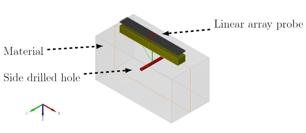

2.1 Simulation
This work employed the CIVA simulation package, developed at CEA (French Atomic Energy Commission). CIVA is a commonly used simulation tool within industry and has been extensively verified(17). Structural noise in coarse grained material is simulated in CIVA by assuming the crystallographic structure of the material is homogeneous and is populated by a set of randomly distributed scatterers(18). The spatial density of the scatterers is assumed to be uniform within a

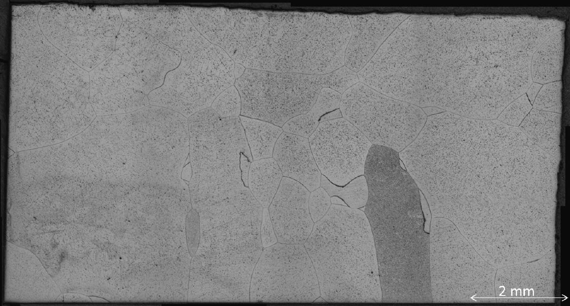

2.2 As-cast Coarse Grained Sample
A coarse grained low density, high aluminium, steel cast sample was produced and provided by WMG at the University of Warwick for inspection purposes. The sample contains a columnar grain structure with grain sizes in the millimetre range. Figure 2 is a micrograph of the as-cast steel block from the inspection surface. An artificial defect in the form of a 2.5 mm diameter SDH was inserted into the sample at a depth of 27 mm from the top surface. A 64 element probe manufactured by Vermon – specifications are presented in table 3 – was controlled by a Micropulse 5PA manufactured by Peak NDT, Derby, UK.

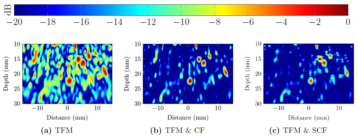

By simulating a 3 mm SDH in the material the performance of the imaging algorithms can be compared for an ideal and repeatable scenario.  In this work we first explore the effect of applying CF and SCF to a TFM inspection and then consider altering the sensitivity parameter α.
Figure 3: Comparison of CIVA cross-sectional images with a -20 dB dynamic range. SDH located at a depth of 24 mm
Figure 3 shows three cross-sectional images of CIVA simulated data with a 20 dB dynamic range.  Figure 3a shows a conventional TFM reconstruction.  Note there are several areas of high intensity and the background noise is also appreciable. Figures 3b and 3c show TFM images which have undergone weighting via CF and SCF respectively. Note that the SCF processing has employed a 7-by-7 pixel moving average filter as recommended by Camacho et al. to mitigate discontinuities which manifest when the phases of the RF signal are grouped around ±π (9). Figures 3b and 3c both suppress the background noise, however several areas of high intensity still exist, resulting in the inability to identify the response from the side drilled hole.

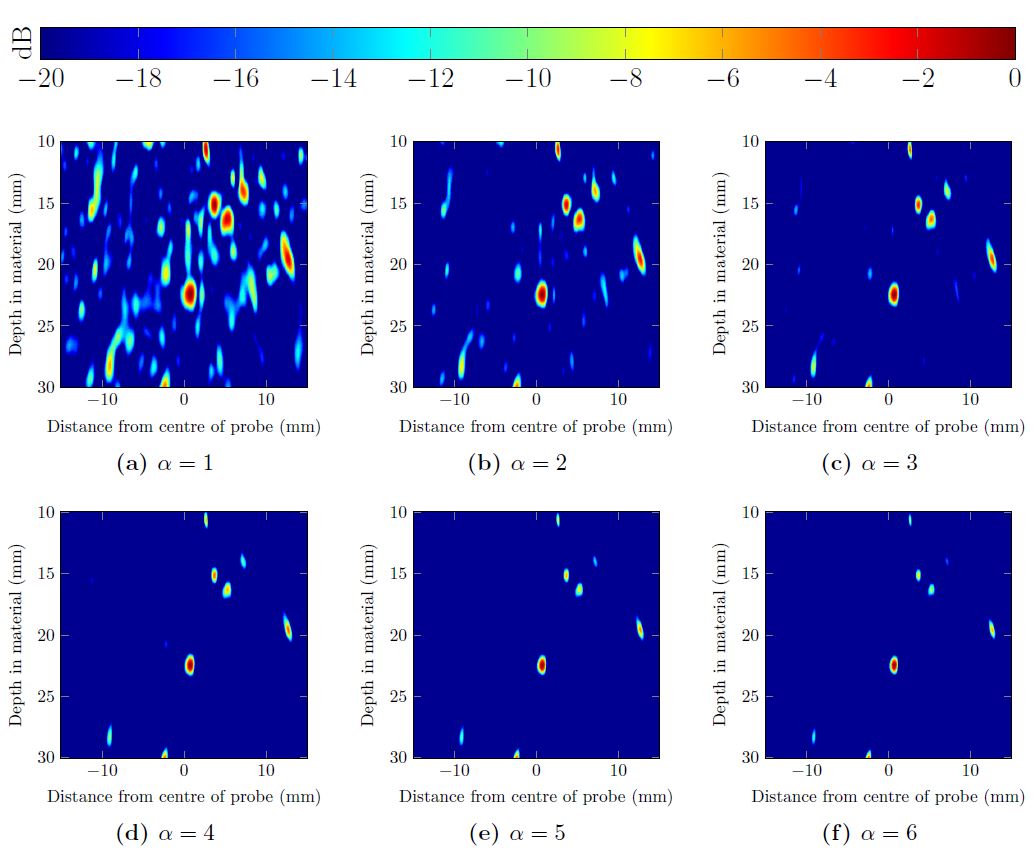

3.1.1 Altering α
As shown in fig. 3 directly applying a coherence weighting factor is not always sufficient to resolve a defect indication from the structural noise. Camacho et al. describe a sensitivity factor for the SCF algorithm(8), this is represented by α in eq. (5), we have applied this sensitivity factor to the CF algorithm as per eq. (2).
Figure 4: Comparison of CF weighted cross-sectional images with a -20 dB dynamic range
Changing the value of α corresponds to varying the strictness of coherence needed for favourable weighting, with a high value of α being less tolerant to partially coherent signals than a lower value of α. The optimal value of α will depend on several factors including the material being inspected as well as the chosen method for inspection and is not absolute. Figure 4 shows several cross-sectional images with various values of α constructed from a common data set. As the value of α increases the indications due to structural noise decrease. With the condition α = 4 (fig. 4d) the majority of the structural noise is below the imaging threshold aside from a small cluster of indications at a depth of approximately 15 mm, however, by increasing the value of α to α = 6 the side drilled hole indication is over 6 dB above every other indication, making it easily resolvable

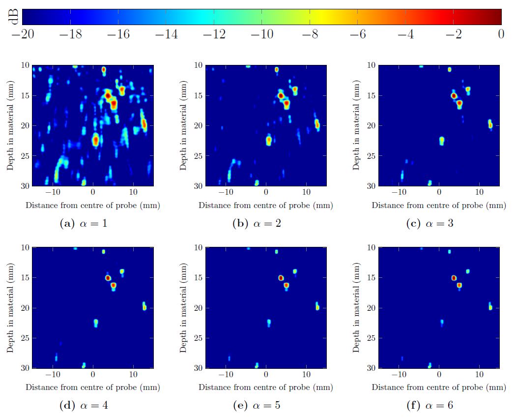

Figure 5: Comparison of SCF weighted cross-sectional images with a -20 dB dynamic range
Figure 5 also shows the several cross-sectional images with various values of α constructed from the same common data set for the case of SCF. As the value of α increases the indications due to structural noise decrease. Once again, with the condition α = 4 (fig. 5d) the majority of the structural noise is below the imaging threshold aside from a small cluster of indications at a depth of approximately 15 mm. However, note that these indications are now the strongest on the image, and unlike the CF results shown in fig. 4 an increase in the value of α does not resolve the indication from the SDH. In fig. 5f the indication due to the SDH is 13 dB below the peak indication.

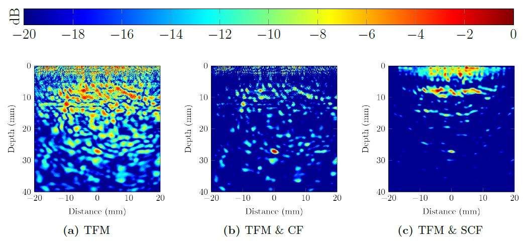

3.2 As-cast Coarse Grained Sample
Figure 6 shows a comparison of cross sectional images generated using a common data set acquired from the inspection of a coarse grained low density, high aluminium, steel cast sample as described in section 2.2. The cross sections are presented with a dynamic range of -20 dB. The effect of the CF and SCF weighting algorithms in figs. 6b and 6c respectively is significant when compared to the conventional TFM image fig. 6a. Figure 6a contains multiple indications of equally strong magnitude, making the indication from the SDH impossible to isolate from the structural noise. The effect of the structural noise is greatly reduced when CF is applied, with the indication from the SDH having a magnitude 5 dB above the second highest indication, which is emanating from structural noise located at a depth of 8 mm, and 8 dB above the local noise contributions.  Figure 6c suffers more from shallow structural noise, with the indication due to the SDH being 5.5 dB below the highest indication in the image.  Where SCF appears to perform beneficially is when the region of interest is more localised to the SDH indication, a valid approach in this scenario due to knowledge of the indication position a priori. Within a 10 mm by 10 mm region of the SDH the second highest indication value is 6 dB lower than the SDH response, with areas of indication due to structural noise being much more sparse when compared to fig. 6a.
