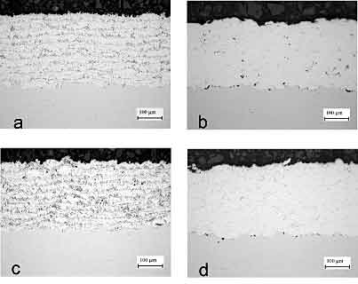

Cross sections of the coatings are shown in Fig.1. The DJ2600 coatings of stainless steel 316 and nickel alloy 625 have a layered structure consisting of well consolidated metallic layers separated by a darker contrast phase believed to be oxide. Each layer represents one pass of the spray gun over the test sample. Despite the noticeable oxide content, both coatings have little porosity and the powder particles are well deformed with little evidence of un-melted or partially deformed particles. The modified DJ produced coatings have very little oxide visible in the cross section. These coatings consist mostly of partially deformed particles densely stacked to give very low levels of porosity. The nickel alloy coating in particular appears fully dense with almost no visible porosity.
Fig.1. Cross sections of as-sprayed coatings:
a) stainless steel 316 using DJ2600
b) using modified DJ
c) nickel alloy 625 using DJ2600
d) using modified DJ

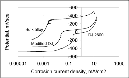

The potentiodynamic plots for the stainless steel 316 coatings and for the same alloy in bulk form are shown in Fig.2. The bulk 316 alloy shows the expected behaviour for this alloy in a chloride solution. Initially the corrosion current remains very low, at values below 0.01 mA/cm 2, as the potential is raised from the rest potential. In this region the bulk alloy is considered passive and resistant to corrosion. Above a potential of about 280 mVsce (referred to as the breakdown potential),the corrosion current density rapidly increases due to the onset of localised corrosion as pits form on the surface being tested.
The coatings also show such a breakdown potential above which there is a rapid increase in current density. However this potential, at about 0 mVsce for the modified DJ coating, is much lower than the breakdown potential for the bulk alloy. In addition the current density below the breakdown potential for both coatings is much higher than that for bulk stainless steel. These results suggest that both coatings are more susceptible to corrosion than the same alloy in bulk form. There is some difference in corrosion behaviour between the two coatings. The modified DJ coating has a slightly higher breakdown potential and a lower corrosion current density below this potential. At a potential of -100 mVsce the modified DJ coating has a corrosion current density of about 0.025 mA/cm 2 compared to 0.22 mA/cm 2 for the DJ2600 coating. This indicates that the modified DJ coating is more resistant to corrosion than the DJ2600 coating, but not as resistant as bulk stainless steel 316.
Fig.2. Potentiodynamic polarisation plots for stainless steel 316 coatings and bulk alloy, forward scan only

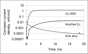

To further identify differences in corrosion performance between the stainless steel coatings, potentiostatic corrosion tests were undertaken at a potential of -100 mVsce. These tests were performed on new samples. The results ofthe test are shown in Fig.3. Both the modified DJ coating and DJ2600 coatings initially have a very low corrosion current density of about 0.0001 mA/cm 2. This rapidly increases for the DJ2600 coating up to a value of about 1 mA/cm 2 after 2 hours, and then stays at this value for the remainder of the test duration. The modified DJ coating exhibits a slower increase in corrosion current density to reach a value of about 0.01 mA/cm 2 after 6 hours. Again this value is maintained for the remaining test duration. These results suggest that the modified DJ coating is more resistant to corrosion attack giving a lower corrosion rate. The corrosion current density is low for this coating and indicates that at -100mVsce potential, very little corrosion is occuring. The corrosion current density of 1 mA/cm 2 obtained for the DJ2600 coating at this potential suggests a significant amount of corrosion attack is occurring. The bulk alloy shows quite different behaviour with the corrosion current density, and correspondingly corrosion rate, dropping during the test to a much lower value.
Fig.3. Potentiostatic plots for stainless steel 316 coatings and bulk alloy

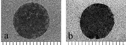

Examination of the coatings after the 20 hour duration revealed that localised corrosion attack had occurred on the coating deposited using the DJ2600 system. This coating had a dark grey circular test area with the presence of red coloured spots on the coating surface, Fig.4.
These features were not observed on the coating prepared with the modified DJ system. This coating had a light brown staining over the circular test area. By comparison the bulk stainless steel surface was only lightly stained after the test with no evidence of any localised corrosion.
Fig.4. Appearance of stainless steel 316 coating surface after exposure to the potentiostatic corrosion test:
a) DJ2600
b) Modified DJ

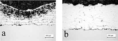

A cross section through the DJ2600 coating showed several locations where corrosion attack of the coating had occurred, Fig.5. These appear as a pits located in the upper portion of the coating and in some cases extended down through the coating to reach the substrate. In such locations corrosion of the steel substrate was observed.
Fig.5. Cross sections of stainless steel 316 coating after potentiostatic corrosion test:
a) DJ2600
b) Modified Diamond Jet
The cross section through the modified DJ coating did not reveal any significant corrosion features within the coating, Fig.5. Although no substantial corrosion of the steel substrate was observed, there was possible evidence of corrosion along the interface with the underlying steel substrate. This appears as an intermittent thin dark layer atthe interface.
