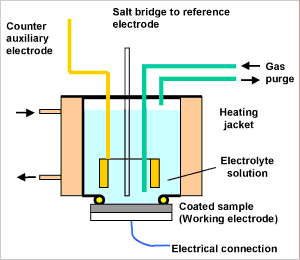

Electrochemical corrosion tests were performed using a three-electrode Avesta cell arrangement attached to a computer controlled potentiostat as shown in Fig.2. Experiments were carried out according to the guidelines described in the ASTM standard G61. The electrolyte was a 3.5% NaCl solution (made from distilled water) with a pH value of about 8.1. The temperature was maintained at 25±1°C. Electrical conductivity was measured at about 53mS.cm -1 at 25°C and the solution was deaerated by continuous purging with nitrogen.
Fig. 2. Schematic diagram of the Avesta cell
The specimens were electrically connected to the Avesta cell. The coated surface was exposed to the electrolyte and the rest potential 'E corr' (also known as free corrosion potential) was stabilised for one hour prior to the anodic polarisation. This potential was measured using a reference saturated calomel electrode (SCE). The area exposed to the electrolyte was then anodically polarised from its rest potential to more positive potential at a rate of 10mV.min -1. This was continued until a current density of 5mA.cm -2 was measured in the external circuit between the working electrode (specimen) and a platinum auxiliary electrode. On reaching a corrosion current density of 5mA.cm -2 the scan was reversed and the potential reduced in the negative direction back to E corr. A plot of the corrosion current density as a function to the polarisation potential was recorded.

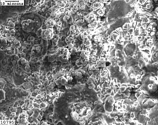

An SEM image of the deposited Keronite coating surface displays an abundance of agglomerated particles formed during the micro-arc oxidation process ( Fig.4). X-ray diffraction of the coating layer confirmed spinel (MgAl 2O 4) as the major constituent together with existence of stishovite (SiO 2) and silicon phosphide (SiP 2). This is illustrated by the XRD pattern shown in Fig.5.
Fig. 4. SEM image of the as deposited surface of the Keronite coating on AZ91D

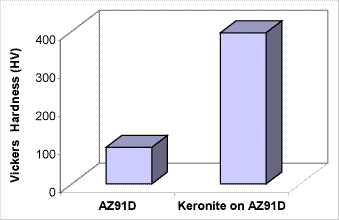

Micro-indentation hardness values measured on the polished cross section ranged between 345 to 446 HV for the 35µm Keronite coating and about 95 for the AZ91D alloy. Average hardness values of the AZ91D alloy and the 35µm Keronite coating are compared in Fig.6.
Fig. 6. Vickers microhardness values measured on die cast AZ91D and 35µm Keronite coating under a load of 25g.

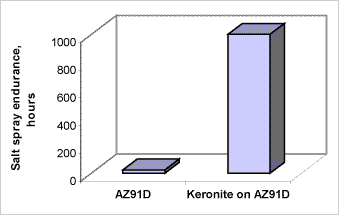

Fig. 8. Salt spray (ASTM B117) endurance of the uncoated AZ91D and AZ91D with the 35µm Keronite coating
Salt Spray Test

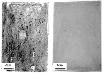

Salt spray corrosion test showed little visual evidence of corrosion attack on the surface of AZ91D coated with a 35µm Keronite coating after 1000 hours of exposure. In contrast, uncoated AZ91D displayed significant corrosion of the exposed surface after 24 hours of exposure. Figure 8 shows endurance of the coated and uncoated test coupons to the rating of 9 in accordance with ASTM D1654-92, procedure B. Surface appearance of the uncoated and Keronite coated test coupons after 1000 hours of salt spray exposure are shown in Fig.9.
Fig. 9. Optical image of the exposed surface of AZ91D (left) and AZ91D coated with 35µm Keronite coating (right) after 1000 hours of salt spray (ASTM B117) test

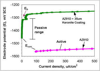

Accelerated electrochemical test (anodic polarisation) results of AZ91D uncoated and coated with 35µm Keronite are shown in Fig.10. The results demonstrate contrasting behaviour of the coated specimens compared to uncoated alloy. The coated specimen displayed a more noble rest potential 'E corr' compared to that shown by the uncoated specimen. A more noble rest potential in deaerated electrolyte generally signifies less susceptibility to corrosion attack.
Fig. 10. Anodic polarisation (ASTM G61) curves of uncoated AZ91D and AZ91D coated with Keronite in deaerated 3.5% NaCl solution at 25°C.
Moreover, the coated specimen displayed greater resistance to initiation of corrosion attack shown by the presence of a breakdown potential 'E b' and a passive potential range 'E b-E corr'. A metal surface, which is not protective and corrodes actively, displays a curve similar to uncoated AZ91D with significant current within a small range of positive potential from its rest potential value.
