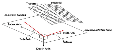

Fig. 6. The design of the immersion coupled TRL phased array probe. The axes convention is based on weld testing where the probe is scanned along the axis parallel to the weld centreline (scan axis) and movement along the index axis translates the probe towards (or back from) the weld centreline
The phased array data representation used in this paper makes use of beams from 40° to 80° 'stacked' to create what is known as the sector or azimuthal scan.[14] All such sector scans shown in this paper are created in the index - depth plane.
In addition to the roof angle and the frequency (2.5MHz) the following parameters were determined through an iterative modelling programme:
  • number of elements in the index axis direction;
  • number of elements in the scan axis direction;
  • pitch in both index and scan axes directions;
  • wedge angle.
The use of 64 elements in the transmit array leads to better manipulation of the sound field through 'phasing'; similarly the use of 64 elements on reception allows the processing of received echoes with greater resolution. Hence the parameters above were optimised for use of all 128 channels available in the array controller.
Since the in-service inspection was to be carried out in immersion, the sound was coupled through water. As well as being more accomodating towards varying surface profiles, the lack of a separator (as would be required in a solid wedge) enables greater lateral steering (ie along the scan axis). Furthermore, the use of immersion coupling makes the design unique and provides insight into the performance of a previously unexplored type of twin crystal design.

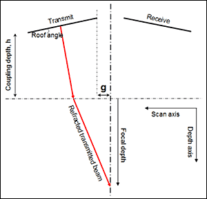

A geometrical model in the scan-depth plane, Figure 7, was used to select maximum refraction angles along the scan axis and specify the value for g (half-width separation), which was set so that the transmitted and received beams did not overlap at the water to component interface, leading to cross talk. This required the iterative optimisation of the roof angle and the coupling depth h to allow the focusing of the sound beam over the required depth range in the component.
Fig. 7. Parameters of the geometric model to define the parameter g, which represents the physical separation of the transmit and receive arrays. The figure is a projection of the probe in Figure 6 along the scan-depth plane
As an example of the conflicting design criteria consider lateral steering versus maximum focal depth. For a given array configuration, smaller element size increases steering ability whereas larger element size enables a longer lateral focal distance. As introduced, a single probe was required to operate from just sub-surface to the greatest range possible. As an example of the modelling, Figure 8 shows the specified TRL probe steering the beam at 60° and focusing to a depth of 40mm along the index - depth plane. The figure shows the desired ultrasonic beam with no grating or side lobes.

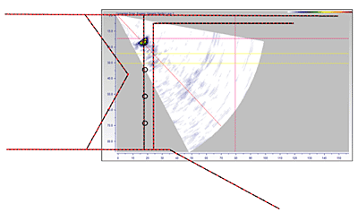

The data presented in Figures 10 to 15 show the sector scan from the TRL probe. The weld overlay and target positions are dimensionally accurate and the scales are in mm. The colour scale for signal amplitude is from white (low) through blue, green and red (high).
Fig. 10. Detection of hole 4 (side 1) along the 45° beam by the TRL probe in AS (test block B)
Figure 11 shows the sector scan of SDHs 2-4 with the beam focused at hole 3 in test block B in AS. The path of the sound beam is through the weld material where beam forming also takes place. Note the positioning error of hole 4, which is about 4 and 3mm along the depth and index axes, respectively. Figure 12 shows the increase in beam width at larger depths (hole 2 in test block B); the beam widths generated by the TRL probe at large depths are consistent with predictions by SimulUS. It can also be seen that the signal-to-noise is still acceptable (greater than 14dB).
