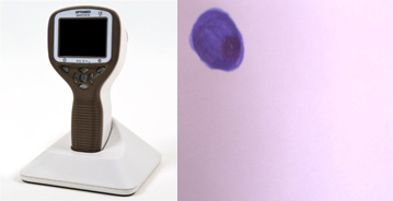

The portable Smartscope M5 camera is being used in the development efforts by a range of organisations in the medical industry [2].

Ink blots in different colors were drawn on white paper as an initial representation of skin discoloration on skin. Images were taken using the Smartscope M5 without any optics module. As the program developed was efficient, some skin pictures with artificial spot (drawn) have also been taken to propose a possible utilization of the program for early stage diabetic’s diagnosis. The Smartscope M5 is a 400g camera with dimensions of 82.30mm (w)  166.50mm (h)  66.50mm (d) and powered by a rechargeable Ni-MH battery. This camera gives JPEG images at the resolution of 2560 1920 pixels. It can be connected to a PC through the USB port and is working on Windows XP®, Windows Vista®and Windows 7® without additional driver installation.
Figure 1 - Smartscope M5 device on left and input image of the study on right

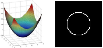

We define some function φ(x, y, t) (the Level-Set function), where (x, y) are coordinates in the image plane and t is an artificial ‘time’. At any given time, the Level Set function simultaneously defines an edge contour and a segmentation of the image. The edge contour is taken to be the zero Level Set {φ(x, y, t)=0}, and the segmentation is given by the two regions {φ > 0} and {φ < 0}. The Level Set function will be evolved according to a partial differential equation (PDE), and will reach a steady state limit leading to a useful segmentation of the image.
Figure 3 - Level set method at time t. On Left the level set curve and on right the result contour at time t

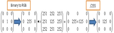

In MATLAB images are represented in matrices where each value represents a pixel. Once the segmentation is performed the output matrix is a binary image where the region of interest’s pixel values are 1 and the background’s pixel values are 0. Thereby the data images should be converted to RGB to allow operations on the input image. In MATLAB the instruction ‘.*‘ permit to perform an element by element multiplication. Thus, the background of our image is clean (black pixels with 0 value) and the task’s pixels keep the initial value (following division of the result by the white pixel’s value 255).
Binary to RGB
Figure 4 - Image conditioning to perform colour analysis. On top illustration of MATLAB element by element multiplication and on bottom the effect on the corresponding images

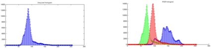

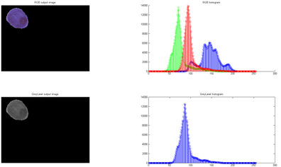

The colour analysis can now be precisely performed. In numerical imaging the histogram is the most common tool, used to display the image intensity. For a grey level image, every intensity value (axis) is associated with its apparition number (ordinate). Usually, RGB histograms are plotted in a colour space in three dimensions (3D). In this development, the three components (R, G and B) were plotted on the 2D histogram. Thus, the histogram reading is similar to that of a grey level image and is easier to realize by the user. Note that for an RGB image every pixel value is a combination of the three plotted components. In this work the histogram’s pixel values start from 1 instead of 0 to avoid excessive and useless black pixels. Figure 4 shows the two kinds of histograms presented as results by the MATLAB program developed in this project.
Figure 5 - Histograms plotted in MATLAB. On left the grey level histogram and on right the RGB histogram

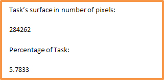

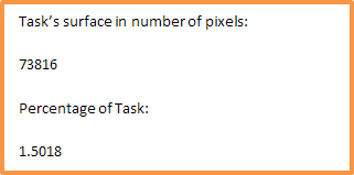

The developed program also outputs the task size in number of pixels contained within it and the percentage of task over the whole image.

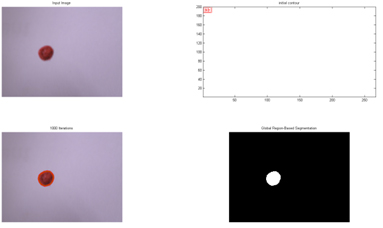

Tests were performed with two different images, one with a blue ink task and another with a red ink task. Image names were blue.JPG and red.JPG, their sizes were both 1920*2560 pixels and 1000 iterations were performed for the Chan-Veze segmentation. As the results were efficient the use of the program for the medical aims using images taken of the skin was undertaken as the next stage.

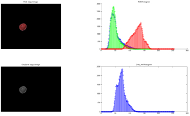

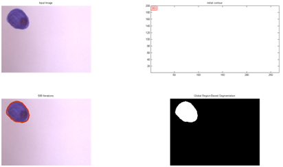

For one test, MATLAB gives three results: one figure with the details of segmentation using Chan-Veze, one figure with the two histograms front of the corresponding image and then the processed segmented region (ink task as in this study). All the results for blue.JPG and red.JPG input data are presented in Figures 6 to 11.
Figure 6 - Segmentation for “blue.JPG”
Figure 7 - Colour Analysis for “blue.JPG”
Figure 8 - Size analysis for “blue.JPEG”
Figure 9 - Segmentation for “red.JPG”

Figure 11 - Size analysis for “red.JPG”

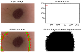

As discussed earlier, the Chan-Veze algorithm requires good homogeneity within distinct regions. Because of the possible inhomogeneity on the skin region and the reflection due to the device, an optimisation of the algorithm is required for data sets that represent more closely the nature of the human skin. Figure 12 illustrates the limitation when the current algorithm is applied on skin.
Figure 12 - Segmentation problems on skin pictures

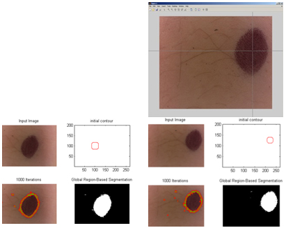

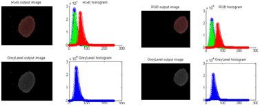

To solve this problem, the algorithm has to be initialized into the spot (task) and thus it will not be affected by reflexion or skin homogeneity because they become insignificant compared to the spot itself. There are two solutions to realize this initialization with different advantages. The first one is to perform the initialization in the middle of the image. This solution requires the photographer to place the spot in the middle of the camera but with the program still running automatically on the input image for processing. The other solution consists of asking the user to click on the picture where he wants to initialize the algorithm, which should be within the spot. This method allows detecting a spot anywhere in the image but the program becomes semi-automatic and needs one interaction with the user.
Figure 13 - Solutions for segmentation on skin images. On left automatic solution, on right semi-automatic solution
Figure 14 - Good agreements on histogram for the two methods using different images of the same skin spot which validate the colour analysis of the study
The skin spot sizes were different from 13% of image’s size for the first picture to 10% for the other. When the Smartscope M5 device is used for dermatoscopic imaging the objective’s camera touches the skin and can stretch the spot, which accounts for the discrepancy between the two sizes.
