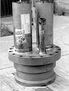

In 1996, HESCC was identified in two forged superduplex stainless steel hubs on the BP Foinaven field development, during final commissioning of a subsea manifold, in a water depth of approximately 400m [9] . The general arrangement of a hub is shown in Fig.1. Cracking occurred in the machined nib region, adjacent to a weld to 6" pipe. The manifold was subject to cathodic protection by aluminium alloy anodes, giving potentials around -1050mV SCE. The hubs were solution annealed and quenched, had approximately 50-50 ferrite-austenite phase balance and service stresses had not been applied, although pressure testing had been performed and locked-in/residual stresses had inevitably been introduced during fabrication and installation. However, gross plastic deformation had not occurred, throwing doubt on the applicability of previously published data. A programme of full-scale and small-scale tests was undertaken at TWI on behalf of BP to investigate the threshold condition for cracking in the hub material. This threshold condition had to be defined in terms of strain, so that it could be related to the actual hub geometry via appropriate stress analysis. These tests have been summarised elsewhere [9] and this paper presents a more detailed appraisal.
 Fig.1. General view of hub and two 6" pipes after removal from the manifold

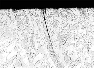

In all tests, when cracking was induced it was predominantly by transgranular cleavage of the ferrite phase and followed the alignment of the microstructure in preference to the plane of maximum stress ( Fig.3). Cracks tended to arrest at ferrite/austenite boundaries. There was no relationship apparent between the cracks and third phases, i.e. nitrides/carbonitrides.
Fig.3. Crack initiation in displacement-controlled bend test on hub material at -1100mV, X80

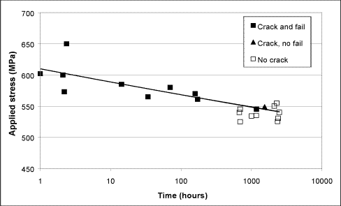

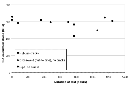

Constant load bend tests
Figure 4 illustrates the results of constant-load bend tests on hub material at -1100mV and 5°C with applied loads up to 150% of the calculated load required to reach the 0.2% proof stress in the outer fibre. No cracking was observed in any test. Higher loads could not be used as the specimen deflection became unacceptable. The presence of a weld profile or small surface notch did not induce cracking.
Fig.4. Results of smooth four point bend tests in seawater at 5°C and -1100mV

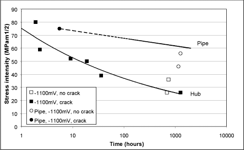

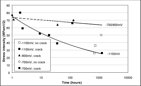

Constant load pre-cracked bend tests
Figure 5 shows results of bend tests on pre-cracked hub specimens at -1100mV, -800mV and -700mV and pipe specimens at -1100mV, at ambient temperature. Cracking was observed in a few tens of hours in most cases, with the pipe material having greater resistance to cracking them the hub. Sensitivity to cracking in the hub was greater at -1100mV than -800/-700mV. Approximate threshold stress intensities for cracking in 40 days were 20-25MPa √m (hub at -1100mV), 50-60MPa √m (hub at -800/-700mV) and 60-70MPa √m (pipe at -1100mV). In the pipe specimens, crack propagation was along the direction of microstructural alignment, i.e. perpendicular to the pre-crack. Microstructural alignment apparently had little effect on the stress intensity for propagation of cracks in the coarser hub material, although propagation was always along the aligned ferrite phase.
 Fig.5a) Results of four point bend tests on pre-cracked specimens of hub material tested in seawater at ambient temperature and -1100, -800 and -700mV
Fig.5b) Results of four point bend tests on pre-cracked specimens from hub and pipe materials in seawater at ambient temperature and -1100mV
Fig.5b) Results of four point bend tests on pre-cracked specimens from hub and pipe materials in seawater at ambient temperature and -1100mVFig.5b) Results of four point bend tests on pre-cracked specimens from hub and pipe materials in seawater at ambient temperature and -1100mV

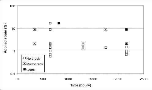

Constant displacement bend tests
The -1100mV constant-displacement bend test results are summarised in Fig.6. No cracks were seen in any of these specimens when they were removed from the 50 bar autoclave after 30 days. Further exposure at ambient conditions produced through-thickness cracking, observed only in U-bend specimens deflected to 8 or 17% strain and only after 7 days or more after removal from the autoclave. A number of very small cracks was observed in specimens at lower strains down to 1.3%, Fig.6. Cracking at the lowest strain levels of 1.3 to 1.6% was only observed in specimens given a succession of 0.1% strain increments during test and only after a minimum of 14 days exposure at ambient conditions. For the specimens that were pre-charged prior to test and then exposed under ambient conditions, without strain increments during test, very small cracks were only observed at strains of 2.1% and above.
Fig.6. Results of constant-displacement bend tests on hub material in ambient temperature seawater at -1100mV

The constant-load tensile tests on hub material at -1100mV and ambient temperature showed results that were strikingly different to those from the smooth bend tests, Fig.7. Cracking was observed in a few hours at stresses around the proof stress and a threshold stress of 545MPa was established for cracking in 1000 hours (i.e. slightly below the conventional 0.2% proof stress). At the onset of cracking, the specimen with the lowest failure stress of 545MPa gave a strain of 0.9% and shortly after loading, it had a strain of 0.5%. One specimen (549MPa) showed a small crack that had not propagated to failure in 40 days. Stresses around proof stress were associated with a marked degree of creep, with final strains of 1.2-2.5% being recorded for specimens loaded between 550 and 650MPa. Conventional tensile tests indicated strains of about 0.5 to 1.3% for the same stresses. The creep strain developed most quickly at the start of the test and the strain rate fell slowly over the 30-100 day test duration, although creep was still on going after this period. Strain rates averaged over the test duration were between 1x10 -4 and 1x10 -9s -1, depending on applied stress. A typical elongation versus time curve is given in Fig.8. The sample subjected to a pre-strain of 5% and tested at 600MPa did not crack and showed no appreciable creep. The approximately constant-strain tensile tests did not show cracking at strains of 0.5-1.2%, which were maintained by stresses between 372MPa falling to 362MPa and 587MPa falling to 521MPa. A specimen held at 1.3-1.5% strain (602MPa falling to 562MPa) failed in 24 hours.
Fig.7. Results of constant load tensile tests on hub material in seawater at ambient temperature and -1100mV

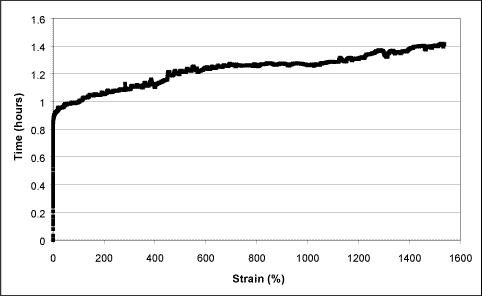

Fig.8. Elongation of constant load tensile specimen at 549MPa, due to low temperature creep over test duration
