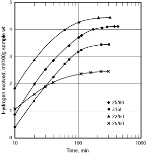

3.1.1 Hydrogen Evolution
The hydrogen evolution behaviour of deposit 25/80 at different VHE temperatures is shown in
Fig.1. The rate of hydrogen extraction was dependent on the temperature, with higher temperatures accelerating extraction. For instance at 950°C, extraction was almost complete after about 100 minutes, whereas over 50 hours were required for complete removal at 400°C. The temperature of extraction did not significantly affect the final level of hydrogen evolved over the range studied.
Fig.1 Hydrogen evolved against time for a range of temperature (deposit 25/80)
Comparison of the evolution behaviour at 700°C for different deposits and base materials is given in Fig.2. The austenite content of each deposit is shown in Table 5. Deposit 25/80 appeared to take slightly longer to reach a plateau than the other deposits, consistent with the high austenite content (81%, Table 5) reducing the hydrogen diffusion rate. Evolution was substantially complete for all deposits after about 3 1 / 2 hours.
Fig.2 Evolution behaviour of different deposits at 700°C

Results of the analyses on a range of deposits are given in Table 6. It will be noted that the different sample types displayed a range of hydrogen content, from about 5-20ml/100g deposited metal, with good repeatability in all cases.
