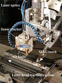

An integrated hybrid welding system was assembled, consisting of a Trumpf 4kW Nd:YAG laser, a Servo Robot Smart-20 laser vision and joint tracking system, a Kawasaki articulated arm robot and a Lincoln MIG/MAG welding machine.
The laser used was an HL 4006D flashlamp-pumped continuous wave Nd:YAG laser, manufactured by HAAS-LASER GmbH. The laser beam, 1.064µm in wavelength, was delivered via a step-index optical fibre, 600µm in diameter, to an output housing, utilising a 200mm focusing lens to produce a nominal minimum spot size of 0.6mm.
The MIG/MAG torch of the Lincoln PowerWave 450 was attached to the laser output housing, to give an arc travel angle of 30° and a 16mm contact tip to workpiece distance. The output housing and the MIG/MAG torch were mounted onto a Kawasaki JS30 robot, traversing the arrangement over a stationary jig holding the specimens in position during welding. The arrangement can be seen in Fig.2.
Fig.2. Equipment set-up for hybrid Nd:YAG laser-MAG welding with adaptive control

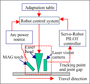

In the integrated system, the sensing and joint tracking device, a 3D laser vision system, mounted with a look ahead distance of 50mm from the centre of the welding laser beam focus, detected both the joint position and the geometry of the gap. The Servo-Robot laser-vision system consists of a Smart-20 laser camera head and a PILOT-LW camera controller and operates using the optical triangulation principle, as illustrated in Fig.3.
Fig.3. Schematic of the operation of the Servo-Robot device

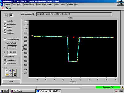

The Smart-20 camera projects a plane of visible light from a 690nm, 10mW laser onto the joint, transverse to the joint line. The reflected laser radiation is imaged onto a photodiode array to provide a joint profile. Signal processing of the image profile is carried out in the PILOT-LW camera controller. The image is divided into segments, with break points defined at features, e.g. inflections in the image, as shown in Fig.4.
Fig.4. Typical joint profile from a square edge butt joint with a fixed gap, measured using the Servo-Robot vision system
For a square edge butt joint, the joint gap is defined as the distance between the two break points across the joint line. The tracking point is at the mid-point of the joint gap. Joint gap and tracking point information is sent to the robot controller with a time stamp which is used by the robot controller to delay the joint gap tracking to account for the look ahead distance of the camera. The tracking point information was used to correct the programmed path during welding, as well as maintaining a constant stand-off distance between the welding head and the workpiece. The joint gap data, on the other hand, was used as source data for adaptive process control using software developed by Kawasaki for the JS30 robot.

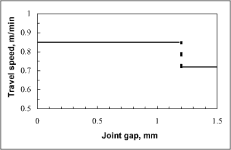

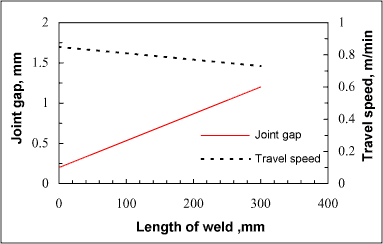

The first attempt at adaptive control involved a discrete change in the travel speed depending on the range within which the instantaneous measured gap value lay ( Fig.5a). For the range of gaps engineered into the plates used for the adaptive control trials, a control algorithm was developed based on gap width information from the seam tracker. The control software automatically selected one of the pre-established sets of welding parameters (i.e. the travel speed) and applied this to the part of the weld being made, dependant on the gap width seen. This same set of parameters was applied until the seam tracker device measured a gap corresponding to a different parameter set, at which point (in this case) a further change in speed was made.

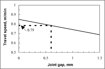

The second method of adaptive control involved a continuous change of travel speed, as the weld progressed, i.e. with automatic travel speed interpolation between the discrete parameter sets. The travel speed was continuously adjusted based on each instantaneous measurement of joint gap ( Fig.5b).
A schematic drawing showing the principle of the adaptive welding process described above is shown in Fig.6, and the three types of joint preparation used to evaluate the capabilities of the two adaptive control possibilities described above, can be seen in Fig.1.

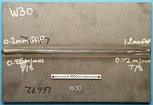

A sample with a constant joint gap of 1.2mm was also welded, for which (only) the travel speed was reduced, to produce an acceptable weld profile and quality at this gap. It was found that fully penetrating welds of a stringent weld quality could be made at a speed of 0.72m/min at the1.2mm gap, compared with 0.85m/min for zero gap samples. Figure 7 shows the appearance of a weld made on a sample where the joint gap varied from 0.2mm at the start of the weld to1.2mm at the end of the weld, at a constant travel speed of 0.85m/min.

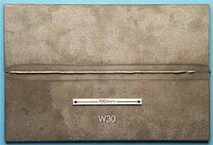

Fig.7. Appearance of the weld top bead profile produced using welding conditions developed for a zero gap butt joint, but for a sample with a joint gap as depicted in Fig.8a, i.e. increasing linearly from 0.2mm at the weld start to 1.2mm at the weld end
Although it was possible to produce a fully penetrating, square edge butt joint without the weld pool falling through, even at the larger joint gap of 1.2mm, the stringent weld quality could not be maintained over the entire sample length. The geometrical features of the weld profile produced at different positions along the weld, were different. For joint gaps smaller than 0.6mm, transfer of filler material via the arc caused a build-up of metal on top of the weld, leaving the weld with an excess weld metal profile. As the joint gap gradually increased, the amount of excess weld metal was reduced until the excess weld metal became zero, after which the weld top bead exhibited an in completely filled groove. The transition to an incompletely filled groove occurred when the joint gap was around 0.6mm-0.8mm, above which the weld quality fell below that defined as stringent in BS EN ISO 13919-1.

Based on the travel speeds obtained earlier for the zero gap butt joints and the butt joints with a constant 1.2mm gap, an adaptive control algorithm was developed for the Kawasaki control software. For the stepped adaptive control, the following relationships were used:
  • IF 0<joint gap<1.2mm THEN travel speed = 0.85m/min.
  • IF 1.2mm ≤ joint gap THEN travel speed = 0.72m/min.
For the continuous adaptive control, the actual travel speed corresponding to a given joint gap was automatically calculated by linear interpolation between the two travel speeds given in the above relationships. For example, the travel speed for a joint gap of 0.6mm, was 0.79m/min, as shown graphically in Fig.5b.

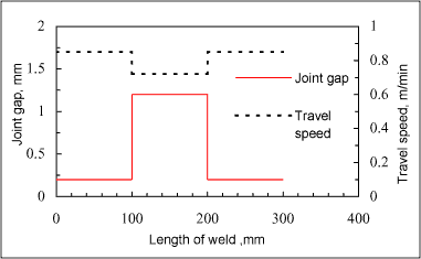

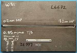

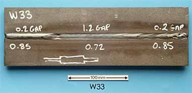

To test the stepped adaptive control algorithm, a square edge butt sample was machined to provide gaps of 0.2mm, 1.2mm and 0.2mm, as depicted in Fig.1b. The welding parameters developed for the zero gap and the 1.2mm joint gap samples were used as a basis for welding this sample.
Fig.8. The typical weld appearance of a weld produced with stepped changes in travel speed on butt joints with stepped changes in joint gap (see Fig.1b for joint configuration):
8a) Adaptive control parameters
8b) Weld top bead appearance
During welding, travel speed was changed by use of adaptive control. A speed of 0.85m/min was automatically selected for joint gaps measured to be less than 1.2mm and a speed of 0.72m/min was automatically selected for joint gaps measured to be equal to or larger than 1.2mm. For this particular joint configuration, two speed changes i.e. from 0.85m/min to 0.72m/min and from 0.72m/min to 0.85m/min, were made over the length of the weld, as can be seen in Fig.8a. The top bead appearance of the weld produced is shown in Fig.8b. Although it was possible to accommodate the discontinuous joint gaps using this control mode without losing penetration or without the weld falling though, poor weld profiles were observed in the transition region, a scan be seen in Fig.8b, because the hybrid process did not react quickly enough to the stepped change in welding speed initiated by the control system.
Continuous Adaptive Control for Hybrid Welding

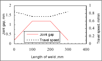

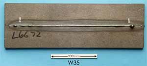

Figures 9a and 9b show the appearance, top and underbead respectively, of a weld produced with continuous adaptive control of travel speed, for a sample with a linearly variable joint gap, increasing from 0.2mm at the start of the weld, to1.2mm at the end of the weld.
During welding, the travel speed was decreased uniformly over the 300mm weld length, from 0.85m/min to 0.72m/min, corresponding to the measured joint gap, as shown schematically in Fig.9c. The weld exhibited full penetration and a smooth top and underbead appearance, even at the largest joint gap. The gradual reduction in travel speed as the joint gap increased, increased the amount of filler deposited and as a result, the weld did not exhibit the sunken topbead profile as witnessed in a similar sample welded without adaptive control ( Fig.7).
Fig.9. Appearance of the weld produced using hybrid Nd:YAG laser-MAG welding with continuous adaptive control of welding travel speed to accommodate a continuously varying joint gap of 0.2mm at the start and 1.2mm at the end of a square-edge butt weld in 8mm thickness C-Mn steel:

Fig.9c) Adaptive control parameters

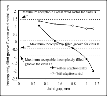

Figure 10 summarises the performance of the continuous adaptive control method with regard to weld quality, in terms of incompletely filled groove and excess weld metal, demonstrating that when using continuous adaptive control of welding speed, stringent weld quality could be achieved, even at the largest joint gap investigated. Without adaptive control, this was not possible for joint gaps larger than 0.8mm. This illustrates the potential of adaptive control in a production environment, where close to zero-gap butt joints, as usually required for laser welding, are often not cost effective or practical to produce.
It is believed that even larger joint gaps than the 1.2mm tested here are weldable using additional adaptive control algorithms. It is also apparent that the application of adaptive control increases the process tolerance to joint gap, when compared to welding without adaptive control.

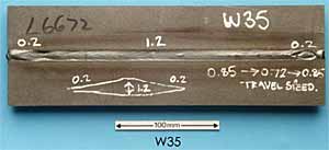

Figure 11 shows the top and underbead appearance of a weld produced on a sample where the joint gap increased initially, then remained constant for a while, before reducing again to zero at the end of the sample, as shown in Fig.1c. The weld was made using the continuous adaptive control method.
Fig.11. Appearance of the weld produced using hybrid Nd:YAG laser-MAG welding with real time continuous change in travel speed to accommodate continuously variable joint gaps on square-edge butt joints with 0.2-1.2mm and 1.2-0.2mm continuously variable joint gaps in 8mm thickness C-Mn steel:
Fig.11a) Top bead appearance;
Fig.11b) Underbead appearance;
Fig.11c) Adaptive control parameters
This sample was produced to demonstrate the effectiveness of continuous adaptive control to compensate for slowly changing joint gap conditions, as often experienced in a production environment, and to ascertain whether the control algorithm could also be applied to closing joint gaps (as it was developed based on trials on samples with opening joint gaps). For this weld, the travel speed was automatically decreased, from 0.85m/min to 0.72m/min, for the first part of the weld, kept constant at 0.72m/min in the central section and then automatically increased from 0.72m/min to 0.85m/min, at the end of the weld. The resulting fully penetrating weld showed a smooth top and underbead. This proved that the earlier developed continuous control algorithm could also be applied to closing gaps, maintaining a predetermined joint quality.
