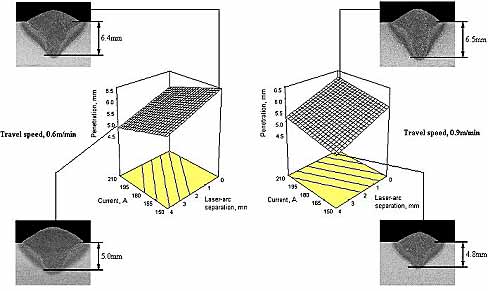

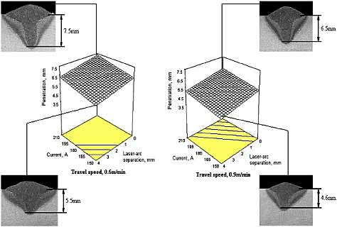

3.2 Weld Penetration
The influences of GMA current and arc-laser separation distance on depth of weld penetration at both travel speeds are shown in Figure 7 for the case of the GMA process leading and in Figure 8 for the laser process leading.
Fig. 7. Influence of welding parameters on weld penetration - GMA process leading
Fig. 8. Influence of welding parameters on weld penetration - Laser process leading
In general terms, an increase in the depth of penetration was associated with
  • an increase in GMA current
  • a decrease in welding speed
  • zero arc-laser separation.
The results were in line with expectation and can be explained simply in terms of greater energy density giving rise to greater penetration. At a travel speed of 0.6m/min, the maximum penetration obtained was 7.5mm; at 0.9m/min the maximum penetration obtained was 6.5mm.
The results obtained at a travel speed of 0.6 m/min with the GMA process leading did not follow the above trends and the maximum penetration was associated with the minimum GMA current and zero arc-laser separation. These conditions reduced the effectiveness of the hybrid process and, as a large molten pool resulted, it is possible that molten pool interference with the laser keyhole may be responsible. It may, therefore, be necessary to restrict the molten pool size in order to maximise the benefits of hybrid welding. For commercial reasons, welding at a travel speed of 0.9 m/min is much more attractive than 0.6 m/min and further work will be carried out at the higher welding speeds.
In the present work, the influence of which process was leading was less significant than the other variables. When the laser is leading the GMA torch is 'pushing' and when welding with the GMA process above, 'pushing' normally results in reduced penetration. It is clear that further work is required to understand the detailed interactions in the weld process zone.

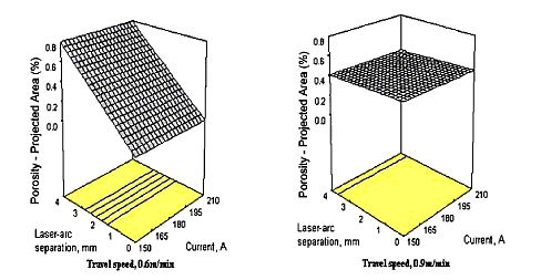

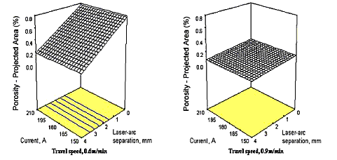

3.3 Joint Quality
All welds were radio graphed and no cracks or planar flaws were detected. There was, however, a degree of porosity and the results are summarised in Figure 9 for the GMA process leading and in Figure 10 for the laser process leading.
Fig. 9. Porosity level as a function of welding parameters - GMA process leading
Fig. 10. Porosity level as a function of welding
In general, porosity levels were low and satisfied the requirements of BS EN 4515: 2000. The maximum level of porosity found was approximately 0.8% in terms of projected area, which occurred at the slower welding speed of 0.6 m/min.At the higher speed, 0.9 m/min, porosity levels were below 0.4% projected area.

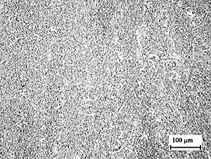

3.4 Weld Metal Microstructure
A typical weld metal microstructure is shown in Figure 11. The microstructure is predominantly acicular ferrite. No significant differences in microstructure were observed between the upper and lower sections of theweld.
Fig. 11. Hybrid weld metal microstructure, 0.6m/min travel speed, 5.2kW laser power, 210A GMA current
