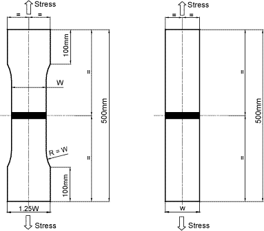

  • Fatigue endurance. Stress ranges were chosen to give fatigue lives in the range 105 - 2x106 cycles. 'Dog bone' shaped samples were used for the butt joints, and parallel sided samples for the T joints, as shown in Fig.2. Stresses were applied perpendicular to the welding direction in both cases, in the plane of the welded plates (thus load carrying welds) for the butt joints, and of the baseplate (non-load carrying weld) for the T joint.
Fig.2. Details of fatigue testpiece dimensions, for butt weld (left) and T butt weld (right), showing direction of stresses applied

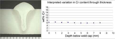

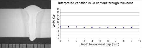

Inefficient mixing of the filler wire addition in the hybrid weld pool is also a concern in hybrid welding. For example, in certain welds inefficient mixing may be one cause of through thickness variations in weld metal microstructure, with adverse effects on weld toughness. [1] Similarly, in welds made with a deliberately dissimilar wire addition, poor mixing would lead to a variation in weld metal composition through thickness, with potential metallurgical consequences. [2] Poor mixing may also act to restrict the gap bridging capability of a given welding condition in the root of the weld, by restricting supply of additional molten metal from the filler wire addition. Given these concerns, as an experimental test case, the degree of mixing of the MAG wire in the hybrid weld pool in welds made using the Nd:YAG laser was determined in two specific cases:
  • a partial penetration melt run made on 8mm thickness S275 plate using a dissimilar 308L stainless steel wire, and
  • a full penetration butt weld made using 8mm thickness S275 plates with a 0.5mm root gap, using the same wire.
The weld metal chemical homogeneity through thickness was determined by analysing variations in estimated elemental concentrations of a deliberately added tracer element (Cr, from the 308L stainless steel wire MAG wire addition),using an energy dispersive X-ray (EDX) probe.

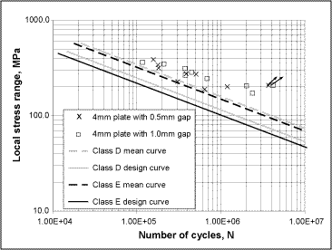

Fig.8. Fatigue test results for the hybrid CO2 -MAG butt welds in 4mm thickness DH36 plate, for fit up gaps of both 0.5mm and 1mm, plotted against the local stress range calculated after corrections for specimen misalignment and bending distortion

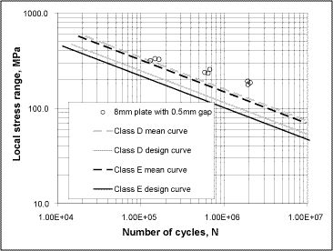

Fig.9. Fatigue test results for the hybrid CO2 -MAG butt welds in 8mm thickness DH36 plate, for a fit up gap of 0.5mm, plotted against the local stress range calculated after corrections for specimen misalignment and bending distortion

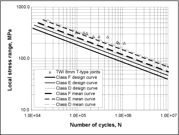

Fig.10. Fatigue test results for the hybrid CO2 -MAG T butt welds between a 6mm thickness vertical stiffener and an 8mm thickness baseplate, with zero fit up gap, plotted against the local stress range calculated after corrections for specimen misalignment and bending distortion
As Fig.8 shows, the hybrid welded simple butt joints in 4mm thickness plate are equivalent to, or better than, class D arc welds. As Fig.9 shows, the hybrid welded simple butt joints in 8mm plate are of similar fatigue endurance class at low stress ranges. A slight deterioration in performance was observed at higher stress ranges, yielding consequently shorter fatigue lives. As Fig.10 shows, the hybrid welded T joints are equivalent to, or better than, class F arc welds. In fact, these T butt welds approach class E performance. There is again a slight deterioration in performance at high stress range.
All fracture faces were examined, to determine the fatigue failure initiation site. Butt welds made in 4mm plate with a 0.5mm gap predominantly failed from the toes of the weld cap. Butt welds made in 4mm plate with a 1mm gap failed either from the toes of the weld cap or weld root, in approximately equal numbers. Butt welds in 8mm plate with a 0.5mm gap again failed predominantly from the toes of the weld cap. T butt welds failed exclusively from the toes of the weld root. This last result was in line with the steeper toe blend angles on the weld root side compared to the weld cap, as shown in Fig.7.

To address the concerns previously referred to regarding weld metal chemical homogeneity, selected Nd:YAG-MAG hybrid welds were made using a dissimilar wire combination. Fig.11 and Fig.12 show cross-sections of a partial penetration melt run and a full penetration butt weld respectively, and the corresponding variations through thickness in Cr. In these experiments Cr effectively served as a tracer element, as it was only present in the 308L wire, and was absent in any significant quantity from the S275 plate. As Fig.11 and Fig.12 show, no significant through thickness variations in the weld metal composition were detected. This suggests that full mixing of the filler addition was taking place during hybrid welding.
Fig.11. Transverse cross-section of an Nd:YAG laser-MAG hybrid melt run on plate in 8mm thickness S275 (scale in millimetres), made using 308L stainless steel wire, and variation in ZAF corrected estimations of Cr content in wt%, at various positions through the thickness of the weld metal. These measurements are repeatable with a relative error of ±4%
Fig.12. Transverse cross-section of an Nd:YAG laser-MAG hybrid butt weld in 8mm thickness S275 (scale in millimetres), made using 308L stainless steel wire, and variation in ZAF corrected estimations of Cr content in wt%, at various positions through the thickness of the weld metal. These measurements are repeatable with a relative error of ±4%
