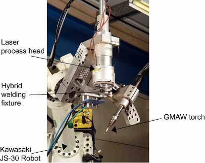

A Lincoln Electric Powerwave 455 MAG power source was used. A synergic pulsed welding programme appropriate for 1mm diameter wire and Ar-CO 2 shielding gas mixtures was selected for the welding trials.
A purpose built fixture was used to hold both the laser focusing head and MAG torch ( Fig.1). The fixture permitted accurate and repeatable control of the relative position and orientation of the two heat sources. Figure 1 shows the laser output head and MAG torch attached to the hybrid fixture, with the laser co-axial gas shield and MAG shroud removed.
The hybrid fixture was mounted on a Kawasaki Heavy Industries JS-30 arc-welding robot. The robot controller was linked to both the laser and MAG equipment, allowing independent control of the start/stop for each process during the production of test welds. Welds were made by traversing the output housing across a stationary workpiece.
Fig.1. Hybrid laser-arc welding equipment

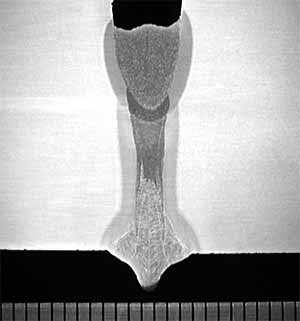

Extensive preliminary procedure development was carried out prior to the trials reported here. [1,5] Initially a factorial style approach was adopted to determine the effect of certain parameters on weld quality. Following this a provisional procedure was devised that was then applied in position. Figure 2 shows a weld carried out using this procedure. The procedure development carried out in the trials reported here follows on directly from this preliminary work.
Fig.2. Macrograph of weld showing an acceptable weld with 11mm full penetration

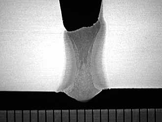

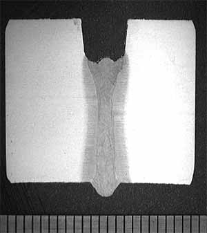

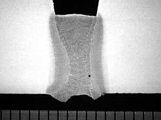

Fully penetrating welds were made in the flat (1G), vertical up (3G) and overhead (4G) positions (Fig.3-5). Radiographic examination of these welds showed no solidification defects in the vertical up (3G) and overhead (4G) positions. In the flat (1G) position however, there were some surface breaking centreline defects.
Fig.3. A macrograph of a weld carried out on X60 in the flat (1G) position
Fig.4. A macrograph of a weld carried out on X60 in the vertical up (3G) position
Fig.5. A macrograph of a weld carried out on X60 in the overhead (4G) position

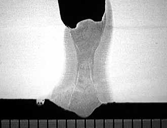

3.2 X80 5G Vertical Up Welds
Figure 6 is a macrograph of a cross-section of a weld carried out on X80 in the flat (1G) position. The root, hybrid filler and GMA filler passes can be clearly identified. Initially the welding speeds used for the X60 were used on the X80 linepipe but full penetration was not achieved from 7.30 to 10.30 so the speed was reduced.
Fig.6. A macrograph of a section of weld in X80 taken from the 12 o'clock position. A subsequent GMA pass has been deposited on top of the hybrid laser/GMA weld
Table 3 presents the Charpy energy and the hardness test results for the welds made in X80. The results exceed the requirements of BS4515-1:2000 with a minimum recorded Charpy energy of 90J, from full-size Charpy impact specimens notched on the fusion line. The heat affected zone hardness was within the requirements of BS4515-1:2000 with a maximum of 302HV10. The weld metal hardness however, failed to meet the requirements of BS4515-1:2000 with a maximum recorded value of 297HV10. Similar to the welds in X60, the standard was satisfied concerning porosity with all welds containing less than 0.3%. The weld metal hardness however, failed to meet the requirements of BS4515-1:2000 with a maximum recorded value of 297HV10. Similar to the welds in X60, the standard was satisfied concerning porosity with all welds containing less than 0.3%.
