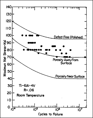

Porosity
To date, only one titanium riser has been commissioned, but it is likely that the procedures adopted for the Heidrun riser will, in the short term at least, be used for any future projects. In situations where the weld reinforcement is left intact, fatigue cracking can be reliably predicted to initiate from the weld toe. In all likelihood, however, all geometry-specific stress-raisers, such as weld toes, will be removed from titanium riser systems in order to maximise the fatigue performance of the joints. Under these circumstances fatigue strength can be lowered significantly by the presence of weld porosity, especially that near the surface. The influence of pores in titanium welds has been known for some time. Lindh and Peshak (1969)
[11] gave S-N curves for machined flush TIG welds in Ti-6Al-4V, showing expected performance according to the presence of porosity and its location. These curves are reproduced in
Fig 1. The lower curve shows the influence of pores closer than two pore diameters to the surface, whilst the middle curve demonstrates the dramatically improved performance that can be gained by eliminating near surface defects. In the absence of other weld defects and geometry-specific stress-raisers, cracking always initiated from weld pores when present, regardless of pore size. Even pores as small as 50µm diameter were found to have initiated cracking, although their effect on performance was less marked than for larger defects. The conclusions of Lindh and Peshak
[11] still apply today. Unduly restrictive maximum specified pore sizes in welding codes may not have any profound effect on fatigue performance. Indeed, the removal of such defects and subsequent weld repair may be more detrimental to fatigue performance than the original defect. Near-surface pores, however, should be eliminated and ultimately the performance of a machined-flush titanium weld may depend on the availability of NDE methods which can detect very small pores closer than two pore diameters to the surface. Until such methods have been proven, it seems unlikely that design codes can be moved above the lower curve shown in
Fig 1, for welds produced using processes known to be susceptible to porosity.
Fig.1. Lindh and Peshak's (1969) [11] fatigue life curves for grade 5 titanium TIG welds containing pores. Some data is shown on the figure for small pores (50-150µm diameter), mostly away from the surface
Porosity in titanium fusion welds can be formed for a variety of reasons, but the most insidious is undoubtedly the profound influence of the condition of the joint surfaces. A more detailed description of weld metal porosity and its prevention in titanium fabrications is given elsewhere (Smith and Gittos, 1998a) [14] , but the evolution, coalescence and entrapment of hydrogen bubbles during solidification is the most likely cause. The joint surfaces should be scrupulously clean prior to welding since even a fingerprint can lead to porosity, but even this precaution is insufficient. The rutile (TiO2 ) scale that imparts such considerable corrosion resistance is hygroscopic and adsorbs moisture from the environment. The hydrated layer provides a further source of hydrogen and steps should be taken to minimise its presence. This includes using procedures that reduce surface roughness and the hydration state (i.e. x in TiO2 . xH 2O) prior to welding. In principle, machining without aqueous lubricants and welding in the same 24h period is advised, although acid pickling may be used successfully on 'old' joint surfaces.
One interesting facet of porosity in titanium weld metal is its seeming dependence on the presence of a prior joint surface. Autogenous melt runs on the surface of titanium plates are notoriously difficult to produce with porosity, seemingly independent of the presence of grease, oil and other contaminants. Likely reasons for this are discussed elsewhere (Smith and Gittos, 1998a) [14] , but it is tempting to speculate that this behaviour could be exploited to good effect in eliminating near-surface pores in fusion welds. Much development work is necessary, but, potentially, many of the concerns regarding porosity could be countered simply by applying autogenous TIG dressing passes over the completed weld surface.

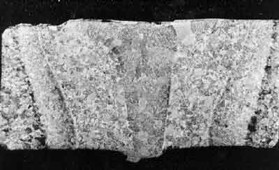

TIG welding
The TIG welding process is an established technology for joining titanium and is the process with which most fabricators are familiar. The choice of TIG welding for risers and flowlines will no doubt be influenced by these factors, but the process does suffer several disadvantages for these applications. For pipe joining, in sizes appropriate in these applications (12-25 mm), the process is slow and many passes must be made to fill the joint. Furthermore, grains develop in the solidifying weld metal by epitaxial growth, giving a coarse grained structure with a grain size roughly proportional to the number of passes (
Fig 2). The coarse grains can increase the difficulty in detecting small defects using ultrasonic inspection techniques and so are generally undesirable. Despite a coarse grain size, mechanical properties compare favourably with those of the base material (
Table 2), in part due to the finer transformation products that develop in the weld metal. Porosity is a persistent problem in TIG welds which, together with the need for many weld passes, may necessitate a greater proportion of weld repairs to be performed than for the other processes discussed here.

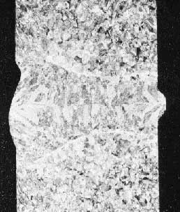

Fig.2. A multipass TIG weld in 14mm thick Grade 23 titanium pipe
Table 2. Typical tensile properties for an as-welded multipass TIG weld in 14mm thick grade 23 titanium pipe
| Zone | 0.2% Proof Stress (MPa) | Tensile Strength (MPa) | Elongation (%) | Location of Failure | Maximum Hardness (Location) (HV10) |
| Cross-weld |
915 |
Parent |
325 (weld metal) |
| Weld metal |
760 |
910 |
15 |
325 |
| Parent |
850 |
915 |
14 |
310 |

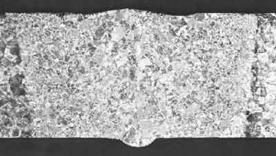

Fig.3. A MIG weld in 14mm thick grade 23 titanium pipe (two MIG fill passes, one TIG root pass)
Table 3. Typical tensile properties for an as-welded multipass MIG weld in 14mm thick grade 23 titanium pipe
| Cross-weld |
915 |
Parent |
320 (weld metal) |
| Weld metal |
720 |
860 |
9 |
320 |
| Parent |
850 |
915 |
14 |
310 |

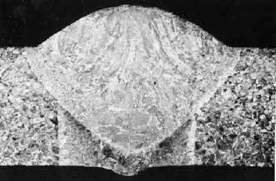

Fig.4. A single pass keyhole plasma weld in 14mm thick grade 23 titanium pipe
Fig.5. The stop position of a single pass keyhole plasma weld in 14mm thick grade 23 titanium pipe
Although thickness up to 16mm have been welded successfully in the horizontal (2G) position, difficulties in the control of large weld pools may significantly reduce the maximum thickness that can be welded in 5G welds. Even so, predevelopment trials have demonstrated that 5G keyhole plasma welds are possible in titanium pipe (Schley, 1998) [17] . Microstructure and mechanical properties ( Table 4) are very similar to those of TIG welds, although those of multipass TIG welds tend to offer superior ductility.

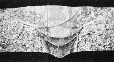

Fig.6. A reduced pressure electron beam weld in 14mm thick grade 23 titanium pipe (weld made in the horizontal (2G) position)
Equipment for laying steel pipes using RPEB is under development, but satisfactory RPEB welds have been made in titanium pipe in material up to 16mm thick (Smith and Gittos, 1998c) [16] ; Fig.6, Table 5.

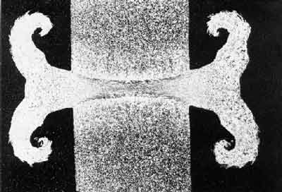

Fig.8. A continuous drive rotary friction weld in 14mm thick grade 24 titanium pipe
Table 7. Typical tensile properties for a continuous drive rotary friction weld in 14mm thick grade 24 titanium pipe
| Zone | Maximum hardness (Location) (HV10) | 0.2% Proof Stress (MPa) | Tensile Strength (MPa) | Elongation (%) | Location of Failure |
| Cross-weld |
350 (HAZ) 340 (weld zone) |
930 |
Parent |
| Parent |
320 |
800 |
930 |
15 |
Both rotary friction welding processes are robust and can tolerate quite large deviations from optimum welding parameters, producing high quality joints with superior reliability. The repeatability of the processes offers the potential of assessing weld quality by monitoring the welding conditions. Although long lengths of pipe will need to be rotated, pipe rotation speeds are not high and decrease with increasing diameter of pipe; e.g. 150mm-diameter pipe would require <250rev/min and <60rev/min would be necessary for 600mm diameter pipe.

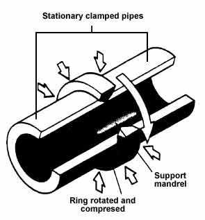

Radial Friction Welding
Radial friction welding overcomes the requirement to rotate long lengths of pipe by using a consumable ring and completing two welds simultaneously (one between the consumable and each pipe). Both pipes are held stationary and the consumable ring, which has a 'V' cross-section, is rotated and compressed radially ( Fig.9). Once the rotation achieves sufficient frictional heat across the interfaces, rotation is stopped and the compressive forces are increased to consolidate the joint. Collapse is prevented by an internal mandrel that supports both the consumable and the pipe. The feasibility of radial friction welding for the offshore sector has been demonstrated (Hutt, 1995) [10] . Weld properties established by Torster et al. (1998) [19] are summarised in Table 8, for comparison with the other processes.

Fig.9. Schematic diagram of the radial friction welding process
The main advantage of radial friction welding over a rotary friction welding process is the obviation of the need to rotate long lengths of pipe. Internal flash is also eliminated, although a small change in internal profile, where the pipes are compressed against the mandrel, will typically be present. Its disadvantages over rotary friction welding include the increased complexity, and therefore cost, of the welding machine and the added difficulties in monitoring and controlling weld quality, since two welds are produced rather than one. Even so, the process is fully mechanised and quality control will probably be easier than for fusion welding processes.
